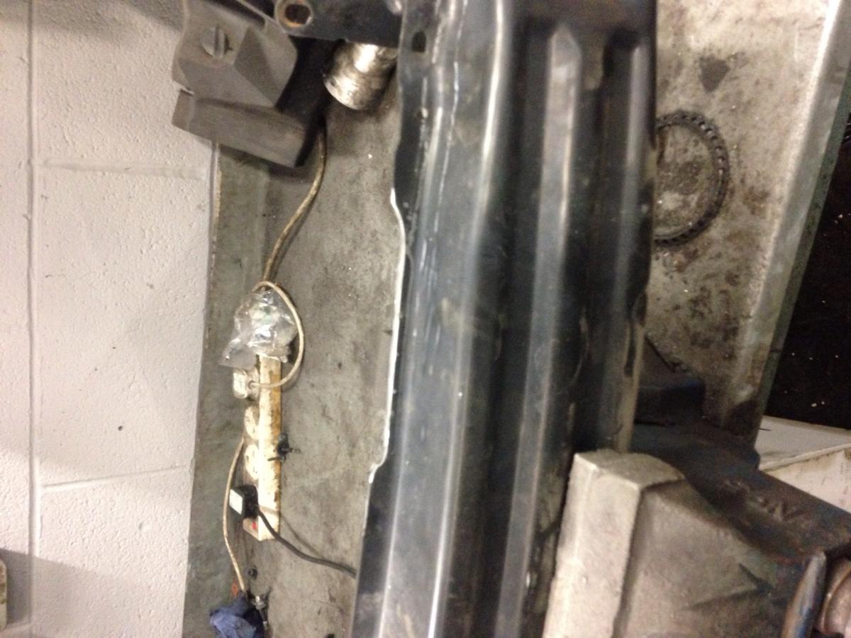

I see. I fitted the THS seat sport style inter cooler which is supposedly the thickest/deepest' one. All I had to cut off the crash bar was a slither, and I mean just a slither, from the top. I have a picture of how much was removed somewhere, but it was four/five inches long and perhaps an inch wide, or therefore bouts.

I hope these upload okay... I won't hold my breath.
I should also mention - the amount you will need to trim off the slam panel, bumper and crash bar will all depend on where the cooler sits, I imagine there is a slight range it could sit in, for example when I inspected the slam panel which was supplied with the cooler - the previous owner had cut away at some of the near side. Which once we had put everything into place was totally unnecessary as the cooler was nowhere near touching the offside, also the boost pipes entered and exited on the near side. The only reason I could fathom is perhaps when he had fit it, the cooler was positioned slightly differently. :/
It is a bit of a trial and error scenario, line it up, chalk what is fouling, cut it off, line it up, chalk what is fouling, etc etc.
