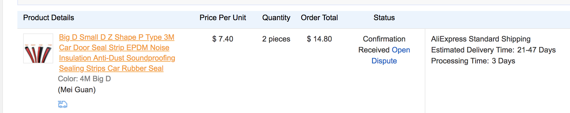

Azimov can you provide the link of the seal you bought? Is the seal a good improvement?
Hi @nickytheshaft,
I just remembered I bought from Aliexpress, but the delivery was fast. It took less than 7 days to arrive.
Link : https://www.aliexpress.com/snapshot/0.html?spm=a2g0s.9042647.6.2.5b5e4c4daKwHNp&orderId=91483425644053&productId=32809286381
Product Spec : 4M Big D *2
As I mentioned before, I can feel a comparatively better insulation between 100 to 130 km/h. After that, there is noise anyways.

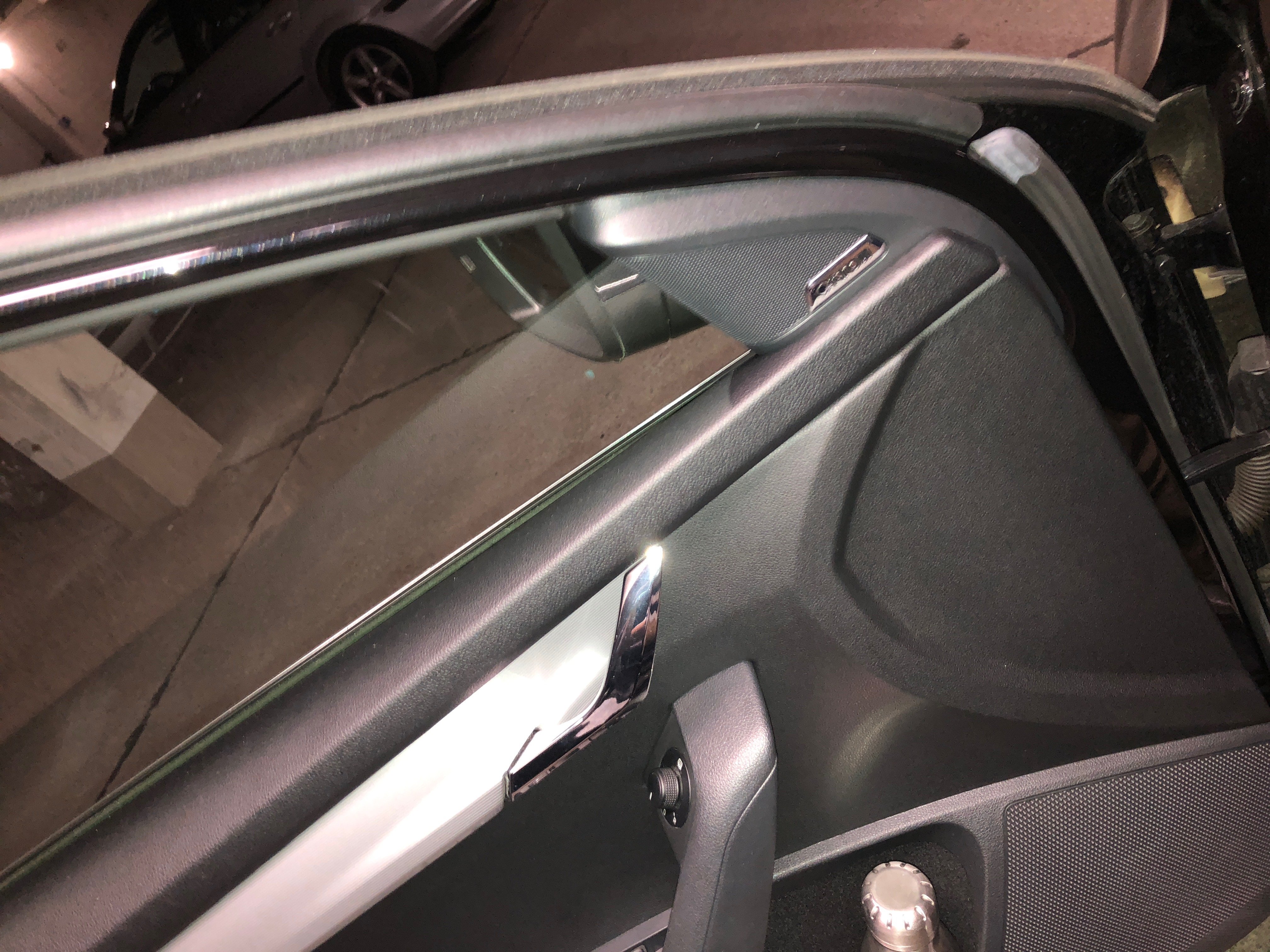

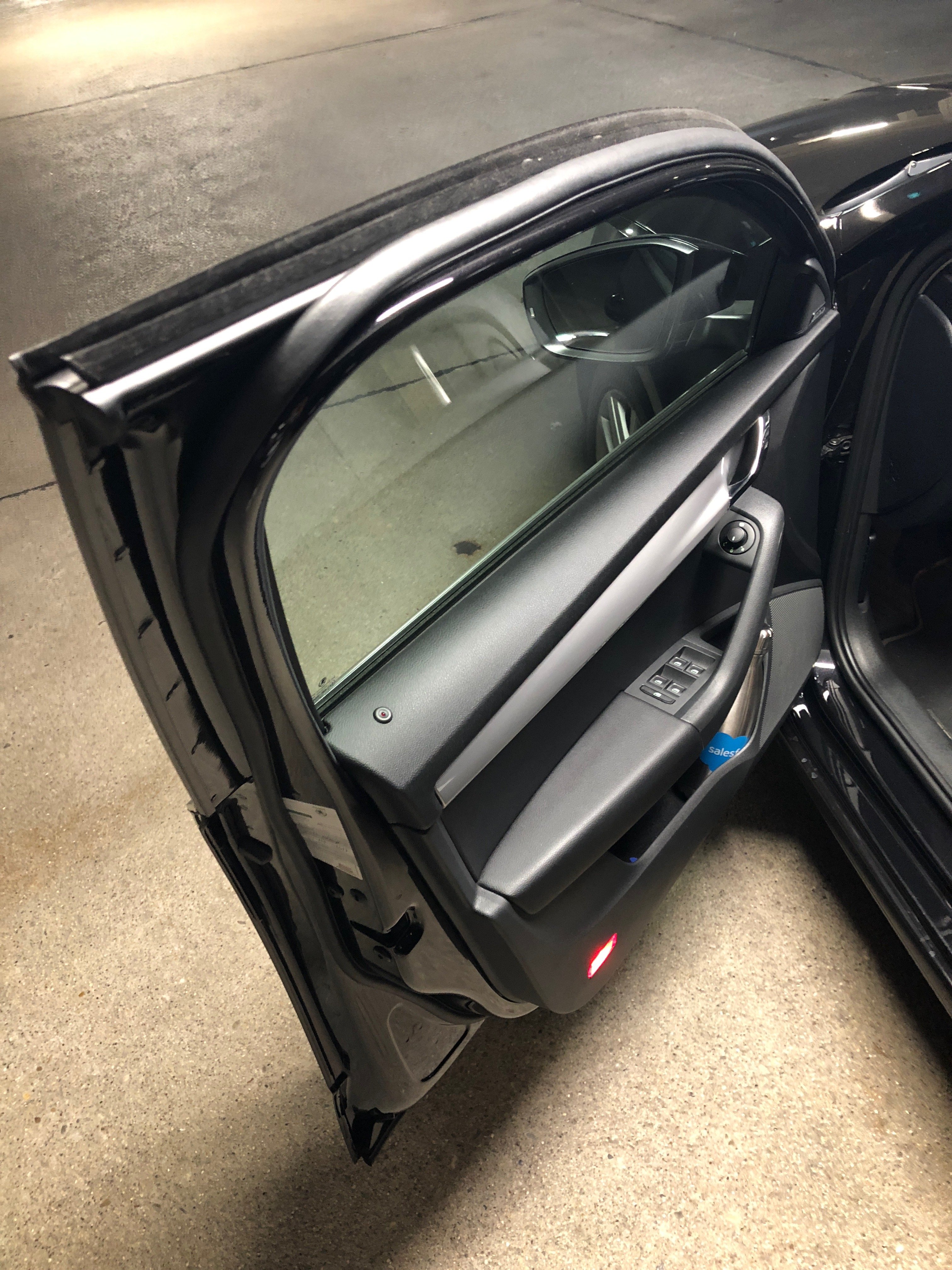

Hi @wellsy1,
On the doors. IMG-0491.thumb.JPG.9605aa1c3e00746683c83d3746b15e4f.JPGIMG-0490.thumb.JPG.3b0a1c907d3c723745a35c9c20cefd9f.JPGPlease find below in the pictures:
Many thanks. Great photos. I’ll have a attempt. Fingers crossed
Good luck (y)
