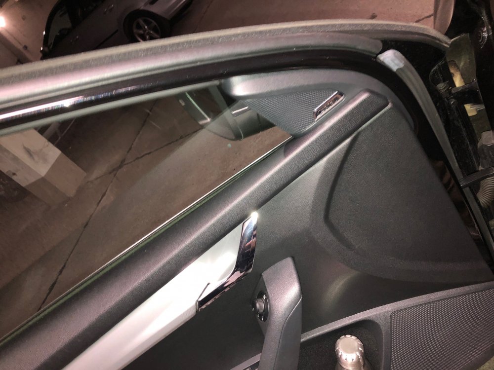

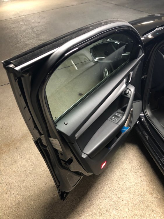

  • Coming to an Octavia after a BMW 3 series, I immediately noticed and pinpointed the source of the pronounced wind and external noise source. It is coming from the lack of secondary rubber seal around

Top part of the door would be very hard to fill the gap, how high the seal has to be, also these chinese seals with fake 3M adhesive looks like crap. I don't even want to order this.

The chasis is missing a third seal seating like on premium cars, so installing extra seal is useless if it doesn't close the gap.
