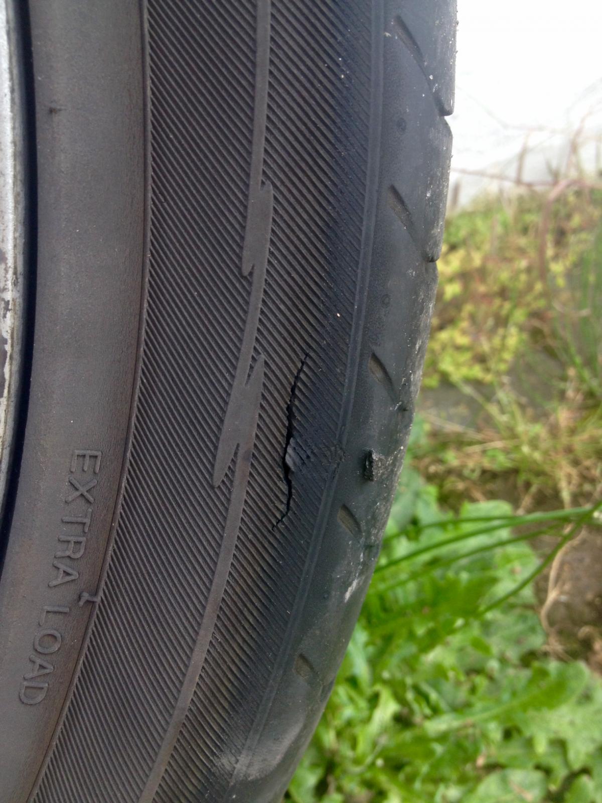

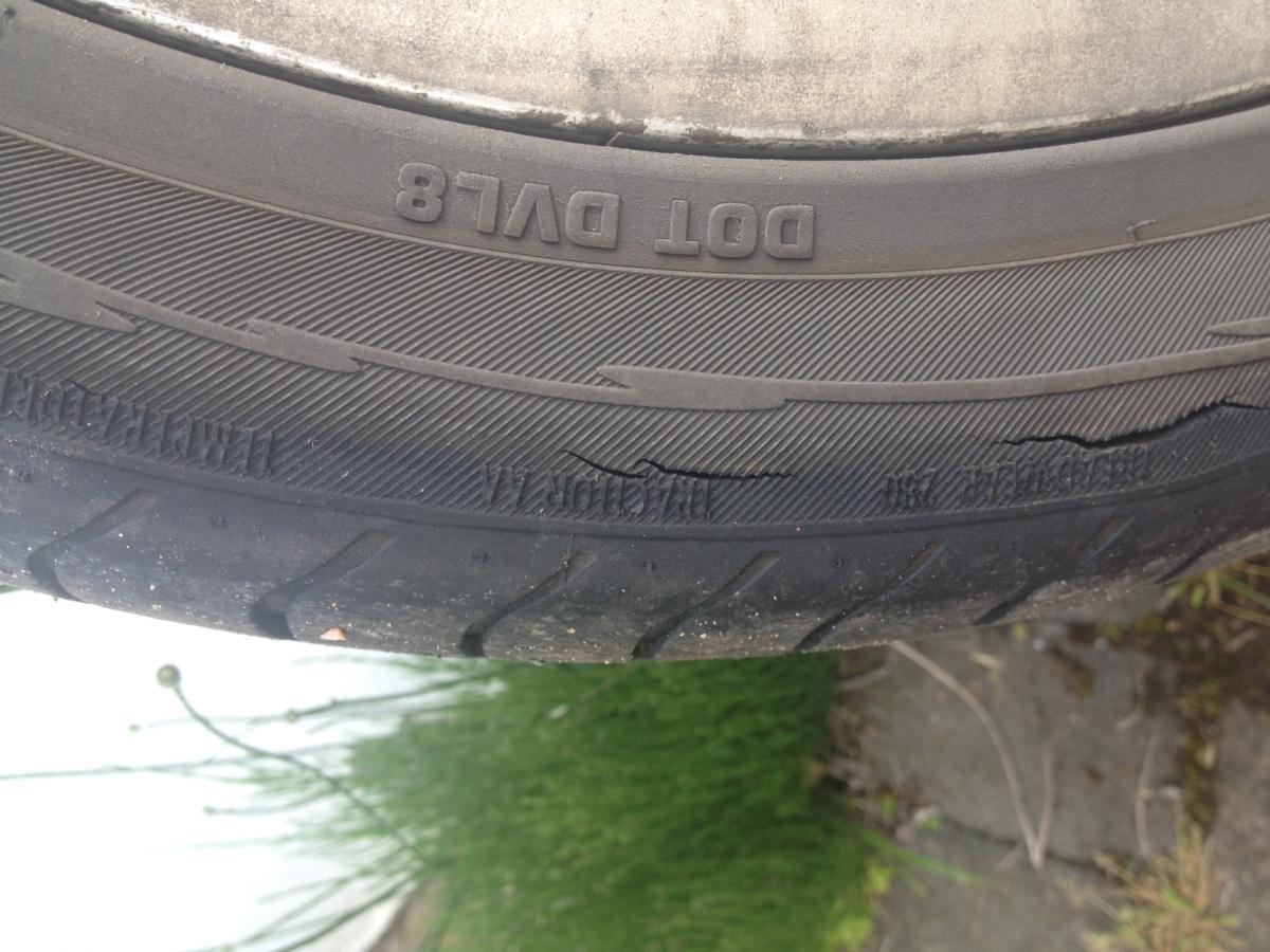

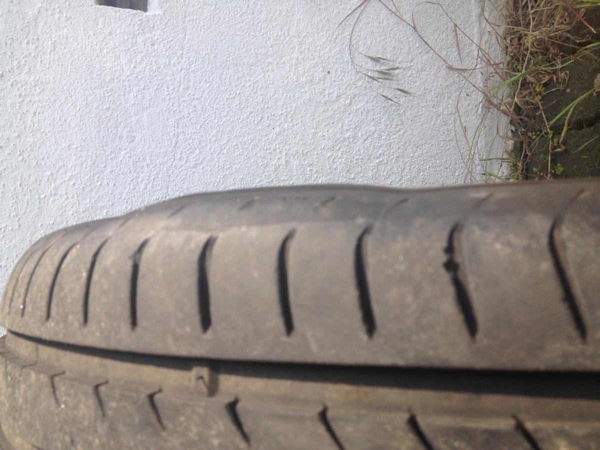

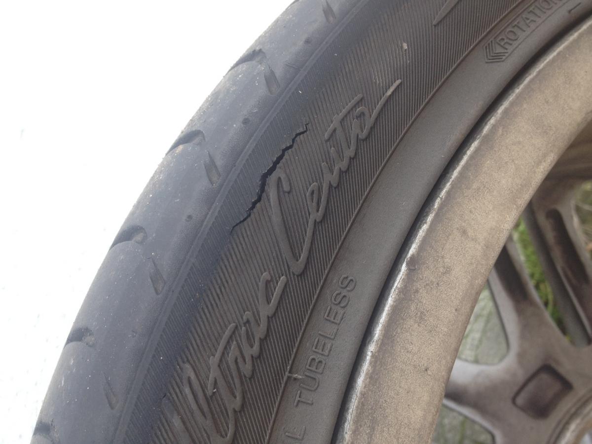

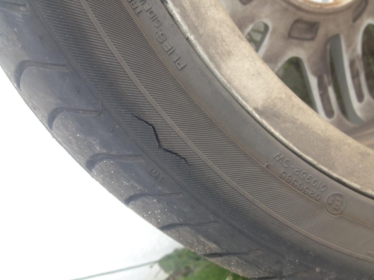

I found the culprit. I removed the OS front wheel and found this lot on the inside tyrewall...
The car is fitted with Vredestein Ultratrac Cento on all four corners.
The bulge expands with centrifugal force thereby hitting the road surface and causing the knocking. Unbelievable!
There are six cracks in total on the inside tyre wall. Now I don't know if these have been caused due to a run flat by the previous owner, because I have not had a problem with the tyres since purchasing the car, or if this is a manufacturing fault, but both fronts are getting changed tomorrow.

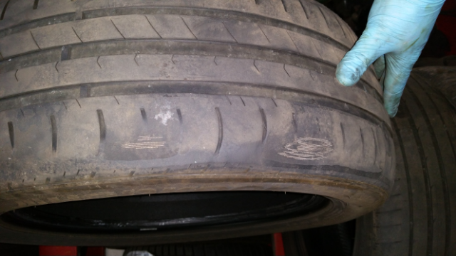

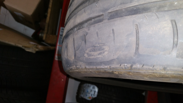

Look at the state of these rear tyres, they were making a right old racket. The rest of the tyres were legal , just this inside edge wear . something to look out for as hard to spot on rears
Edited by terrytowelling
Wow. They're a real mess!

Had the tyres changed at K&P Tyres in Ewell yesterday. Great service. Also found the NS front had a large bulge an very large 25mm crack on the inside wall. I've kept them and have started a warranty claim with Vresdestein.

Quite a few, Skip, but to be honest, I've never had any problems with these before. The sidewalls are so stiff on low profiles your have to be hitting them at high speeds again and again to cause a failure. Also, as I think I mentioned, there is zero sign of damage internally, which there would be with kirb damage, and low pressure would show externally. But I've never seen random cracking like this. It's most odd....
I have the same from Dunlop winter tyres just removed from my Merc  with still about 6mm on them inside wall all cracked at varoius places around tyre
