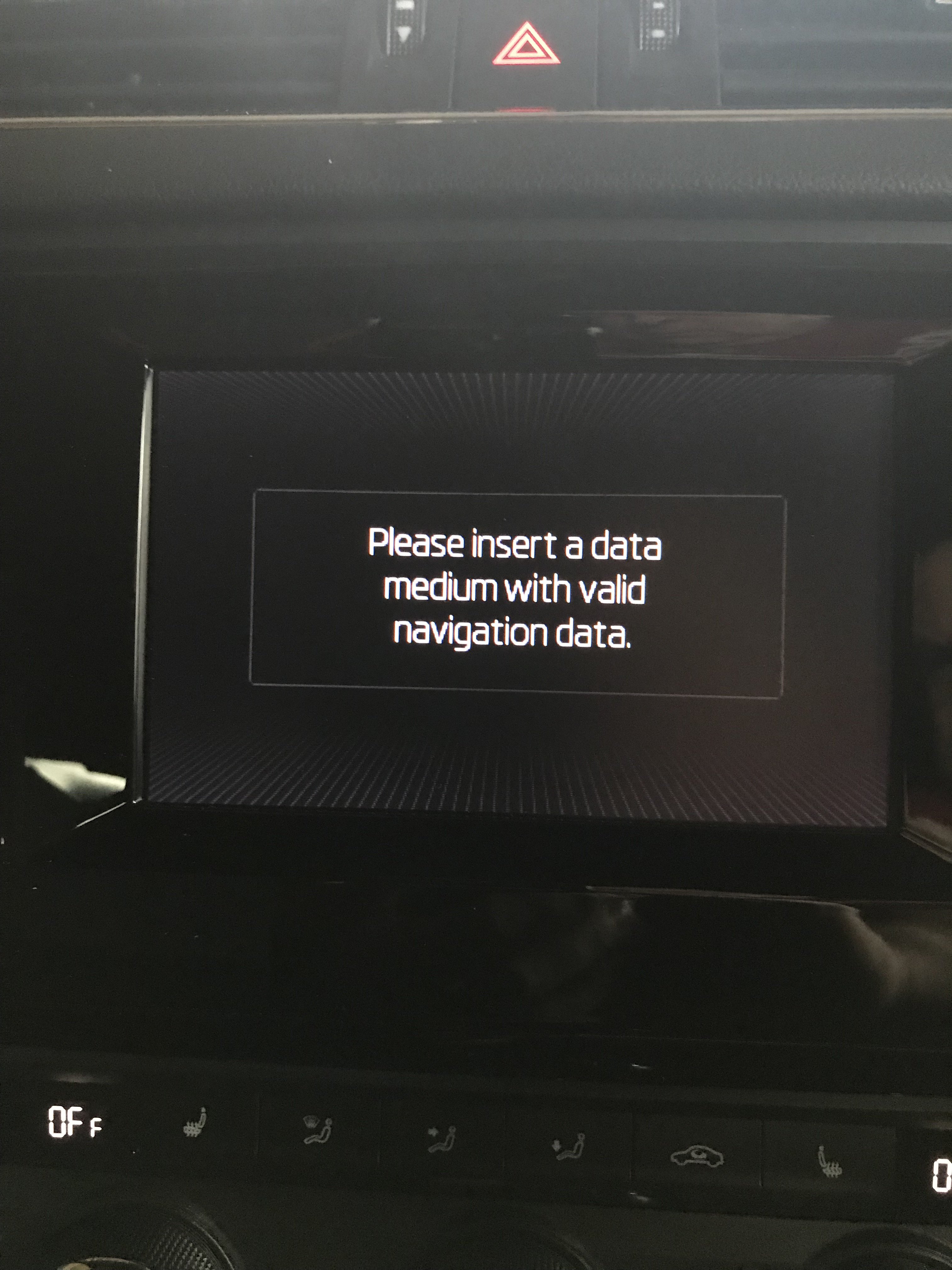

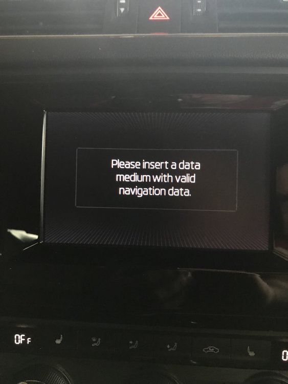

just keep getting this screen :wall:
When I reinsert the card into the car, do I need to do anything?
Stuck what to do now, other than putting the old maps back on :(

As you have an Amundsen it must be a genuine Skoda SD card.
You're using a Mac so that will put some extra unwanted files onto the SD card with filenames starting with (dot)(underscore) which do confuse the Amundsen and make it say the card doesn't have sat nav data on it - as you have seen. To solve that you'll have to find a Windows PC and delete the unwanted files added by OS X.

So cleaning it with blue harvest won’t delete the unnecessary files?
Blue Harvest *should* delete them all, but if you get the same error message again then checking with a Windows PC would seem a good idea.

Sorted.
