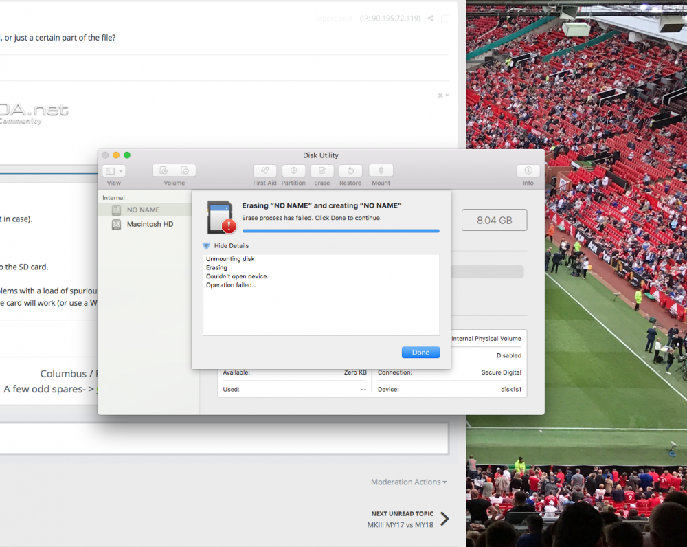

Wont even let me format card?
Have you unlocked the SD card with the small locking tab on the side?
