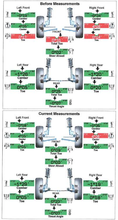

So new tires for the rears too and this time I wasn't going to throw good money away at crap garages so I took it to a local garage that did a full geo check. Below is the output from this test.
As you can see, my camber is still out and it's something they claim can't be fixed. Would this highlight a failing suspension part or is it nothing to worry about?

Most likely failing console bushes,very common on the fabia,most replace with cupra or poly bushes.
It's your caster that's out, not the camber. Check those bushes as pastie said.
  • Sponsor
The caster on the front right is only slightly out of spec too, 4°08' against a min. spec of 4°12', and the difference between the sides is within the 30' max difference spec so I think you have a dynamic toe problem that isn't showing up in these static measurements.. Like console bushes that aren't hanging onto the rear end of the wishbone properly as said above, and above that.  No idea why the rear tyres are doing what they're doing though.
