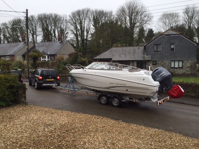

+1 for the Yeti as a rock solid tow vehicle. Our 170 Yeti 4x4 has a max tow weight of 2100kg and it tows our boat (2050kg on its trailer) with ease. Long hills (up or down) are not a problem even at a 100% provided you work the gear box and momentum sensibly. The gearing works well apart from 1st which could do with a lower ratio at this weight and a clutch that's more progressive - but then again our car's only 12 months old so we expect it to get better with more use.
Our Yeti's in this picture if you look closely!
Edited by PirateSyrett
^^^^The outboard motor looks to be bigger than the Yeti, never mind the huge boat! :)
Edited by Defenderben
The distance from the ball to trailer wheels look very towing friendly.
