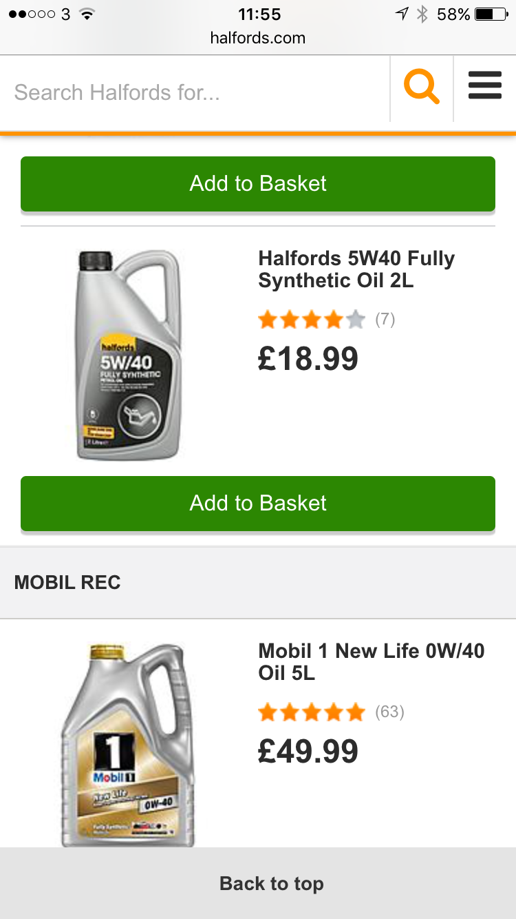

Halfords lists 5w40 - so I'm even more confused.

Screenshot from Halfords.
Confusing. All with Registrarion entered.
