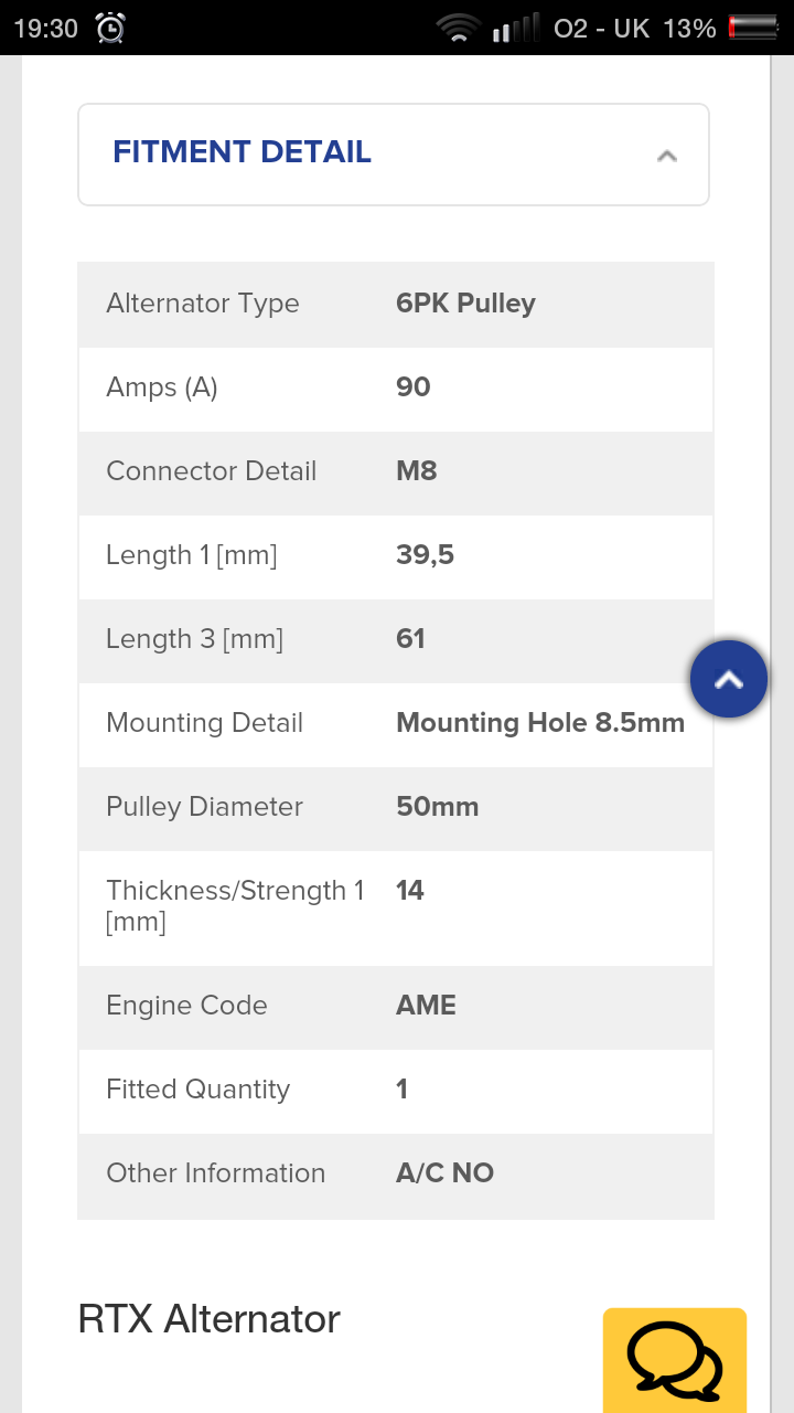

    The picture says AME with 6pk pulley, so yes aircon?
  • The parts search only says AME because that's the one he clicked on. All options are available for that reg. You have to select one for your spec.

That's cheaper than I can just had a look. Make sure you get the right one as there are four options. AME w/o A/C (5pk pulley), AME w A/C, (6pk pulley) AQW w/o A/C (5pk pulley) and AQW w A/C (6pk pulley).

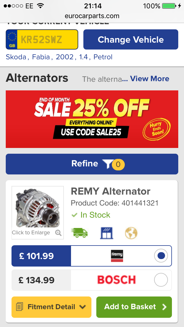

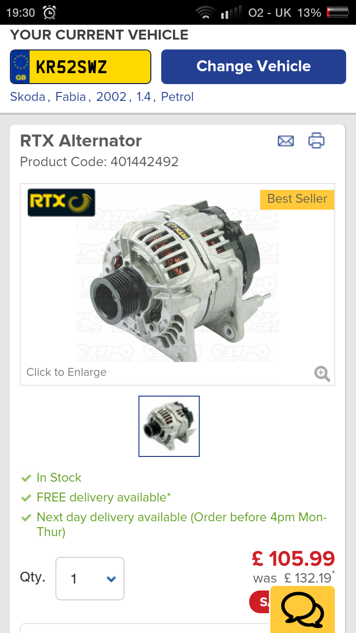

This is the one from ECP. After I enter my registration it comes up with this.
What's your engine code and does it have A/C?
Is yours an AME engine?
Just put your reg in and get the same four options. It flags up there are multiple options for your reg.
