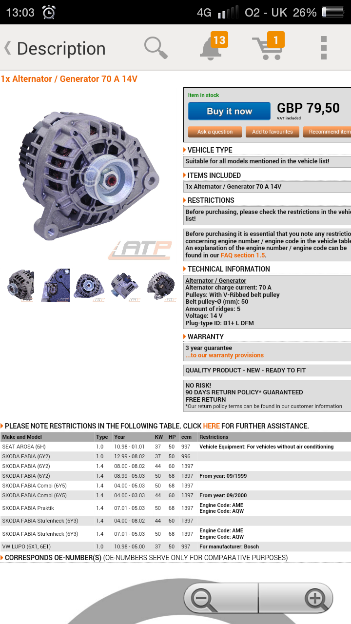

Never got round to doing anything on it the weekend as was fitting a kitchen for a friend. Found this on ebay and was wondering if it is the right 1 as its half the price than ECP was wondering if the fabia combi(6y5) is the estate, I have messaged them but got a auto-reply saying they would respond in 1-2days. Although last night I did remove the old alternator from then car.
Edited by ty1986
Sorry didn't know I had not attached a image
Edited by ty1986
Yes 6Y5 is the estate. That alternator is the right one.
