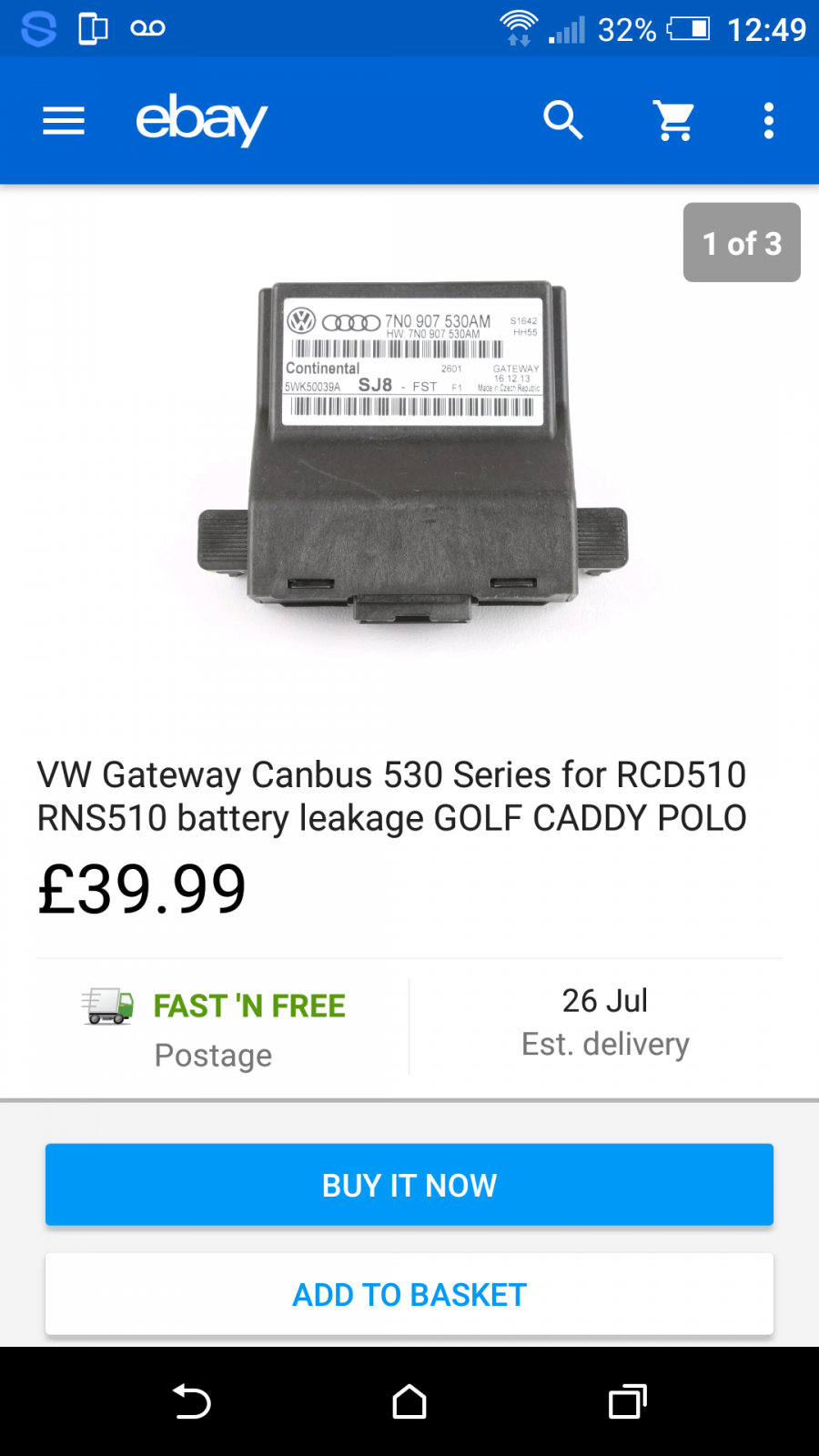

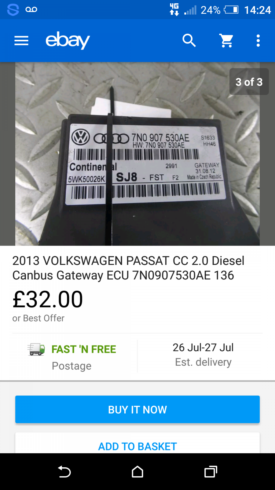

Will I need this model:
Adamal said he can code it for me, fortunately he's just 10 mins up the M4. This one should be OK also then?
Will any Can bus gateway work no matter what the letters end in if it begins with 7N0???
Probably, but you will need the numbers to match as in *** 907 530 *, the last * being revision L or above. Once the revision hit the end of the alphabet, it started on AA, AB etc.
7NO just means not specific to an Octavia, but is the same as a 1K0 prefix which is specific fot Golf 5 chassis.
My original 54 plate had a 1K0 907 530 E and this needed changing for Columbus to avoid the battery drain. I fitted a 1K0 907 530 AD without any issues at all. 7N0 is a later model still, the AM version in your photos being a later model than AE.
But in answer to your question, yes, either one from your photos will do. Interesting to see how prices have come down in the last few years -- I paid £75 for mine! - uncoded!
