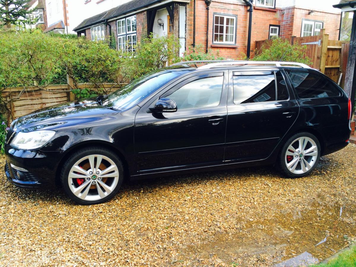

As per previous post 23, this would be about a 40mm drop from my 5yo vRS, presumably running on original springs and dampers - it certainly doesn't look like there is anything new around the struts in my car.  Just wondering if all the Eibach Pros are the same height and if they're identical in the B12 kit....  Also, wanting to get the story straight for insurance notification and questions...I'll try and photo mine as is and update this post.   I reckon mine looks higher than the b4 photos of skinnyman.
This is my estate standard. Pretty high guard lip height 680-685mm all round.
