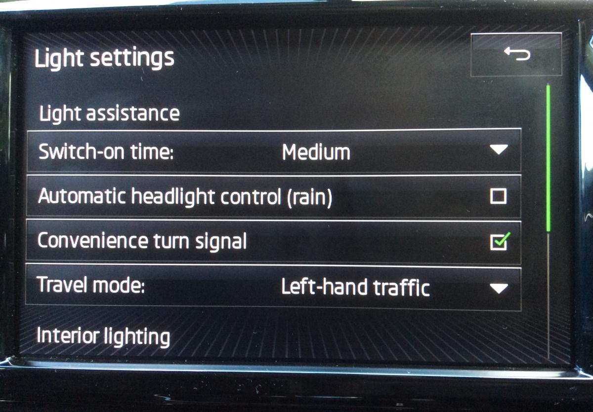

Had my new SEL Executive for less than a week so forgive me if this is a dumb question, but I do not seem able to activate the Light Assist function which should be included on this model.
Attached is a screenshot of the settings page and there is no activate/deactivate tick box against Light Assist.
I made sure I wasn't in Eco mode and checked all the other pre-requisites in the manual, but cannot get the "auto" light on.
Any thoughts gratefully received.
Correctly formatted photo, sorry.
That's because "Light assistance" is a heading to group the following options, just like "Interior lighting" if you scroll down.
You obviously have Bi-Xenon lights as you have the Drive on the right/left option.
It does look as if you don't have either Light Assist nor Dynamic Light Assist (as described by dstev2000 above) as this would appear as the first switchable option under the Light assistance heading.

Right, thanks guys. I thought I should have the light assistance package where I could switch on the automatic high beam /dipped beam option.
Appears not.

Some options require specific hardware to be present. In the case of the Light Assist you need the camera fitted, as this is what is used to detect the front and rear lights of other vehicles. That's why Gizmo was asking if you had the camera fitted.

This is not included. It is a cost option (£250 last time I checked) for both the SE and SE-L models.
Don't get it confused with AFS (Adaptive Front-light System), which is standard with all Bi-Xenon equipped models. AFS adapts the headlamp beams according to your speed and steering. Small motors adjust the bulb position to give the best beam pattern for the circumstances.
It also allows the dipped beam to be altered from driving on the left to driving on the right, as shown in the menu in your screen photo. It is actually excess to requirement as the beam will switch automatically when you drive on the continent.
AFS does not auto-switch between dipped and main beams.
On the assumption that you didn't specify and pay for the Light Assist option, you will be highly unlikely to get it enabled by the dealer.
The dealer uses a VAG analyser that is linked to the main Skoda server where all the details of your car are stored. It simply won't allow items like Light Assist to be enabled if you didn't pay for it in the first place.
All is not lost. Use Gizmo's VCDS Owners Map signature or use this link to find a VCDS owner in your vicinity, then send them a PM to ask if they can enable Light Assist for you (instructions on how-to are in this link).
