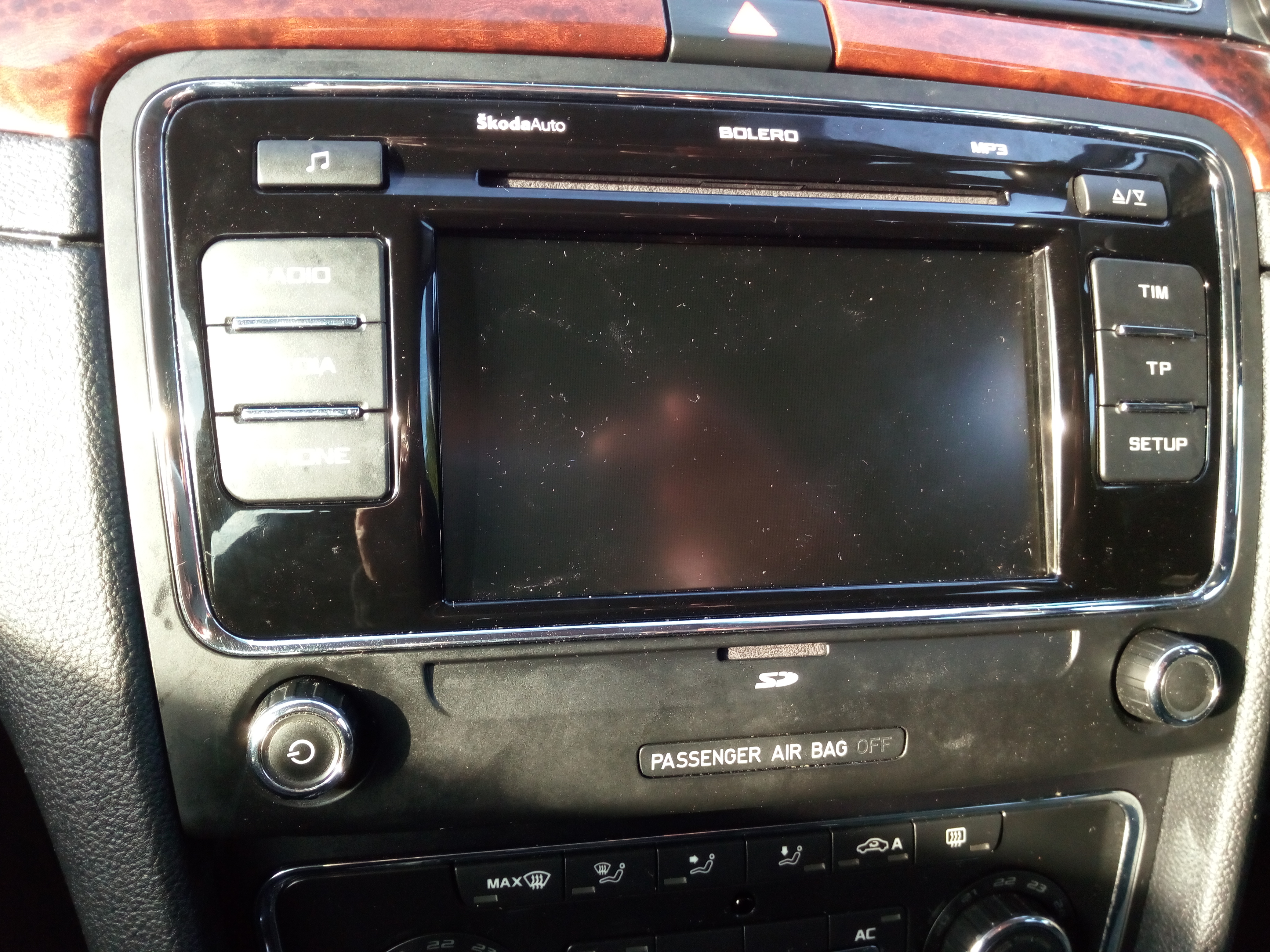

Hey, i have this radio right here:
Will one of the chinese aftermarket android headunits fit my dash? i Don't think so, but i might be wrong?

Hi, I have a Superb 2013 with a dead Bolero radio, any recomendations for a repair company?
Rustynuts from this site I believe is your man.
Sorry, I don't repair Bolero units. It's usually cheaper to buy a second hand one from Ebay to be honest.
