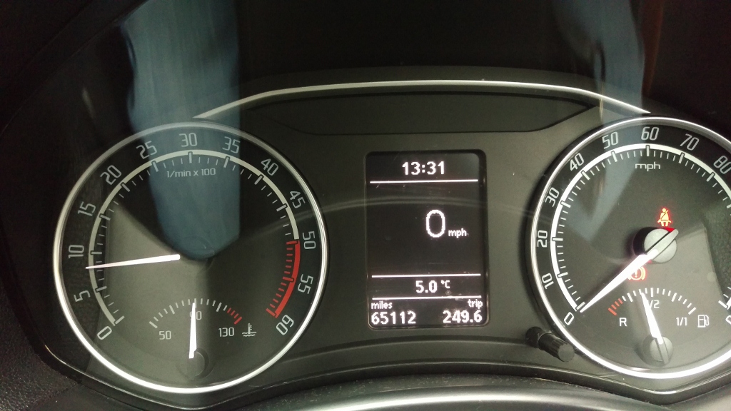

Took a little road trip today to Whitby to see Local VCDS guru Mike Holroyd.
Mike has activated the following adaptations for me.
Big MPH in Maxidot.
Cornering fog lights.
DRL's Dim when indicating.
Anti Hijack.
Twin rear fog lights.
Big Thanks to Mike for his help and extensive knowledge.

Great to met up earlier, and glad I was able to help you out.
Before some of our colleagues get excited about the twin rear fog lights on the FL Octy, it needs mentioning that this can't be done with VCDS, and needs VCP to sort out,
Mike
I have vcds but sadly not vcp :(
Mike
Thanks again Mike, really nice to meet you and your wife.
Ah good spot, forgot to mention you used VCP to turn on the rear fogs.
It seems like such a strange thing for Skoda to leave off! I won't break my neck to have them enabled as it doesn't really bother me.
I agree, no idea why Skoda set it up this way, surely it is easier to have both switched on than set up uk cars on the right and other countries on the left.
Mike pointed the option out to me when I went to see him about the other adaptions, it had not crossed my mind before to have them switched on, altough now I think it's kind of cool as most other fl Octavias don't have it.

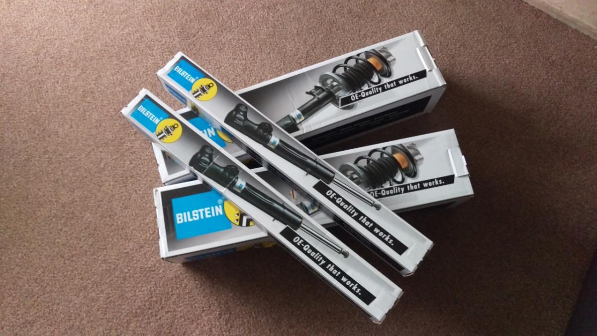

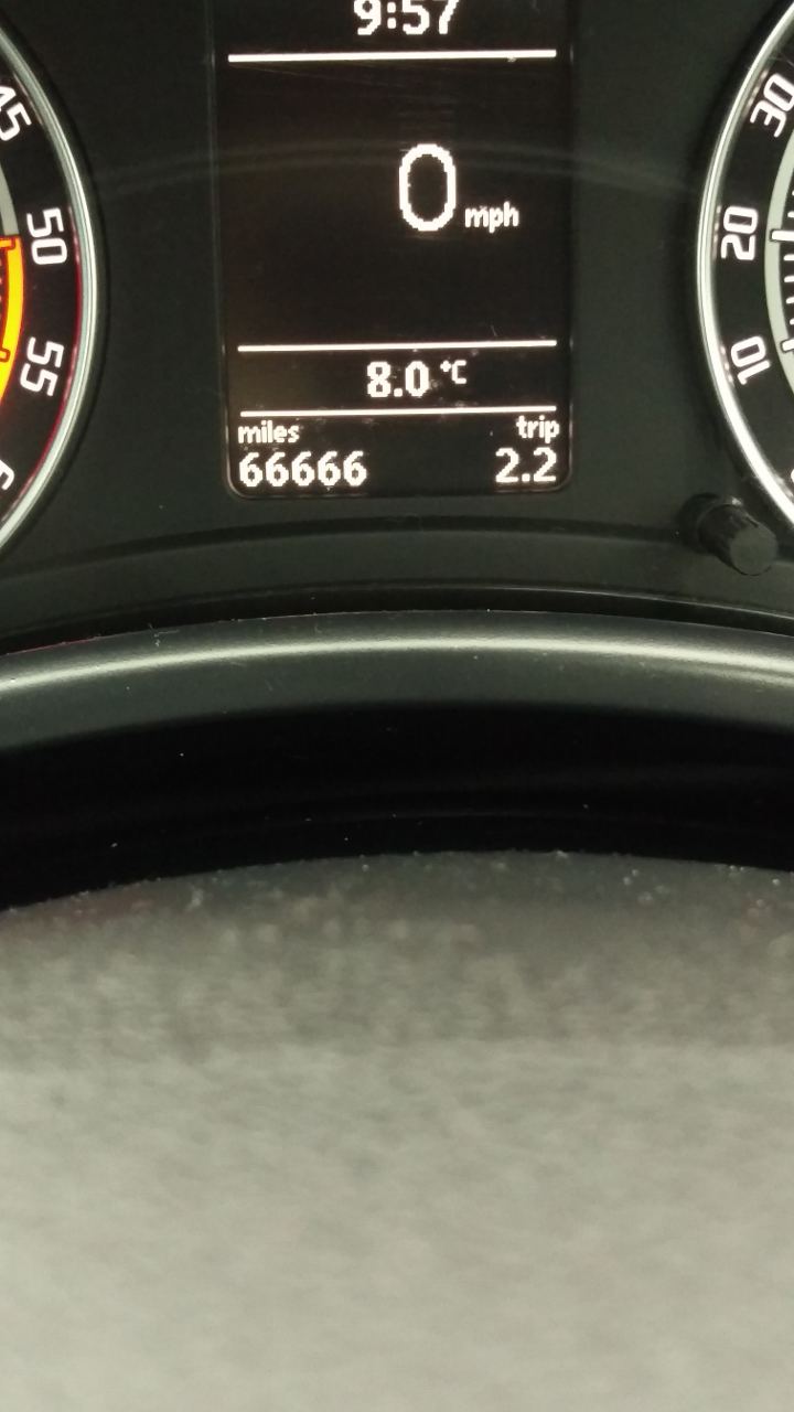

Couple of quick updates.
As I pulled onto my drive this morning I noticed that The VRS has reached the Mileage of the Beast LOL  :D  :D  :D

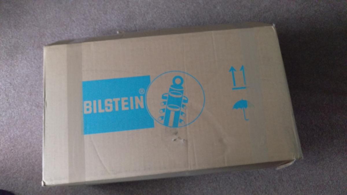

And these arrived yesterday  :clap:  :clap:  :clap:  :clap:  :clap:
Big thanks to Damian at DPM for the quick delivery.
Full set of Bilstein B4 Sport Dampers, Just awaiting a set of Eibach Pro springs to arrive and phase 2 of my mini project can start :D
