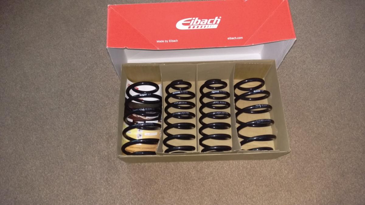

Springs arrived today, just need some time now to fit them along with the dampers.
I'll post some pics once fitted.

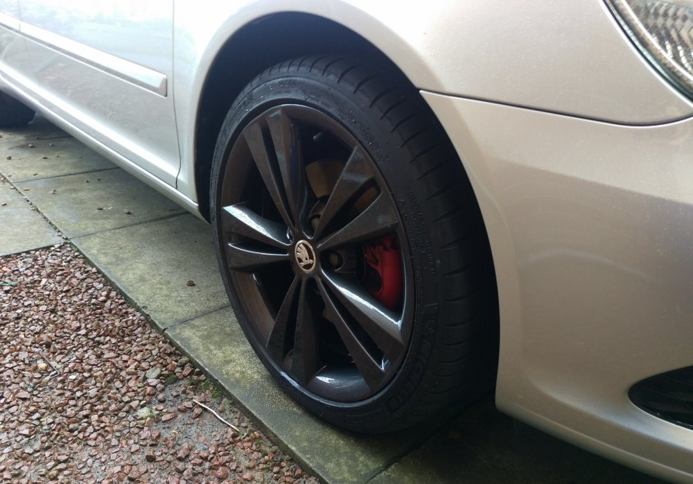

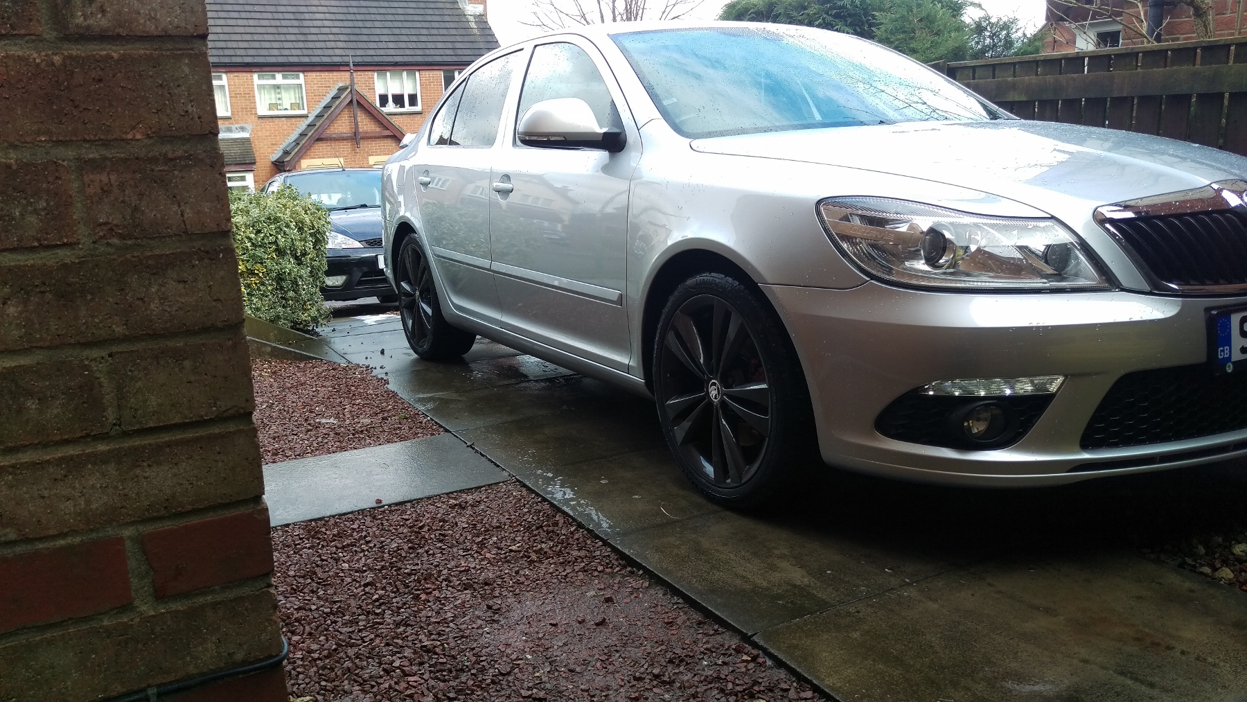

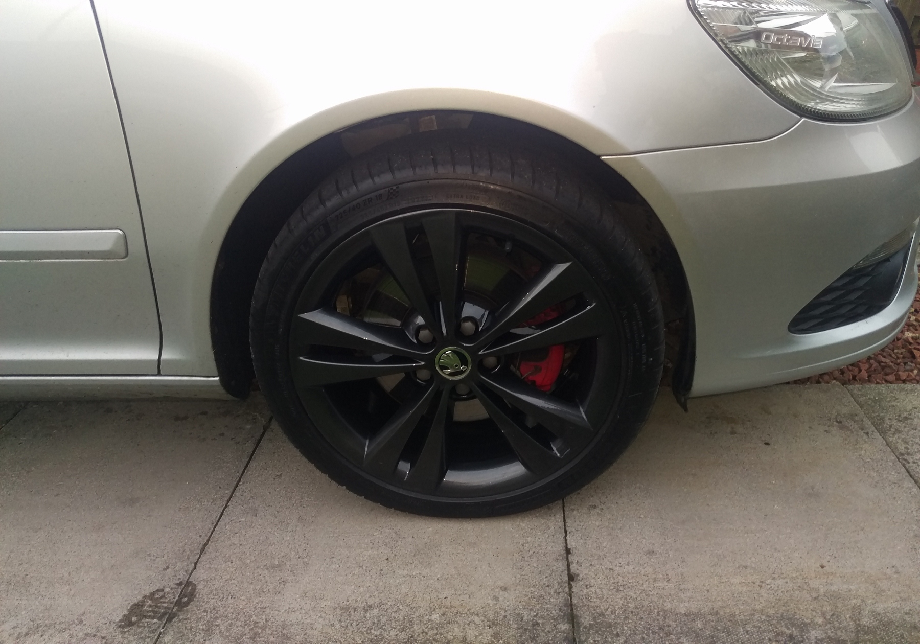

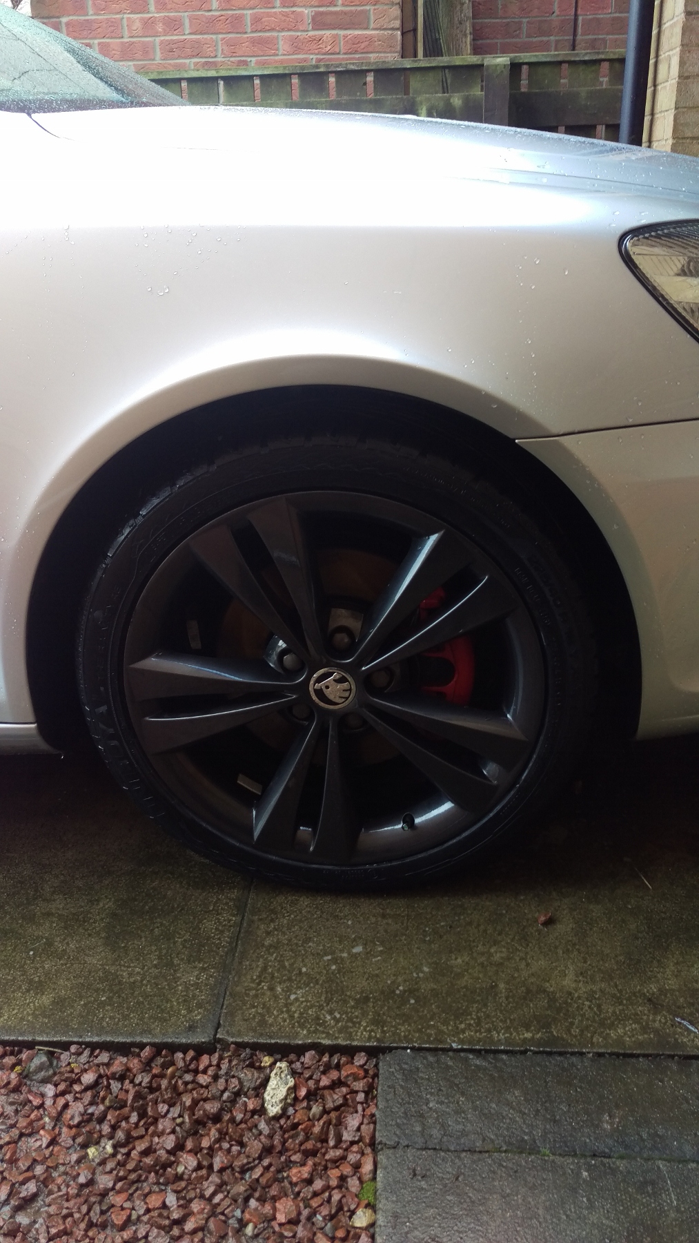

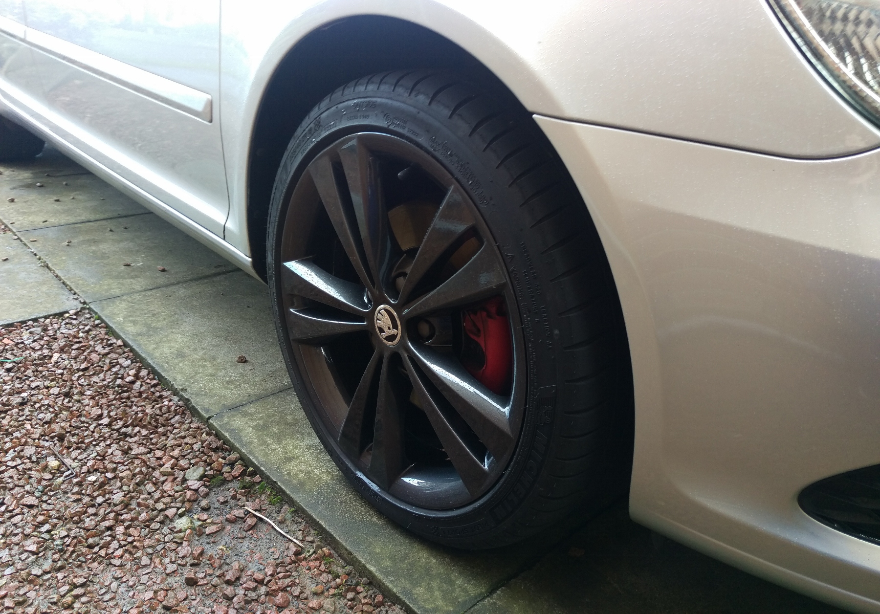

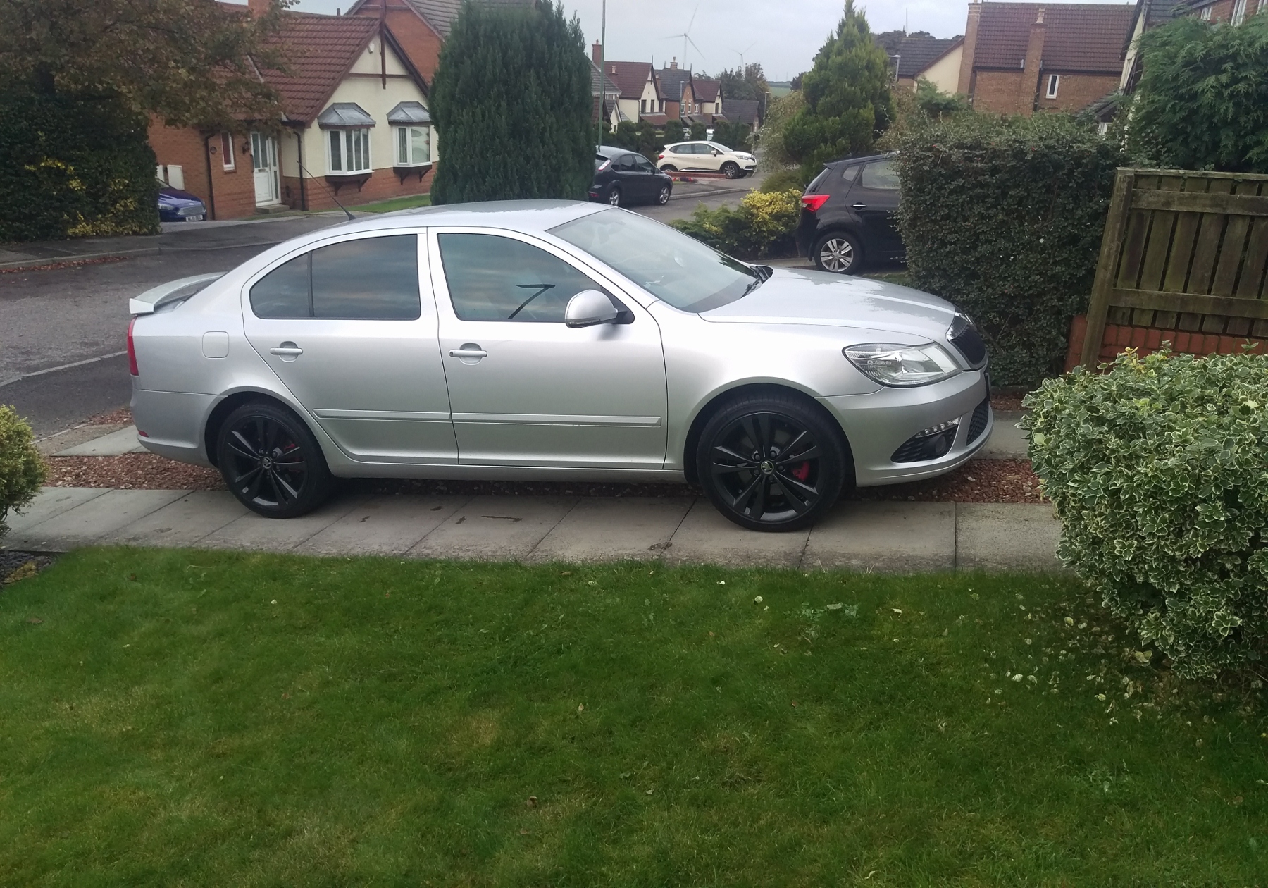

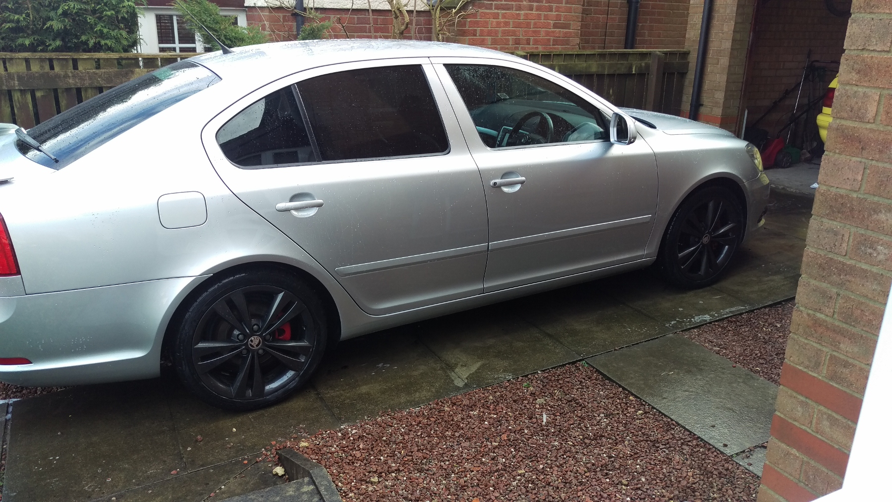

Some before and after suspension pics, I have tried to match up as close as possible to old pics although some of the angles are not quite the same I think difference in ride height can be seen.
As I mentioned earlier its not slammed but that was not what I was going for, more a subtle change in arch gap and OEM+ plus handling and ride.
Pics are arranged before followed by after.

4 hours ago, Vegasphil said:
How does it compare to the standard ride on the shocks? I suspect mine are on their way out as they are very crashy at the moment. This could well be the way I decide to take mine.
Definitely not crashy, the ride is firmer than standard but still comfortable, over speed humps I do notice that the suspension is stiffer than standard but over bumps in the road it is not noticeable.
My old front shocks were weeping and front and rear shocks and springs were original with 67000 under their belt so I am probably seeing a bigger difference to someone with brand new standard VRS shocks and springs.
I'm really happy with the overall feel and look, I researched a few different setups from coilovers to just springs before settling on this and the B4 Sport damper and Eibach pro springs have done exactly what I wanted.
I went for this type of setup for a few reasons, I'm 40 and can no longer put up with being bounced around like a budgies toy, the car is used rather than shown and long gone are my days of travelling 5 miles out of my way to avoid speed humps lol.
I have only had it back 24hrs and only done 2 short runs but I think as it settles in it will only get better.

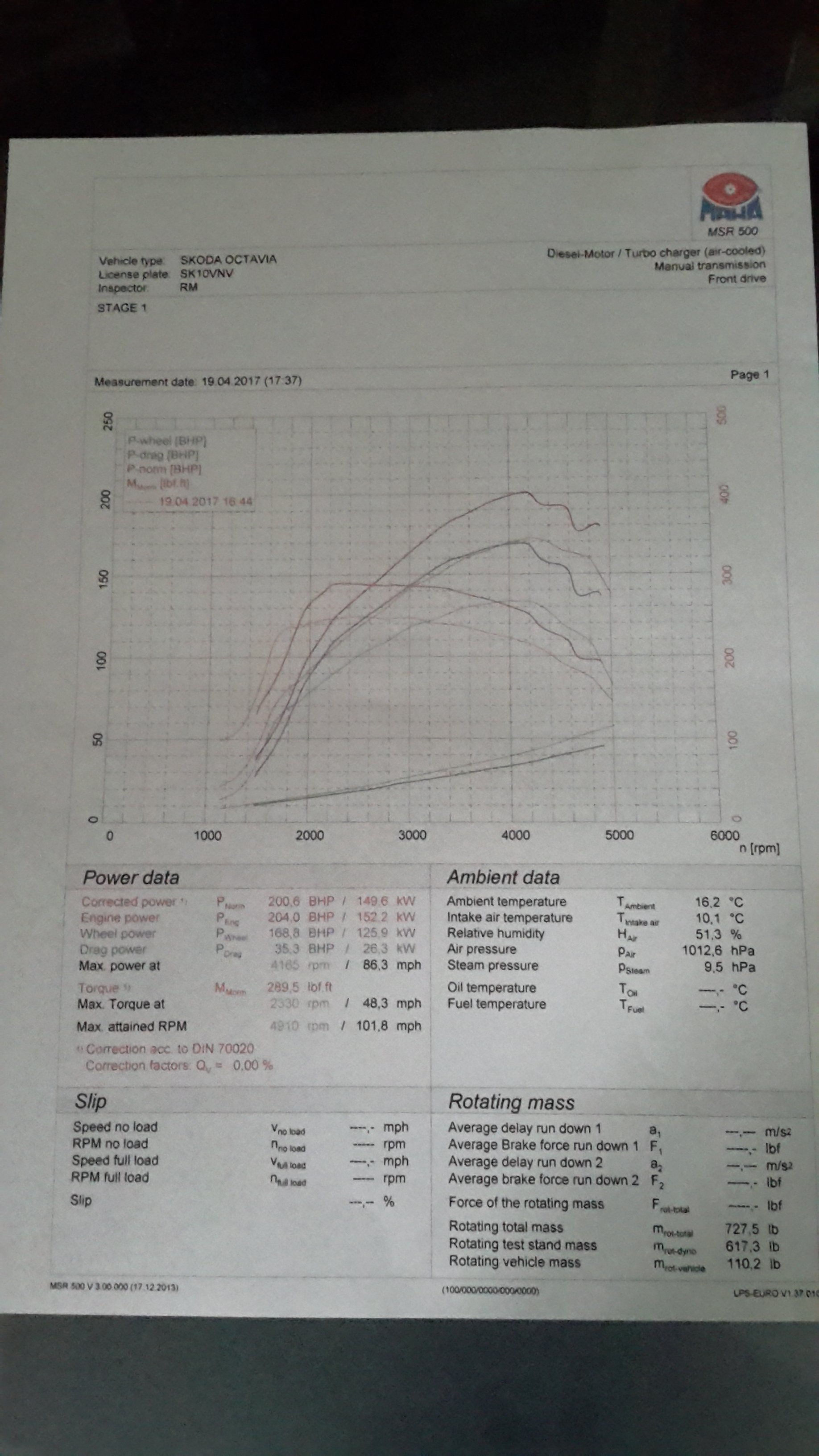

Next step of my project,
A few more horses set free, stage 1 remap now running at a healthy 200 bhp on the dyno.
Work was carried out at Automotive Soutions in Peterlee who are a VAG only independent and APR tuner.

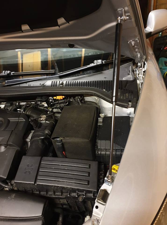

Bonnet Gas strut,

Were the struts difficult to fit? And where were they bought from along with the LEDs for the boot and glovebox?
