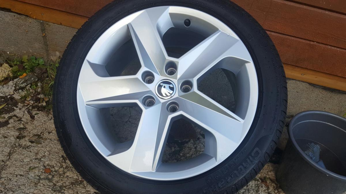

I've just bought some 17" Skoda MKIII Vrs Standard spec Alloys for my 230, they fit a treat..................

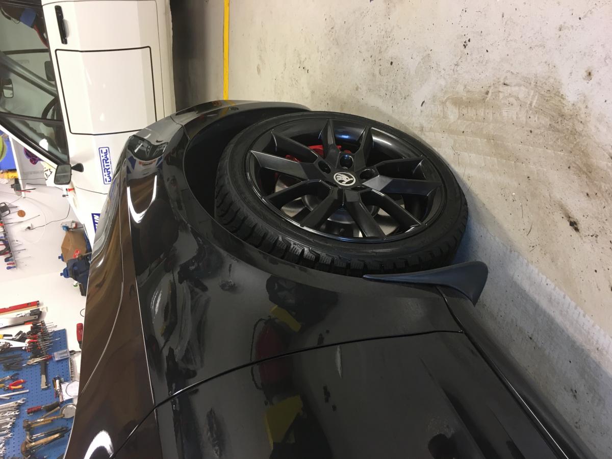

My winter wheels fitted on the 230
Your Garage floor has one hell of a slope on it.................
:). Sorry about that. :)

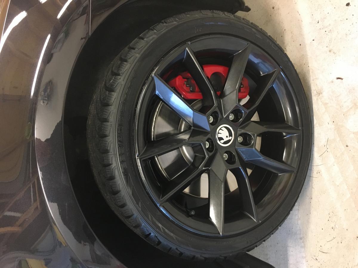

Now its a better picture. The 18" seems small
KjetilRos, are they factory 18" Gemini wheels in black?
