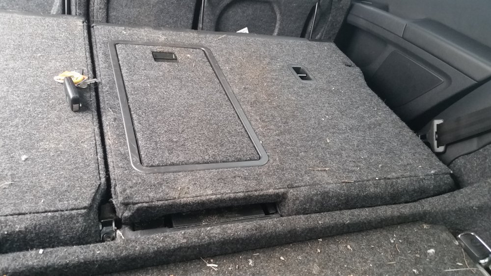

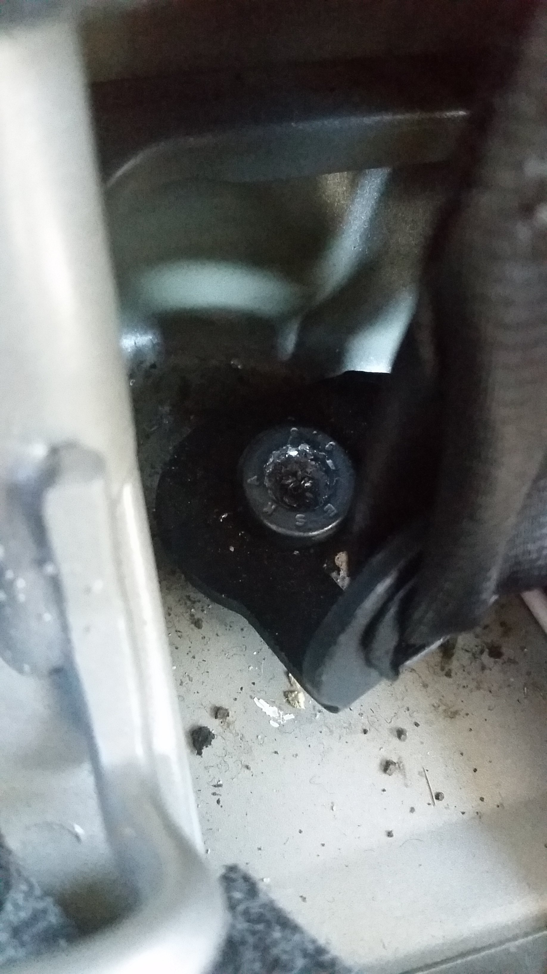

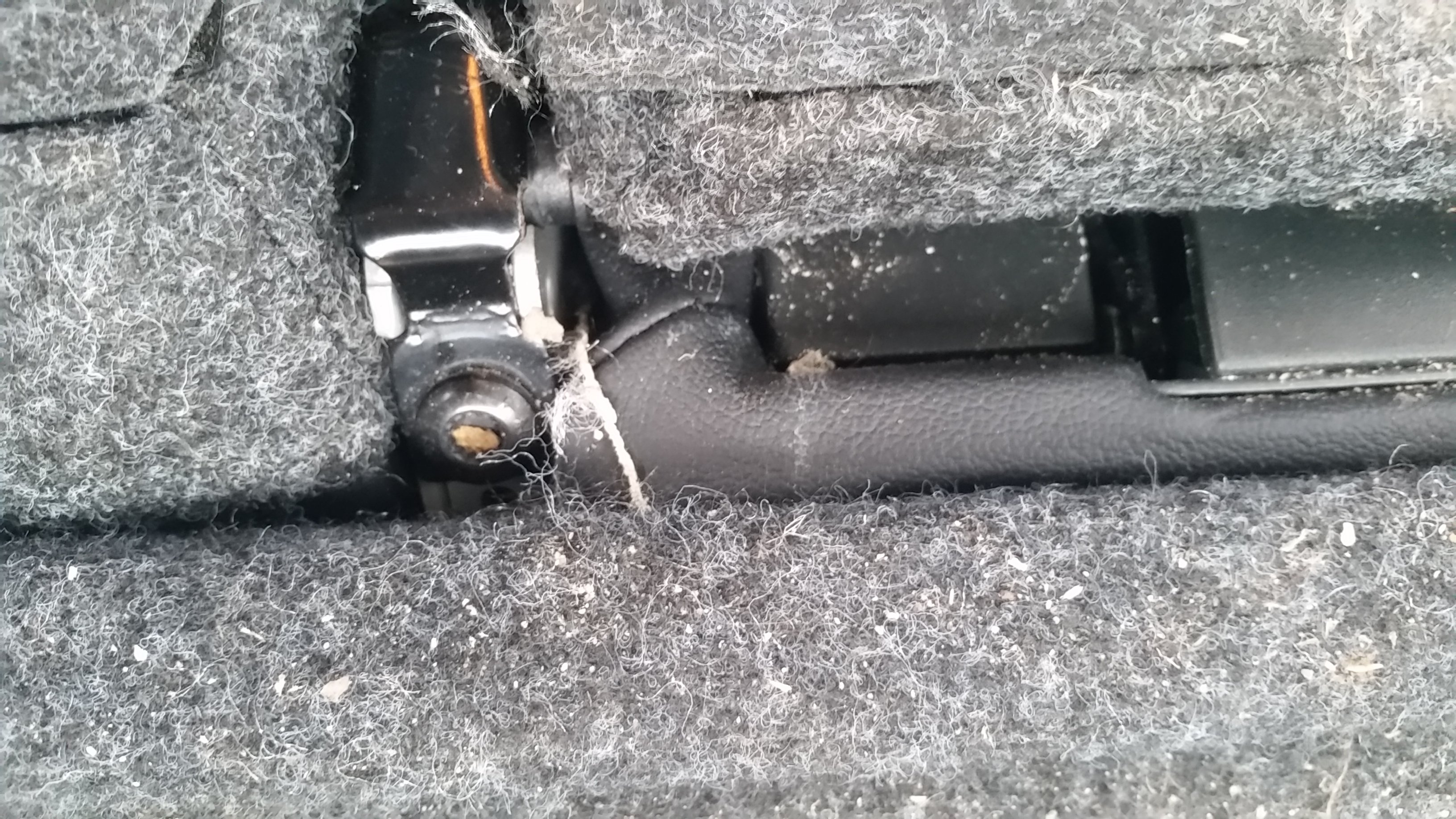

Just getting around to this and must admit I'm struggling!
I can only see one bolt. Photo attached. Is this the one that needs to come off?
Thanks in advance !
Douglas
Yes, that's the one you need to remove. It's either T45 or XZN M8 (I can't remember off-hand). Once you remove the bolt and the little bracket over it, life that end of the seat back so it's clear of the other one and wiggle it free of the pin at the door side to remove it. The pin is about 40-50 mm long so it's a bit of a faff (the seat backs are heavy).

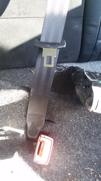

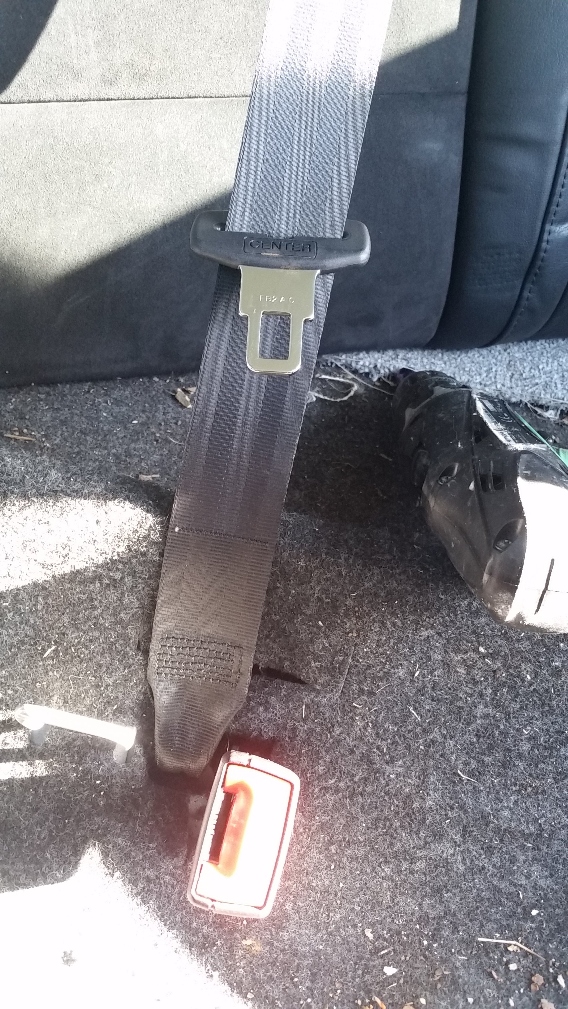

You also need to remove a bolt which attaches the center seat belt to remove the bigger seat don't you?
If that's the case I'll need to nip to screw fix as the bolt head is a big 12 point thing and I don't have the correct bit.
Thanks!
If you're completely removing it, then yes. Otherwise there's enough slack on the belt to slide it of your way if you're just trying to remove trim pieces.

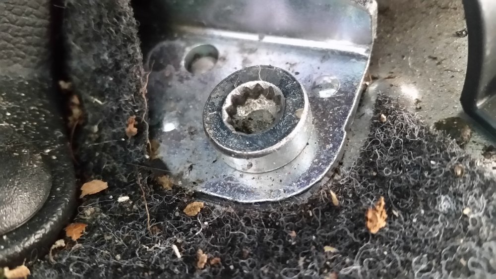

I wish I had bought the bits myself !I took it the garage down the road who said they were happy to loosen the bolt for me. Expect the mechanic ha's gone and totally stripped the little teeth from the inside of the bolt head.  He was apologetic and said they were not really designed to come out?!
Anyone any ideas as to how I could get this bolt out now? The mechanic said blow torch it and try vice grips on it. Would soaking it in wd40 do any good? It did seem very stiff when he was trying to loosen it- he said that was due to 'loctite'.

Depending on access, something like a Stilson wrench is probably your best bet to get it out of there. Just be sure to have a replacement ready to drop in there. You'll need to get the bolt from Skoda, especially when it's a safety related item.

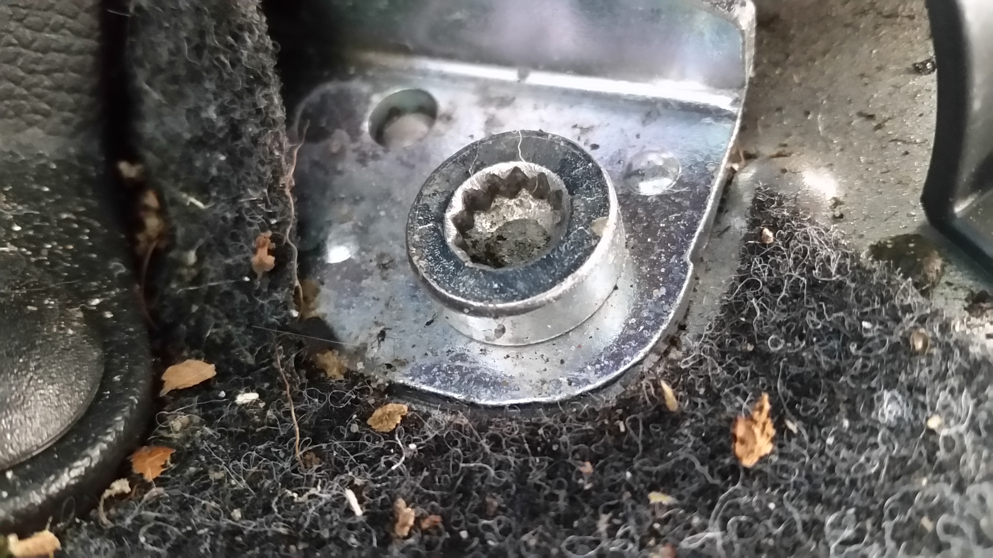

That will be a pain to get out but you will need an arsenal of tools if you want to succeed.
I would start with a small pair of stilsons as above or a pair of mole grips but due to the tightness of that fastener I doubt this will work, a hammer and chisel might have more chance of getting it to turn. Welding a nut to the top of it may work and the heat you put into it may help crack it loose and loosen any loctite that may or may not be on it. Might have to be aware that too much heat may damage the integrity of the seatbelt
Then your next bet is to remove the head by grinding it off, you could drill it but those bolts are usually hard so you would need carbide/cintride drills and lots of patience if you wanted to do that. Then of course you have to try and get the stud out which due to the thickness of the bracket means you won't have much to try and hold onto so your back to trying to use a hammer and a punch to get it to turn or trying to weld something onto it.

No, you wouldn't be able to get enough torque on it I don't think. You could try this and then use a flat blade bit in one of those striking style impact drivers.
What I was meaning originally is that You are basically wanting to knock the read round in an anti clockwise direction using the chisel to bite into the head of a bolt.

It's an XZN head. Buy this set and never worry about these sort of problems again: http://www.drapertools.com/product/33323/Tx-Star-Hexagon-and-Spline-Mechanic-s-Bit-Set-(40-Piece)
Not quite - you'll need a 12 point one or two sizes bigger than this set goes to if you ever have to change the rear disks.
I'd have a go with the correct 12 point bit before trying the more extreme solutions. I suspect the mechanic stuck a torx into the bolt as the teeth aren't completely removed (The bolt would have just come out if the right tool was used). If this doesn't work I'd see about finding an allen key/Torx a size bigger than the bolt and hammering that into the head to undo it. Then see about vicegrips or a stilson, then try dremeling a slot into the bolt head and use a steel plate as a screwdriver. The other end of that bolt is accessed from underneath the car too, though I have no idea whether you need to take the fuel tank out to have room to work on it...
