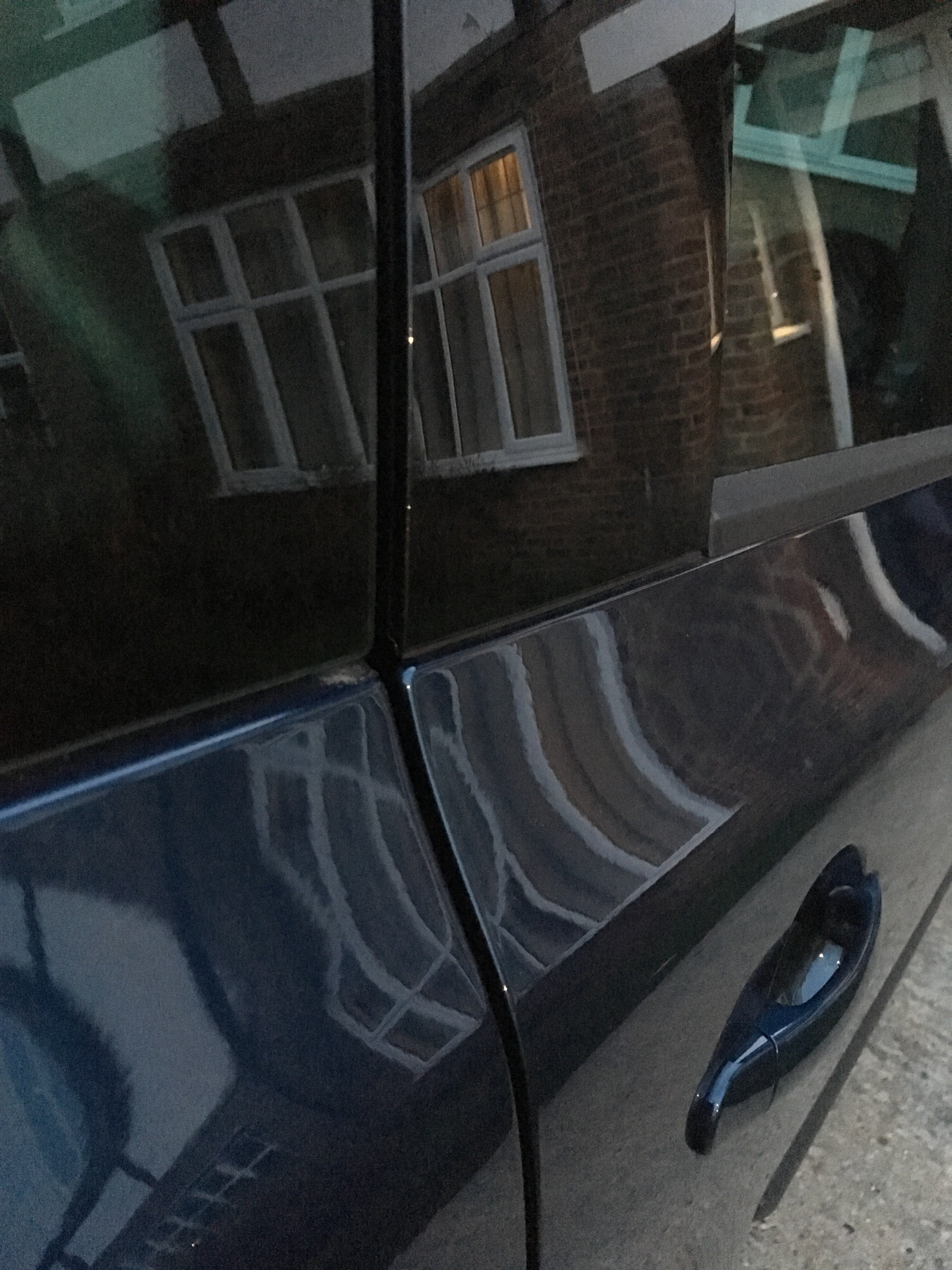

The back doors are about 1/4 inch out of line with the rear panel, spoiling the smooth lines of the car. Or is it just my vehicle?
Photo?

That's not right is it?
I'm sure mine aren't like that.
I wonder if the catches could be adjusted to pull the doors in more?

It's exactly what my back door looks like when I 'swing' it closed rather than closing it firmly whilst holding it in my hand all the way, if you know what I mean - it doesn't close and catch properly but I've got used to it and as long as I remember to shut the door in the 'correct' way it's fine. I assume that this isn't just a case of not being firm enough though??
