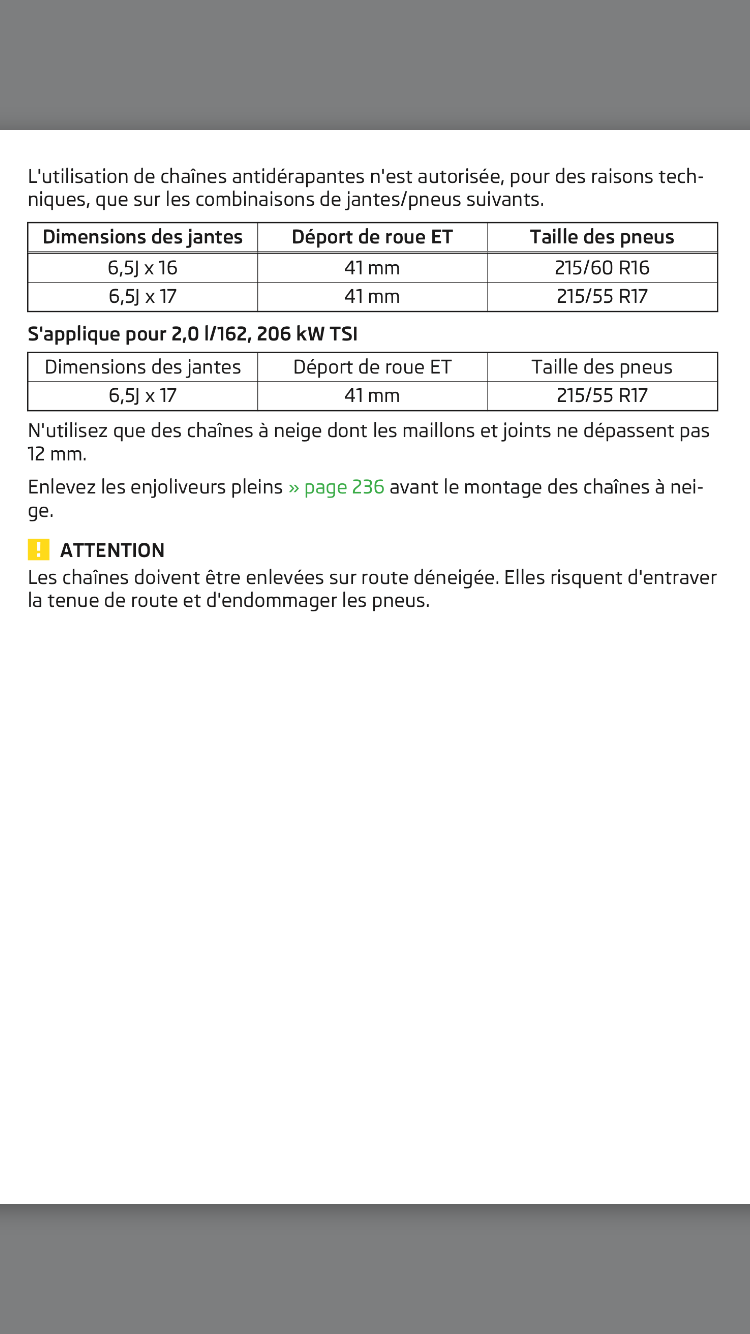

Seems not the same size in manual?post-148255-0-66532800-1477850169_thumb.png
I had never checked the manual but yes it does say a different size to what they actually fit (a 215 tyre would not physically fit under the boot carpet)
