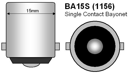

Have you put the bulb in the right way around?
The standard brake/tail bulb is a 566 with offset bayonet fittings.
If these bulbs are forced into the holder incorrectly it is possible to fit them the wrong way around i.e. brake lights come on when tail lights turned on and vice versa.

Seems like the led is single bayonet. Does it affect anything?
