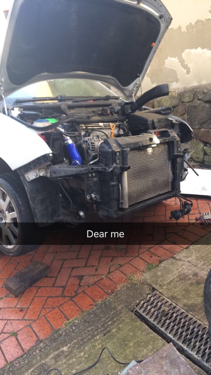

Here's were I got up before the heavens opened
Slam panel off next - make sure you tie the rad up to stop it dropping off! Then you can see where you've to cut parts off the slam panel to fit the boost pipes in.

Finished it all took about five hours in the end. I'm off to my mates on Sunday so he can sort a map out for me. Thanks for all the help if you wouldn't of told me about tiying the rad up it could of got messy. The jubilee clips are quiet good quality compared to some I've used you can get a good twist on them.
