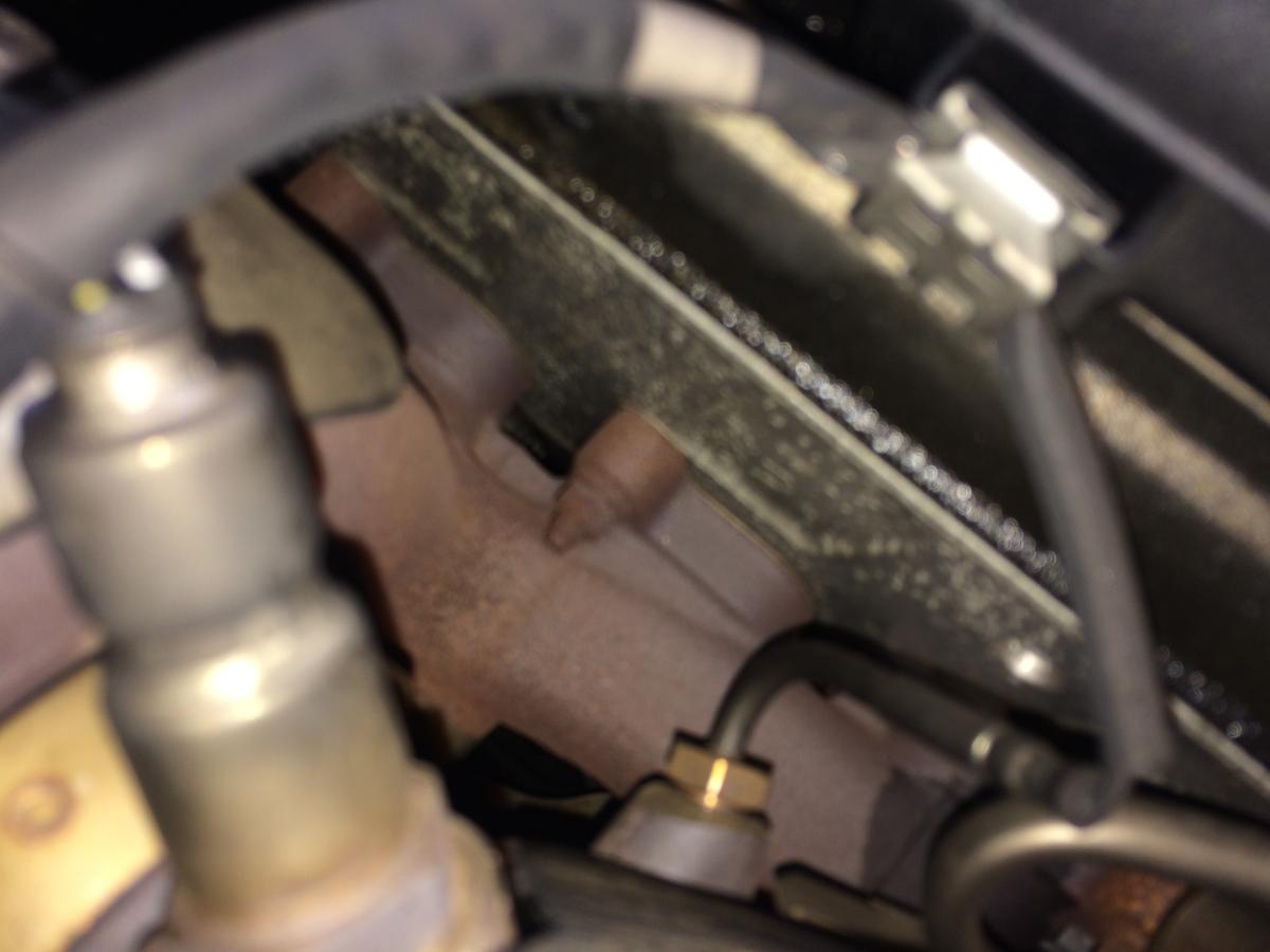

Then checked oil filter, no signs of leakage there, i took the engine cover off and saw signs of oil near the turbo and some signs of oil down the back of the engine, please see images attached.
I refilled the oil today and will be inspecting at frequent intervals to see at what rate the engine is losing oil.

What is at the other end of the large pipe?
I'm just wondering if oil is getting in via the breather and then the EGR gasses being sooty are allowing build up and the oil to come out.
It wasn't uncommon on the older PD engines.

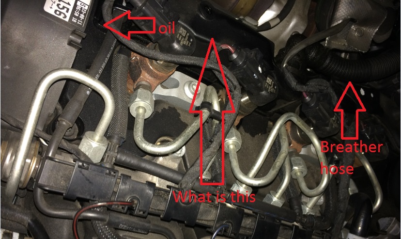

So after a drive today popped open the bonnet and signs of oil on top of the engine seeping. Feel really stupid but what is the part in the image below?
It seems that this part is seeping the most oil as you can see from the image.
I'd call that the "top of the crank case breather assembly", no idea on the proper name for it though.
