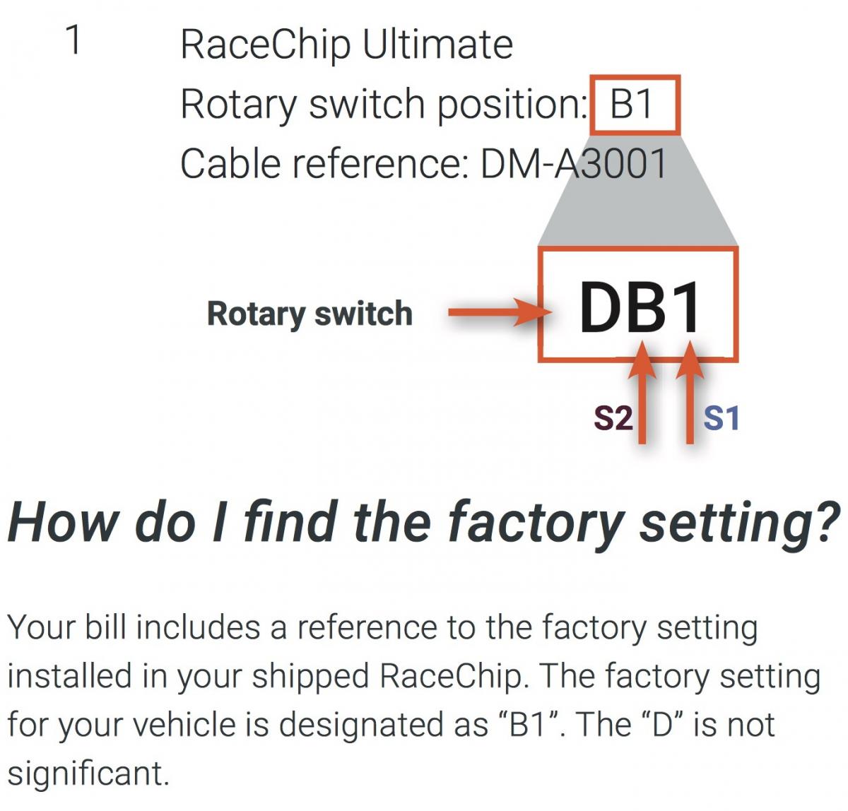

Contact Racechips, ask for factiry settings (should be a combination of two symbols - letter and or digits).

In the linked PDF in #22 (petrol) it states that RaceChip include the vehicle setting (code) in the invoice. Well, not on mine.
@Eurotraveller - perhaps you can aid the OP by checking if you have a code like this shown on your invoice...?
Nothing, sorry.
