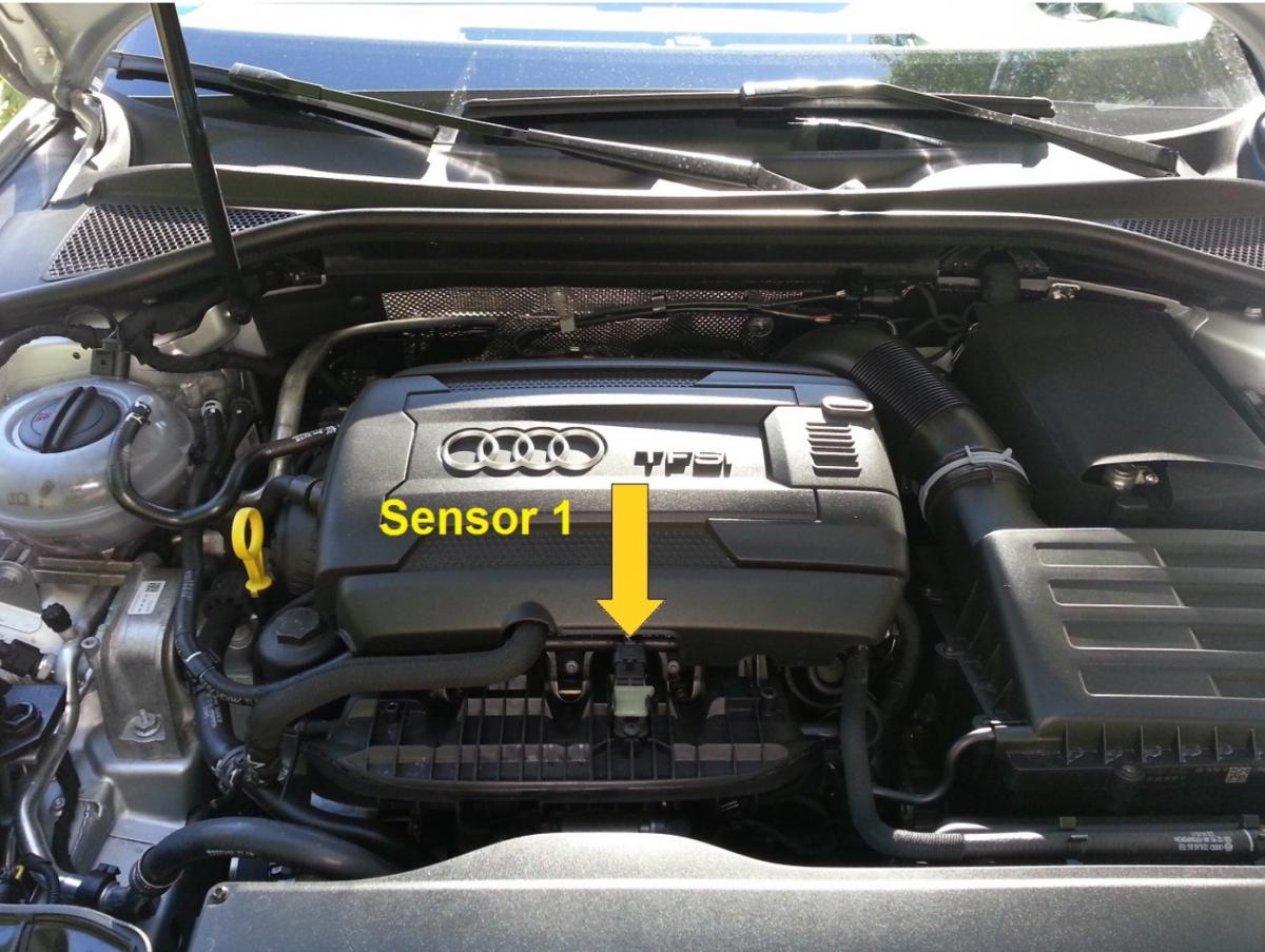

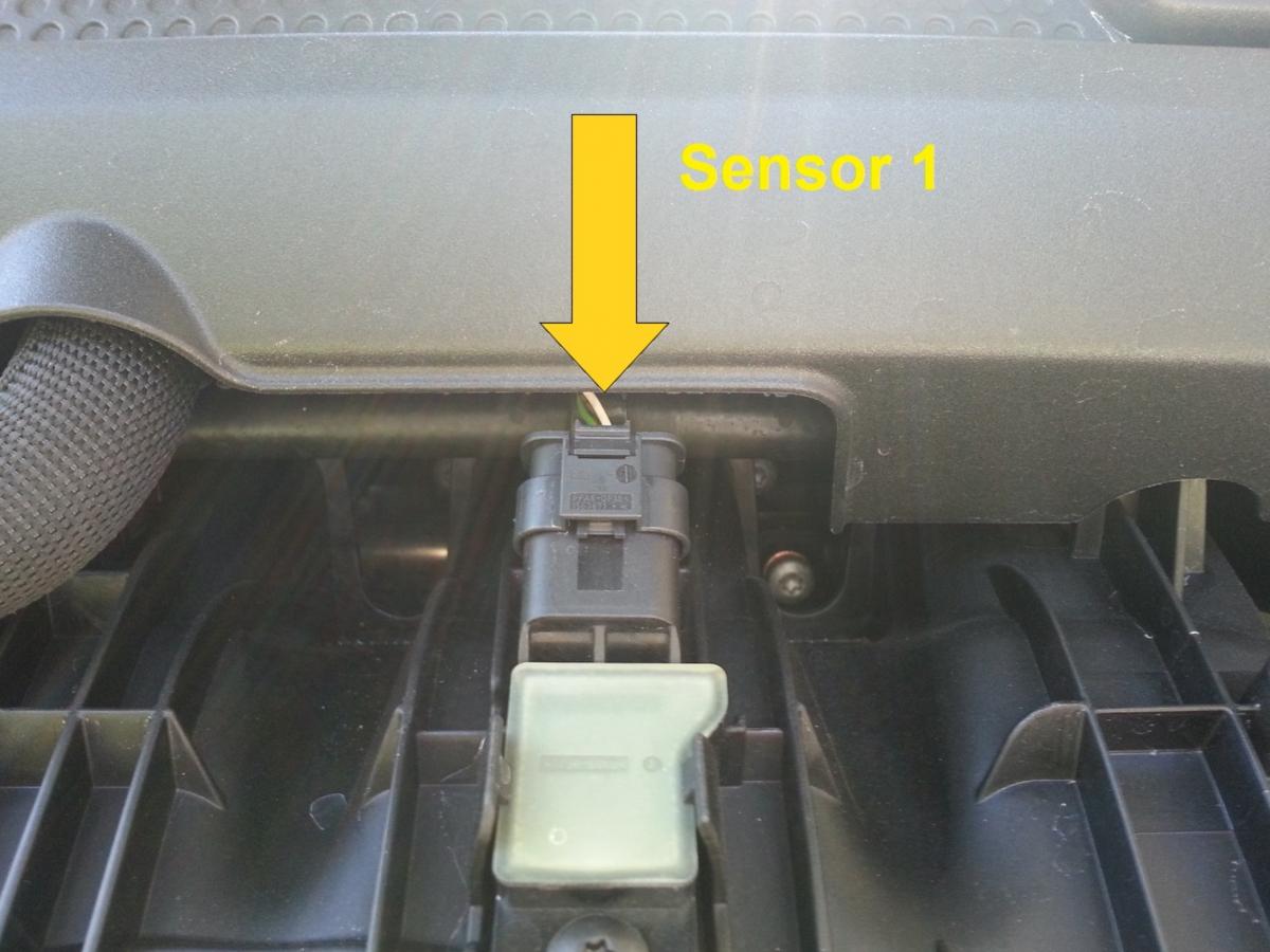

There are just two sensor connectors that need to be "intercepted" with the non-app version. I believe the app version has a third connection but I can't help with that.
One is directly on top of the engine and very easy to access. Just pull up on the plastic engine cover to reveal it in all its glory.

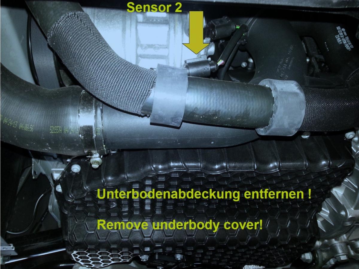

The other is near the bottom and front of the engine just beside the A/C pump and this is the fiddly one (hence easier if you jack the front end and unscrew the plastic sump guard).
***Photos are from the PDF that was sent by Racechip and whilst it shows an Audi engine it is exactly the same as the Superb 280***

Removing the sump guard is indicated in the second photo of my previous post, where it says "Remove underbody cover!"
You can only get unrestricted access to the bottom sensor from below with the sump guard removed - which means getting under the front of the car - which means raising the front.

The PDF you should have received by email from RaceChip, which in my case was sent before the box had been shipped, only includes three pictures showing sensor locations (non-bluetooth version). Two of those were already included in my previous post. For convenience I've added the third, which is just a close-up of the same top sensor connection shown in the first photo...
If you don't have the bluetooth version then, combined with my post in the 280 PS thread, you already have all the information you need without having to even open the flimsy generic manual.
