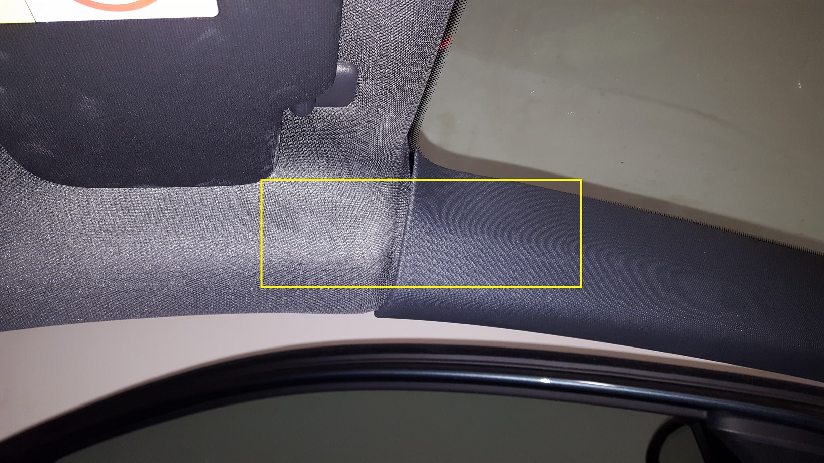

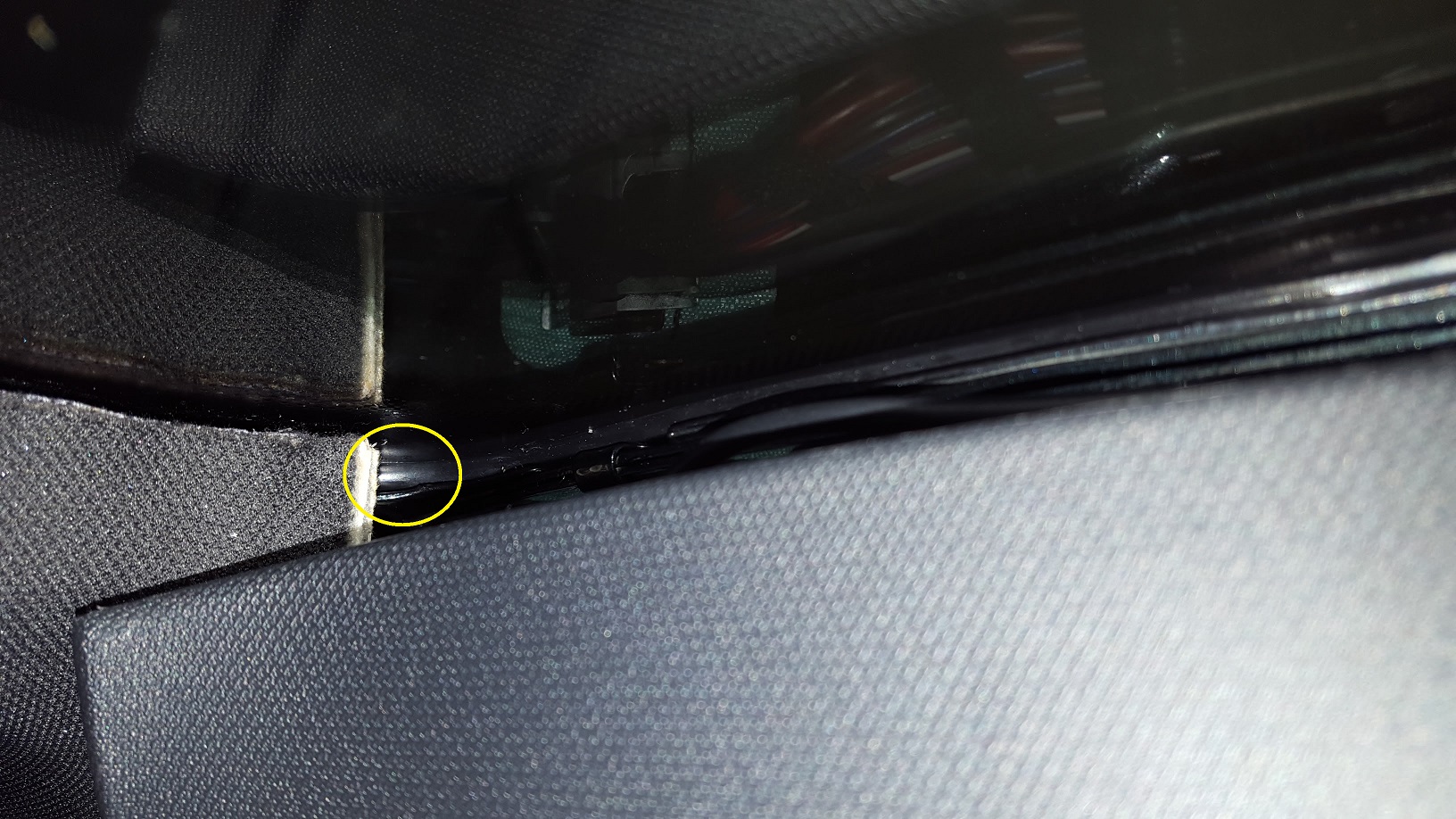

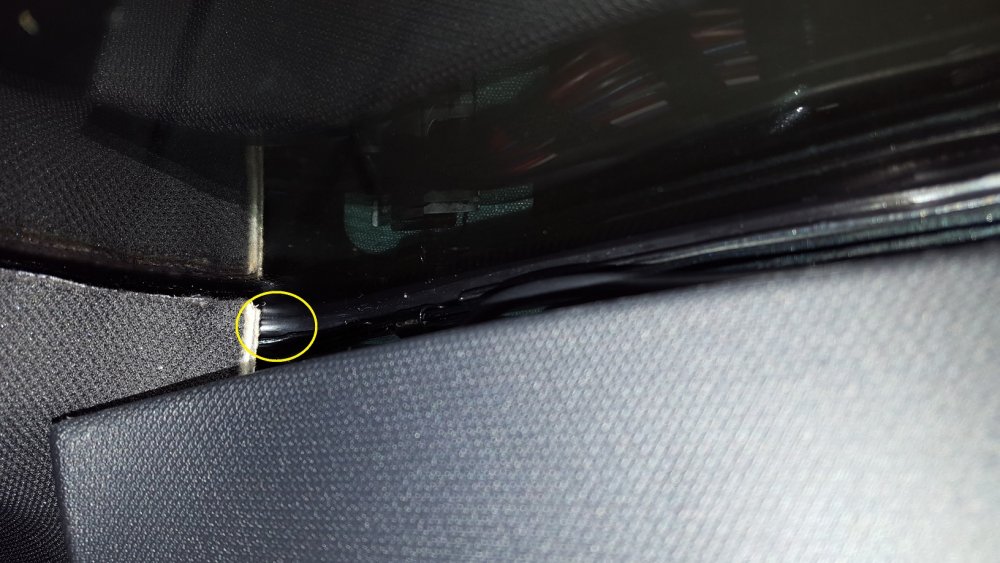

Hi everyone, I finally found the source of the rattling noise from the a-pillar area after weeks of searching.
For mine, the source of the noise is at the top of the a-pillar where it joins the roof. The noise seems to be coming from inside the cavity, so to not make any mess, I sprayed some WD40 PTFE dry lubricant into the tiny opening pictured after opening the a-pillar trim. The pillar opening is just enough for the wd-40 straw to get in... after 1-2 sprays..the noise is gone instantly! ...So there you have it, it's good to have my quiet car back after weeks of searching.. Hopefully this post helps somebody else!
