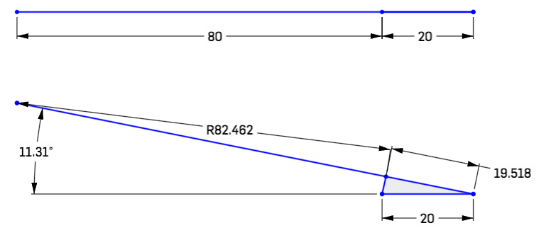

I'm not sure if you're agreeing with me or not... There isn't any need for a Pythagorean triple or even a right angled triangle :)
Quick sketch to show the effect, assuming the object covers 20 meters in 1 second:
To the first observer they will cover 20m, starting at 100m and now being at 80m giving a speed to the observer of 20m/s.
To the second observer they will cover 19.518m, starting at 101.98m and now being at 82.462m giving a speed to the observer of 19.518m/s.
This effect is amplified as the angle increases and also if a 3rd dimension is brought into play.

I don't know what you're drawing, but it's totally irrelevant to a radar, which will derive object speed from the time between propagation and return of a pulse, and hence measure the actual range between radar and object regardless of whether the object course is on boresight or not.
The Pythagorean triples are a convenient (if limited) illustration of this.
It was an attempt to show the cosine effect which the OP, probably needed a better explanation...
Radar can't derive the object speed from the time it takes a single pulse to return, only distance - at least not without multiple receivers.
If you also take into account the frequency of the return pulse, then it's possible to get both distance and the radial component of the objects velocity.
As it's missing both the axial and tangential components, it will be lower than the actual velocity when not travelling directly towards or away from the radar.
If you take multiple measurements then you can get an average speed but it'll only be the actual object velocity is the angles are measured. Without the angles, you will still be missing the axial and tangential components.
Back to the OP statement, would you agree it's not possible to get a higher speed measurement than the actual object speed? At least assuming the radar/lidar is correctly aimed at a consistent part of the car.
