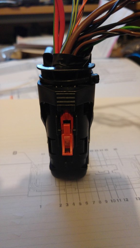

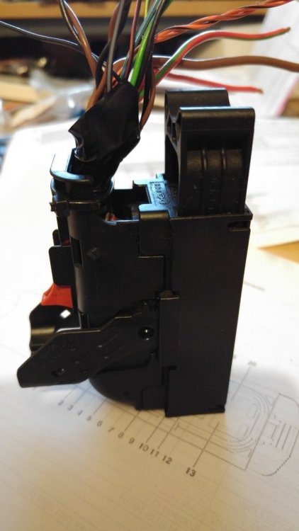

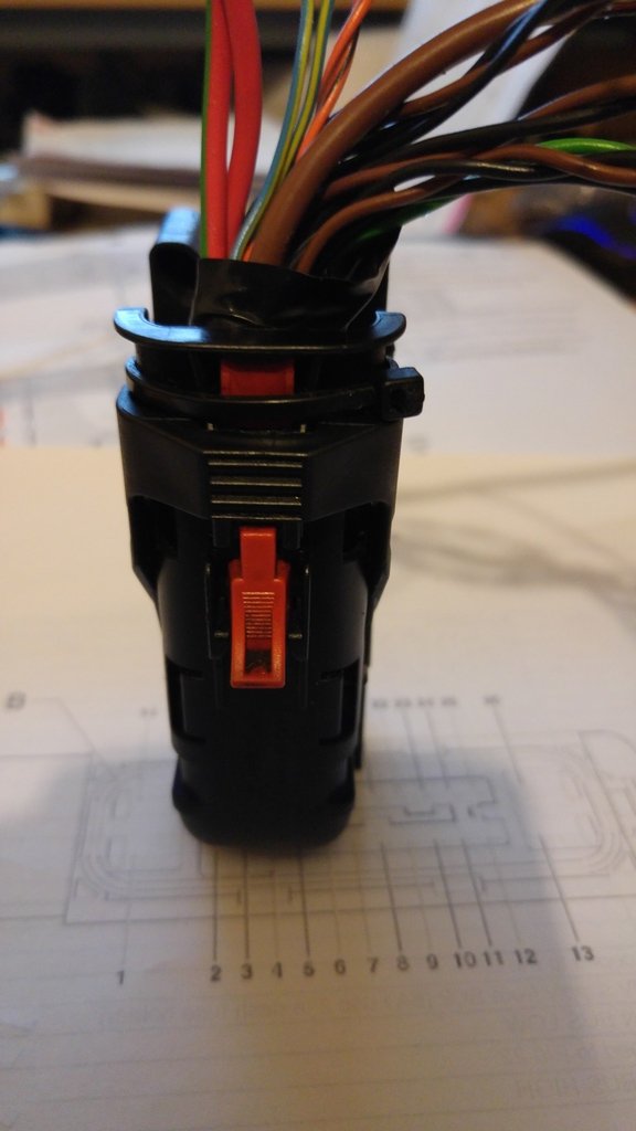

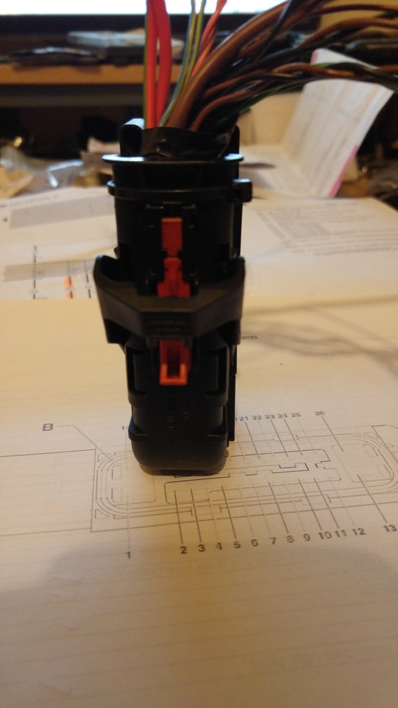

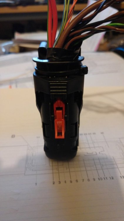

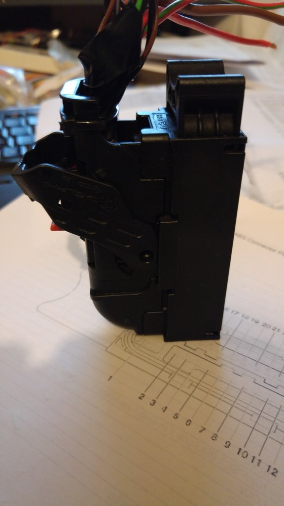

How do I remove the cable from the controller.  There is a red slider on the connector which I slid down but the connector still doesn't want to move.  It could be I am a bit wimpy and my hands were freezing and I just need to apply more brute force but I'd rather not do that unless as a last resort.
D
slide the red tab down
then pull on the lever

I fixed it today.
It's been sat on the drive for the last two months and I have been otherwise occupied to get the time/weather right so I could get out and crack on with it.
I replaced the complete ABS module.
I've attached a PDF of the wiring to the plug and some pics of the plug.
I rang the wires out and had good earth, good supply and also good bus connection.  Getting the plug off the ECU is difficult, especially with cold hands.  The unit is not in the best of places to gain access.  In case you are reading this to find out how to get the plug off you need to slide the red lever downwards (img1 & 2), easy enough, then there is a lever just above the red img3 which needs to be pulled away from the plug and hinged all the way down.  This jacks the plug out of the ECU.  It is difficult to get to on the Octavia and I would recommend taking the battery out to give you better access.  The big lever is locked in place with the red one but it is also latched so you need a bit of force to get it over the latches.  Once it moves, it is fine but getting it started is the problem.  I used a scriber with a 90 degree end to hook behind the lever and pulled it because it was just too painful on my finger ends.  The images are the right way up as the cable is mounted.  The loom enters the plug at the top.  I made sure the unit I got from Ebay came supplied with the plug just so I could take these photos :-)
I found a replacement ABS unit on Ebay for £30.00 including delivery and plugged it in but it didn't show up on the scan at first.
When I went back and checked the system I found that I had left fuse 4 out in the engine fuse box.  Once that was plugged in the ECU was visible on the bus.  This is slightly misleading because fuse 2 in the cabin fuse box is 'Control unit for ABS,ESP' so you would expect that fuse to be the fuse that powered the electronics.  Fuse 16 (30A) 'Pump for ABS' and Fuse 4 (30A) 'Valves for ABS' seem to be a bit large for powering the electronics :-)
I had removed fuse 4 because that was the only way I could get the engine to run for more than a couple of seconds.
I think what has happened is when I changed the battery on the car, the ECU fried.  It fried in such a way that it latched the bus drivers on if there was power supplied (via fuse 4), possibly even put a full 12V on the bus.  This stopped all the other ECU's from using the bus reliably hence I got everything lit up as broken.  WIth the fuse out, I was able to clear the faults, keep the engine running and run diagnostics, with the fuse in, nothing.
I will take the ECU to bits and see if I can see something obvious when I get a bit of time.
The job was straightforward to do but it was a pain having to remove the battery, the air intake ducting etc. just to get to the unit.  I also think that the unit could have been mounted so that it would be possible to replace just the ECU.  As it is, you can't get in to the screws to remove the ECU because it's facing the inner wing.  Moving the unit nearer the centre of the car would have made the job a lot easier.  I had one brake pipe seized in the union.  I undid all of the others OK and removed the unit from the mount and then unscrewed it from the pipe.  I had to warm the union up to free it).  I overheated it and melted the plastic coating but I figured this was better than twisting the union and snapping the pipe :-)
I now have my favourite car on the road again :-)
ABS_Connector_Plug-Pin_Assignments.pdf
