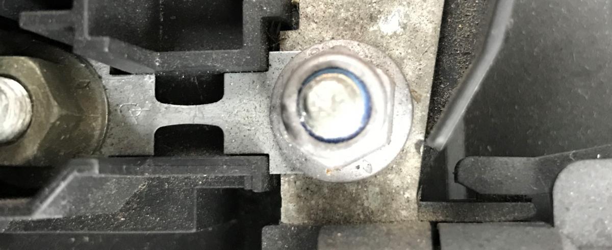

Wino,
I've had a look and found the fuses. Nothing massively out of place, there is a line going across number 6. Not sure if this is just a scratch or something or it its a crack as the other post suggested. Shall I post a pic?

Yep, stick a pic up.
Here it is, I've cropped it slightly so hopefully you can see it better. There is a small line through the middle. Not sure if its a scratch or a hairline crack. The others all have no marks on them.
Try lifting it slightly, if it opens up it's a crack and you must replace it anyway.

Update:
I've tried gently depressing the fuse and it appears there is some 'coming away' where the line/crack is. I'm wondering if that's why it sometimes goes off and the comes back, if the fuse is being jostled around whilst I'm driving.
Will look at replacing and see if that fixes the issue. Cheers for your help.
