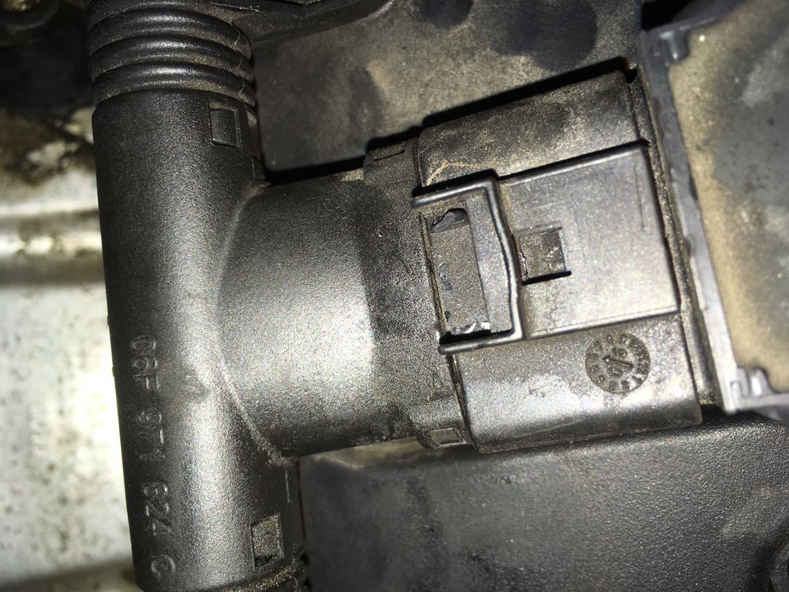

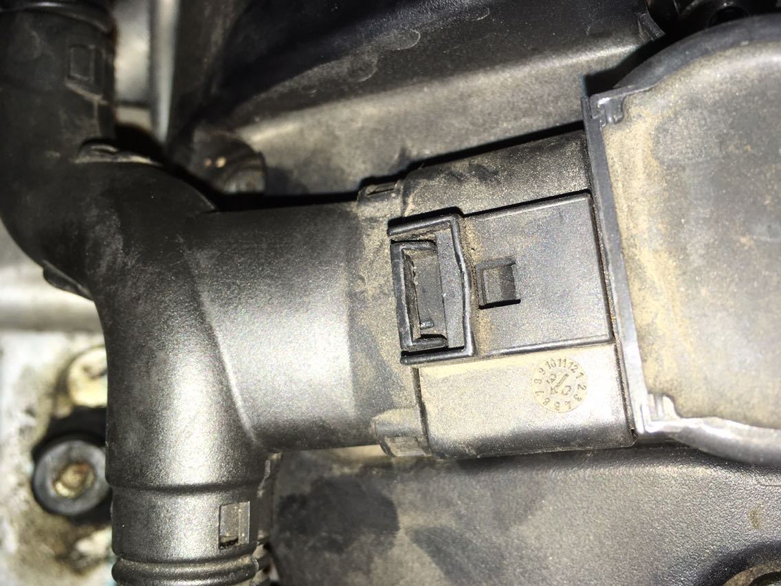

Those darn annoying plastic clips, and the wire is so tight it feels near impossible to wiggle them off. I managed to get ignition coils 1 & 4 off fairly easily, definite drop and change of engine tone and roughness so intended to try 2 & 3. That's where I encountered very stiff clips, was trying my best to be patient and gentle but then snap...
I'm at a complete loss as to what to do now as I have no idea to remove coils 2 & 3 now the clips have snapped. I've uploaded 2 pictures, one is coil 4 which is fine and the other coil 3 which is clearly snapped.
Ffs, I knew I should've just taken it to a garage. I really need the car fixed tonight as back to work tomorrow.
Push the clips in towards the ignition coil to remove any tension on them then push the clip to release.
Don't worry about it being snapped they wont go anywhere.
Yes, just like King85 says. If you can push harness towards coil pack it releases tension on the locking tab and then you should be able to activate the clip by hand.  I wouldn't worry about the broken ones unless it is a really loose fit.
They aren't usually as the rest of the harness and coil packs will keep them in place. I'm pretty confident you won't be the first to have broken a tab or two.
You push the tabs down and pull the plug. Just put forefinger under plug and thumb down on tab then squeeze and wiggle/pull. Might need a flat blade driver to push down the broken tab if you cant get your thumb on it.
Tip: squeeze (push tab down) before pulling.
