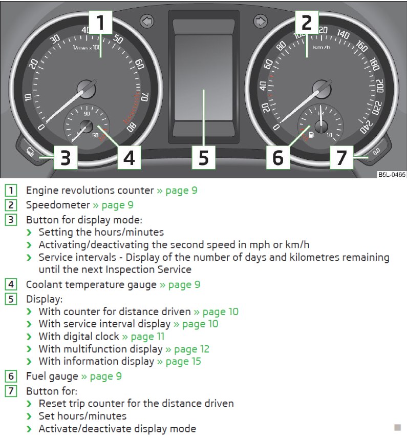

Well my Yeti has (pre F/L)!
I find it is quicker to adjust the clock using these buttons than by using the MFD display...
Buttons 3 & 7 in the picture attached.

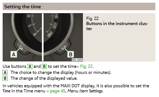

Been to Frome and back today, and tried pressing the left button, and indeed it now highlights the hours and minutes.
But how do you correct the time?
From the manual . . . .
Left button to highlight units, right button to change them if I remember correctly.
Thank you both; I am now heducated!
