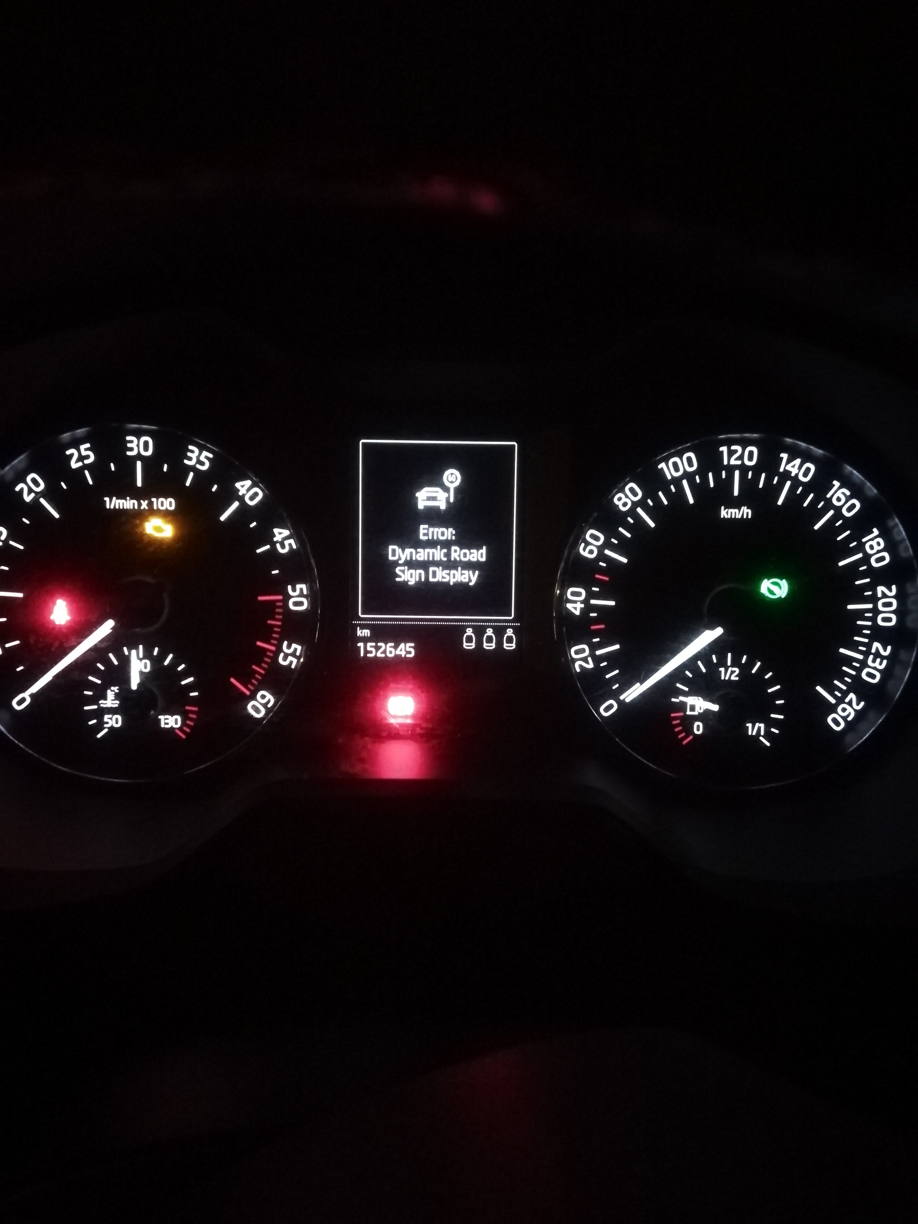

I recently bought obdII cabel and vcds for my skoda octavia III and yesterday I tried to enable sign notification (I didn't know I needed front camera to work) and now I can not erase the error, when I turn the ignition on. I have turned everything back to standard (as it was before) and it still pops up an error. Does anybody know how to erase that error or disable the function? I have tried scanning and then deleting all dtc codes, but error is still there.
Thank you.

Here is the error.
