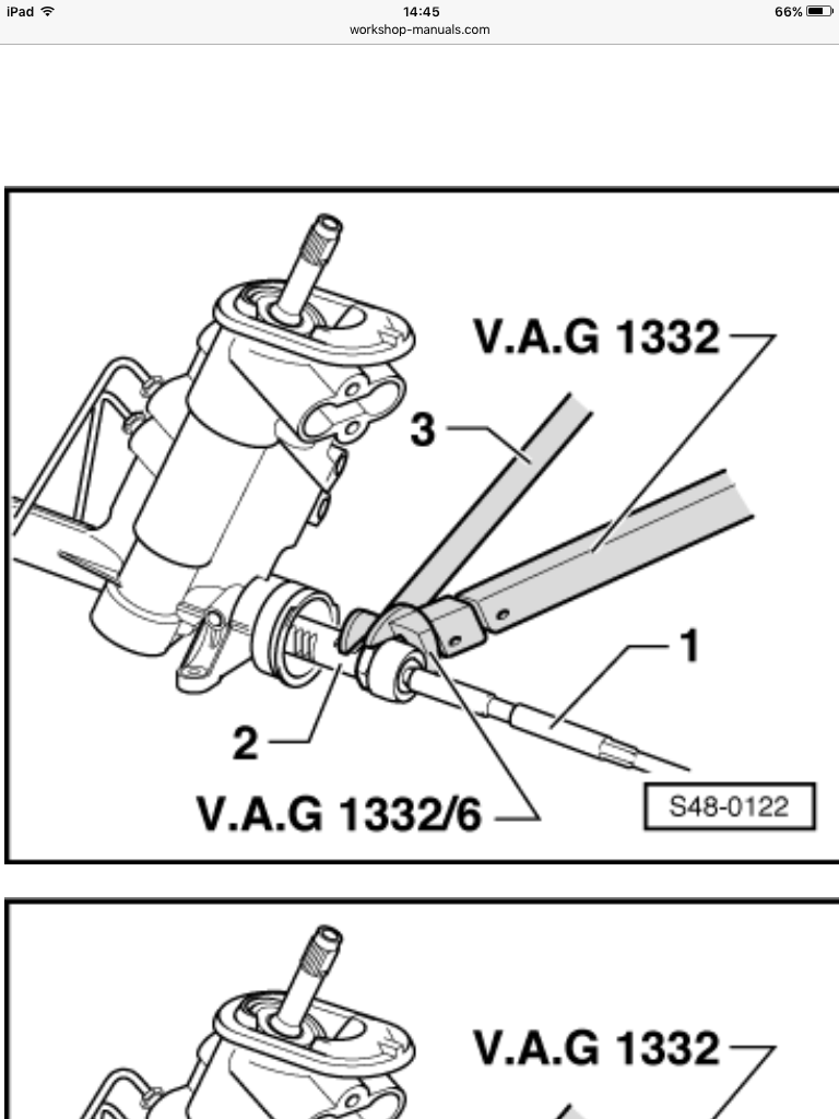

  • These track rods do indeed screw into the end of the rack assembly. Hopefully the image shows what rum4mo is trying to convey.

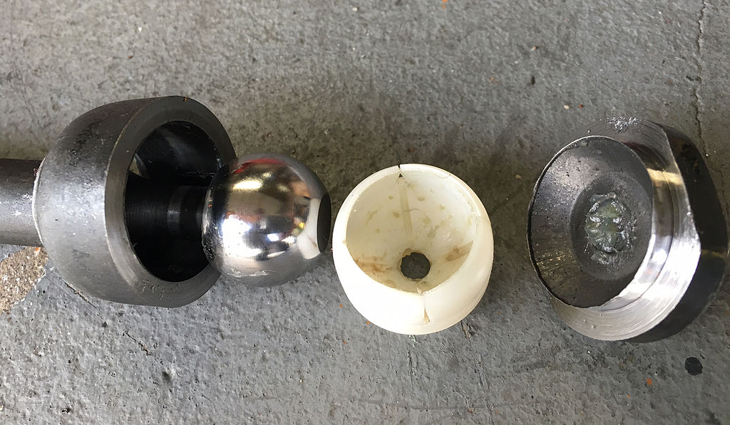

An inner tie rod end cut open to expose the ball joint.
Good work, that's the rack end so should keep some people happy.
Looks like they supply the grease with it :D
The ball joint on the right of the picture is "open" not sealed. Apply grease to it and move it around to spread, it's very easy and straight farward.
Obviously it's a little more complicated when fitted but the same process
You can't lubricate a ball joint correctly without stripping it down, which is not possible in this case. Rather than prolonging this arguement, lets see what Skoda says.

xman, you are not reading and understanding what people are telling you
In post 19, you yourself stated  "Bit difficult as they appear to be sealed ball joints."
This indicates clearly that you are looking at the outer end - WHEREAS, we are all talking about the inner end which can be dismantled and re greased or replaced. This part is within the steering rack boot.

Again, maybe I'm wrong, but I'd like to see you servicing the inner rod joint in these cars, the complete steering rod or track rod assembly is secured to the end of the rack by means of a threaded end.  I've re-read what I wrote, and I have not edit'd that posting, and I can't see where I tried to say that  the rack complete with its steering rods (track rods) is a complete sealed assembly - I have had to replace these rods on a 2002 Polo once, not for creaking, but for movement!
Thank you "Wonky" same as shown in posting 25 if anyone is in any doubt.
Wonky - rum4mo - xman
Looking at Wonky's post #38 - I have no hesitation in saying I got it wrong.  :(  So unreserved apologies all round!
Having never seen the layout illustrated before, I wrongly made the assumption that the 'retaining collar' was removable thus exposing the innards like most racks in my motor trade days were assembled - clearly I have to eat humble pie.
