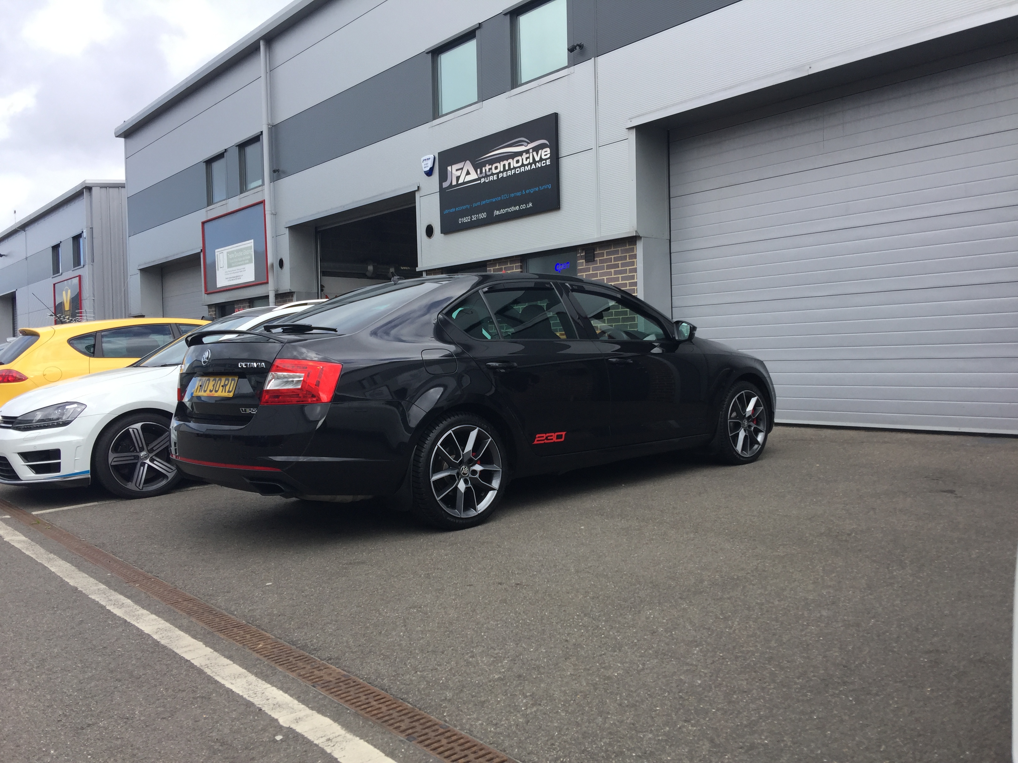

Mrsgroup1rs's VRS 230

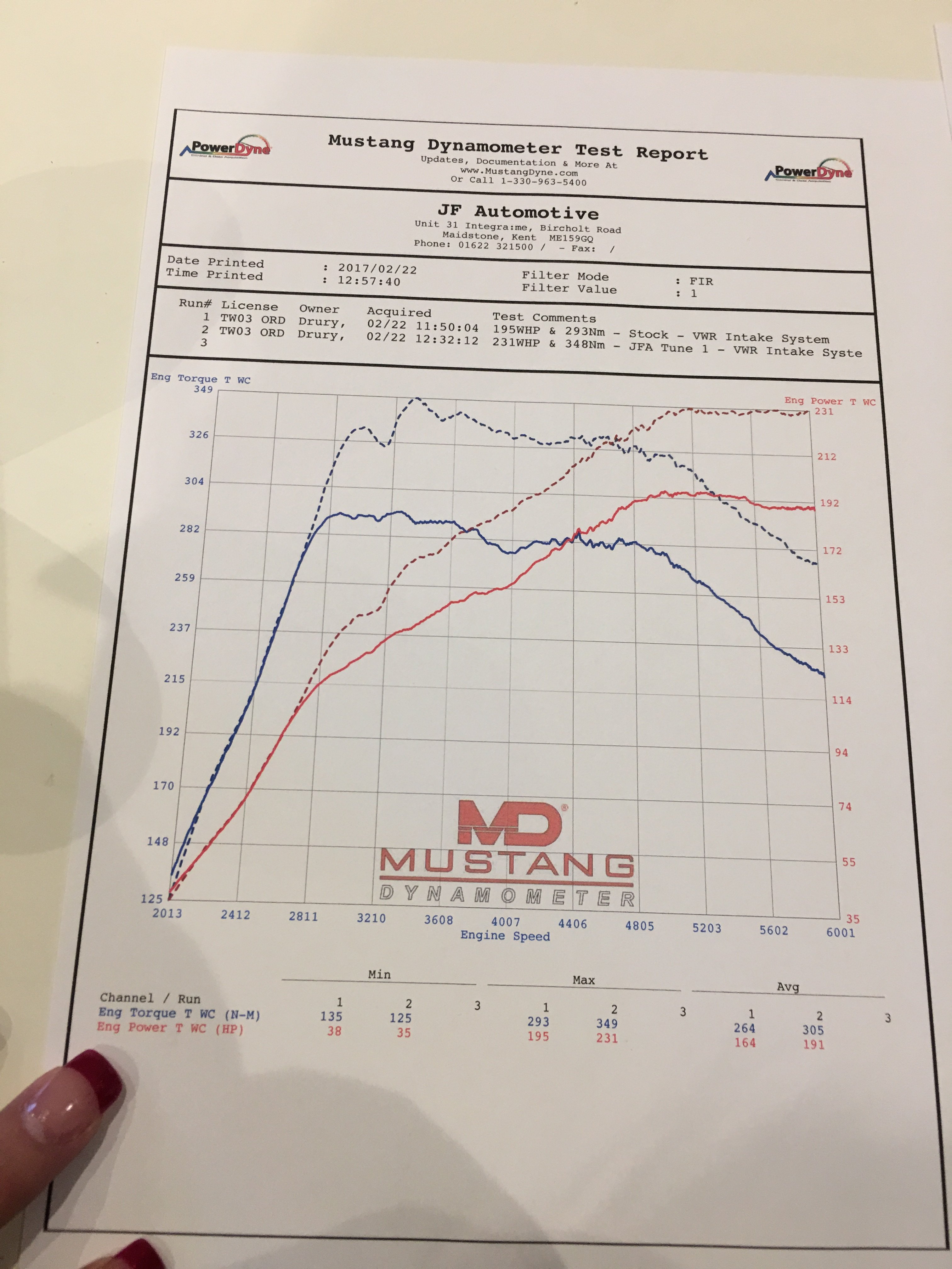

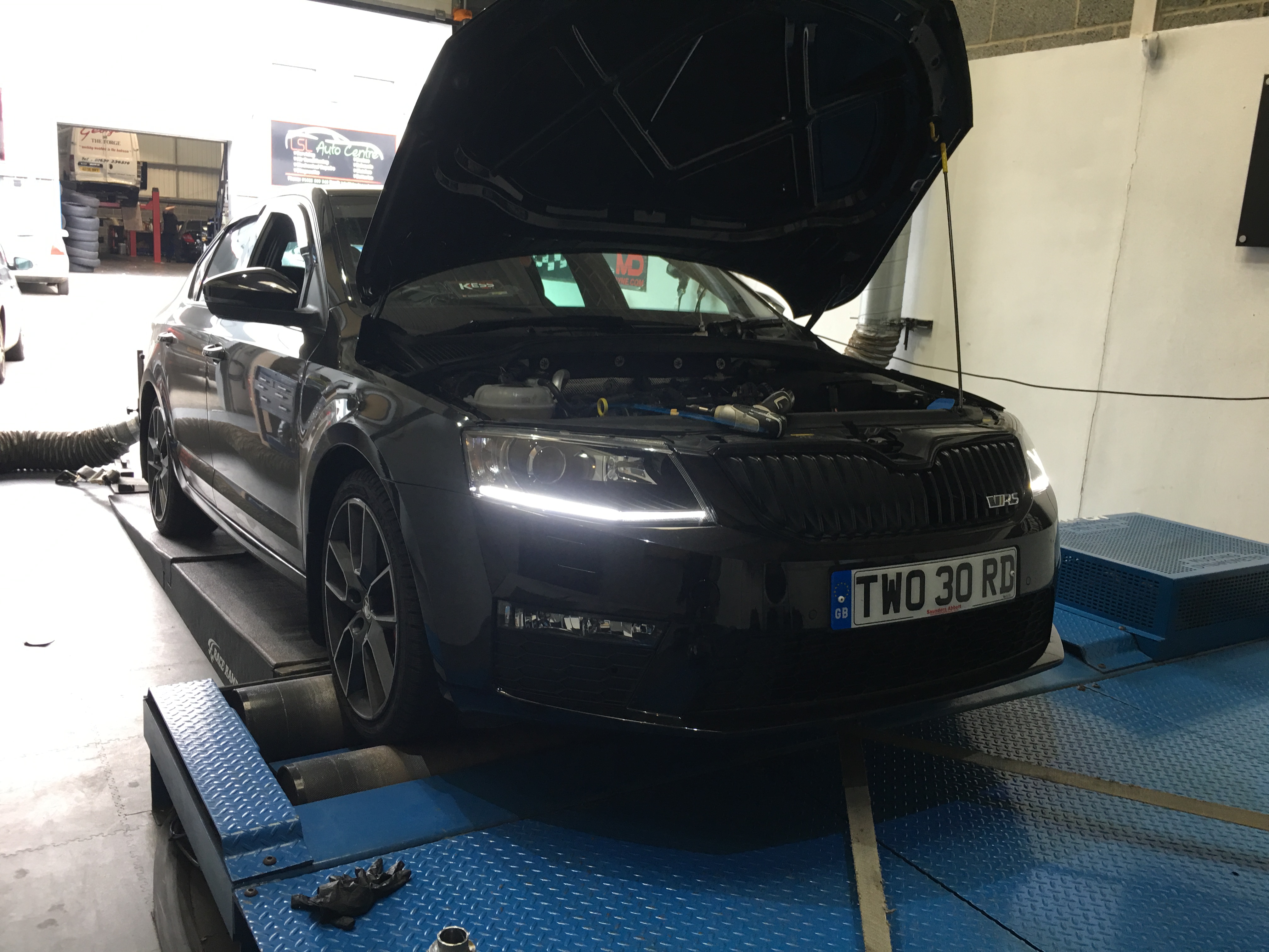

2 hours ago, stu83 said:
Who did you have it mapped by?
JF Automotive in Maidstone.

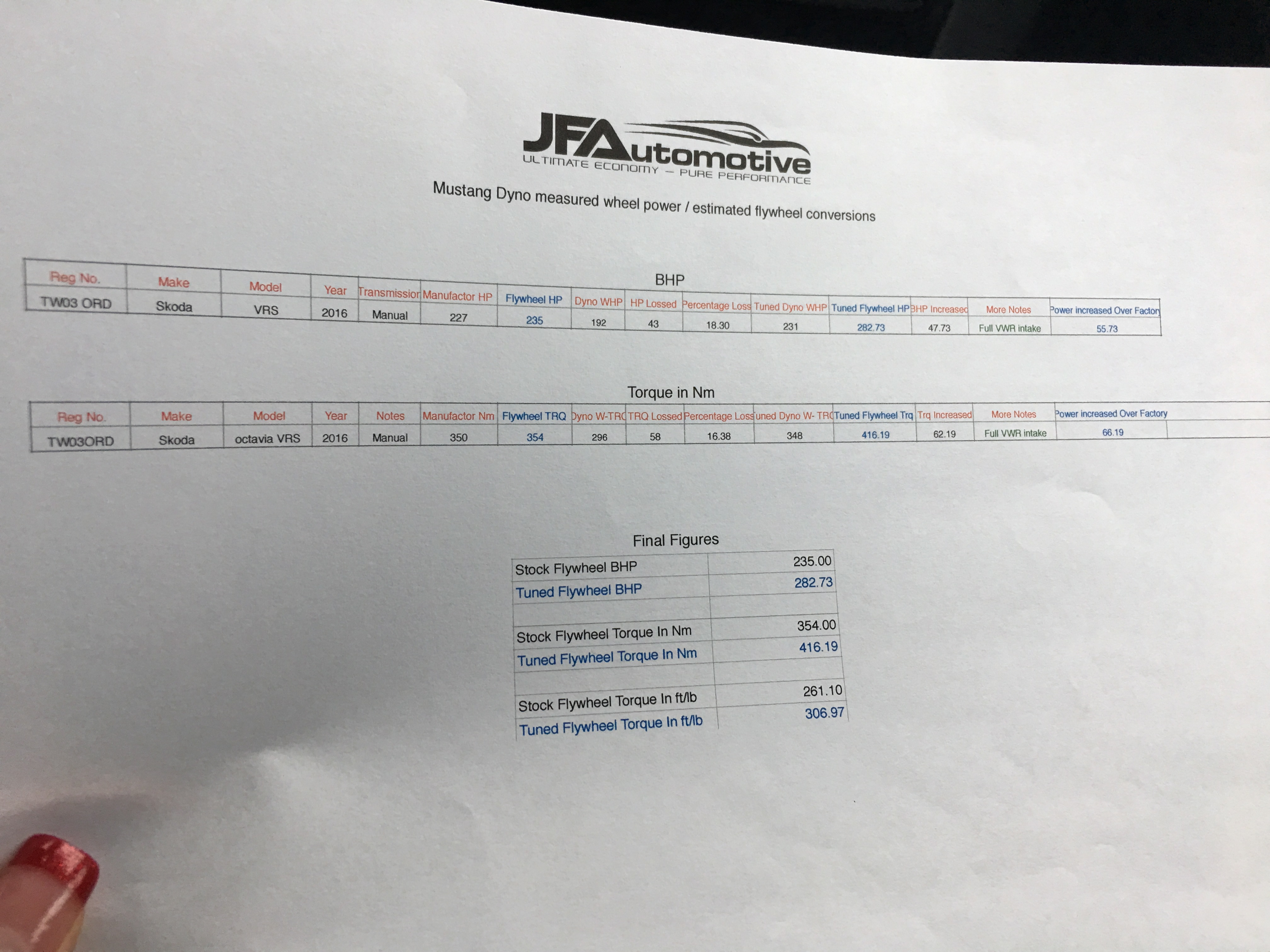

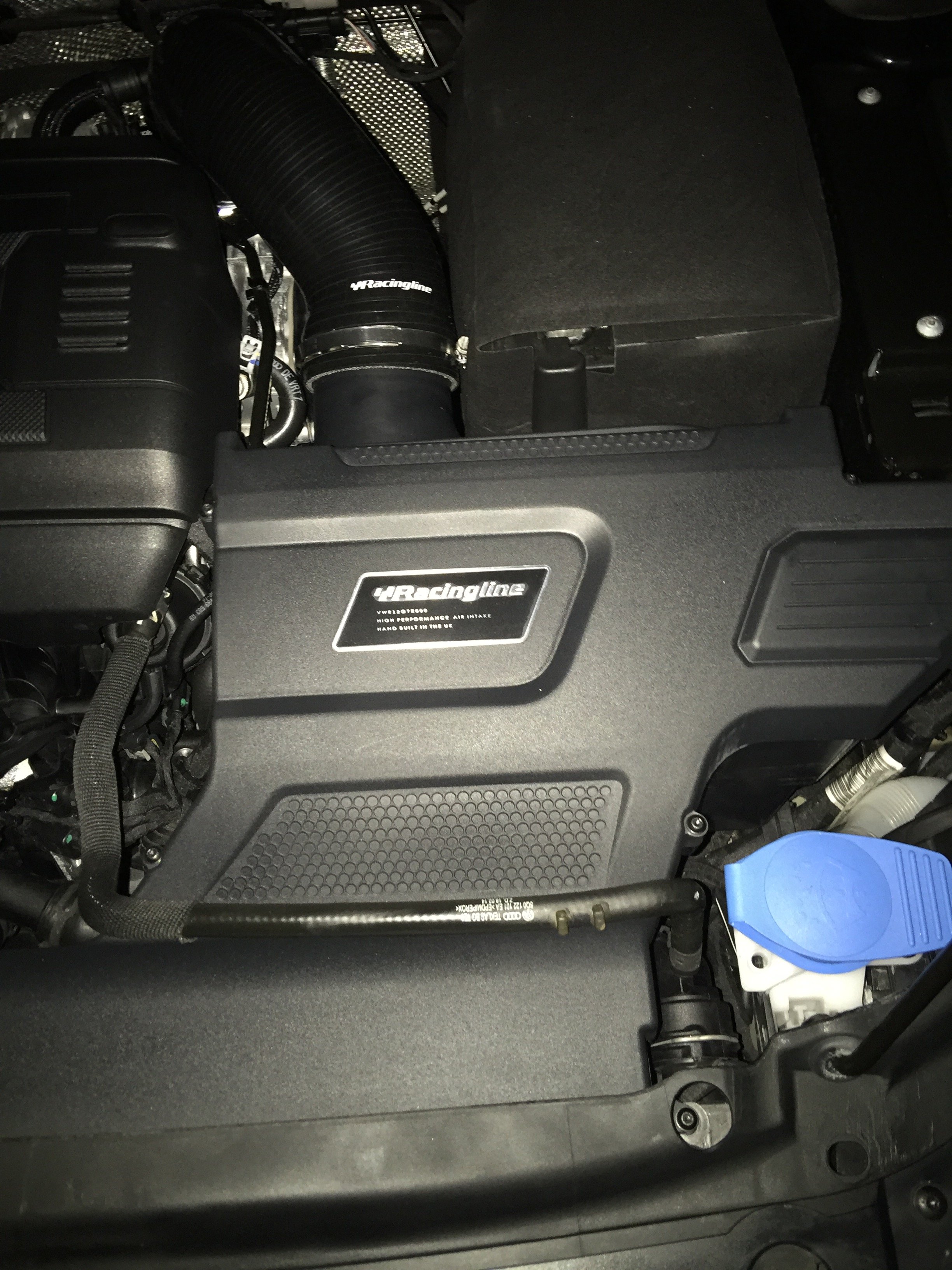

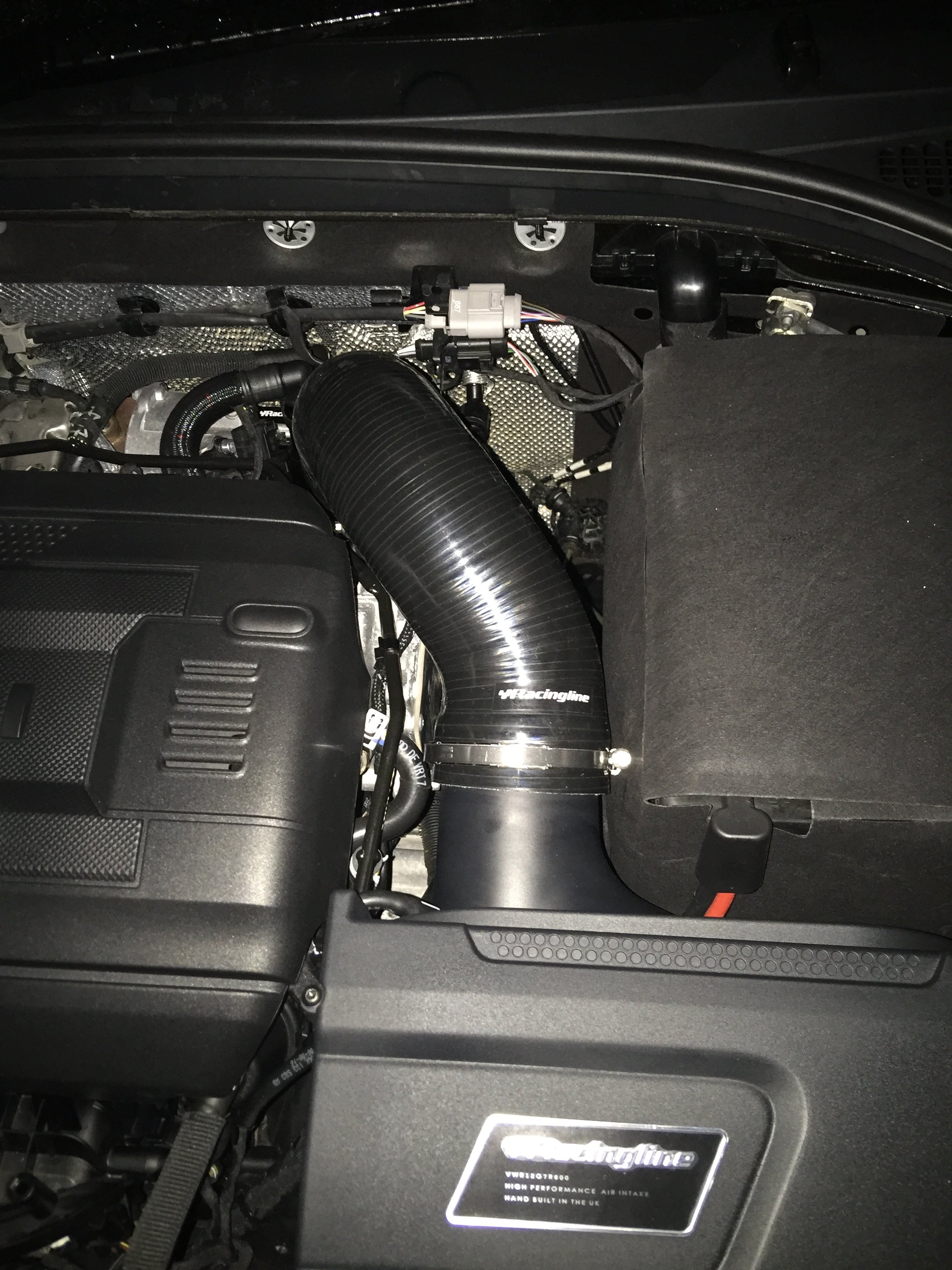

Very nice ... and the R600 intake I see!
Good gains without willy-waving figures too. Is it their own map?
Yep their own map live on the rollers

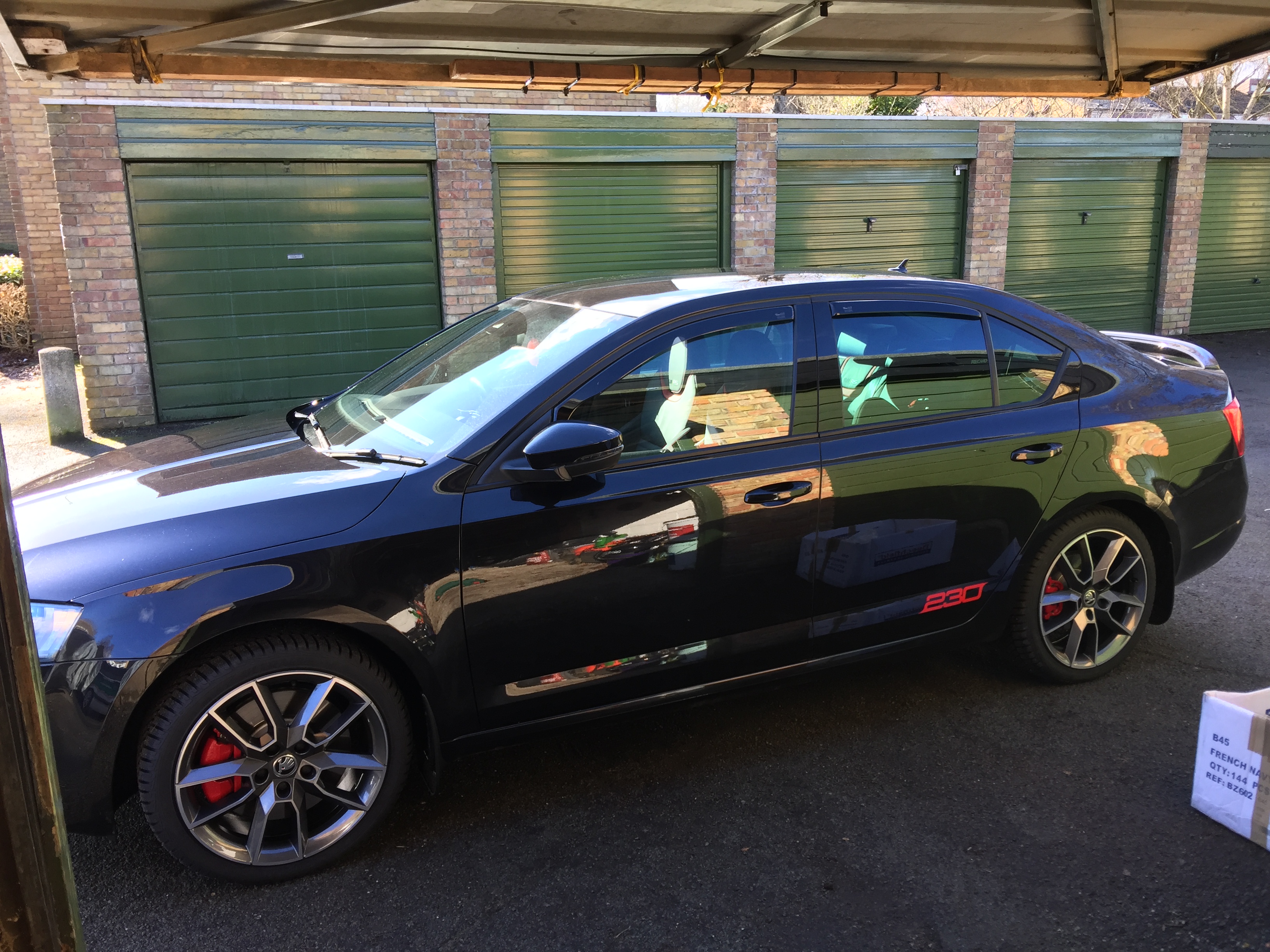

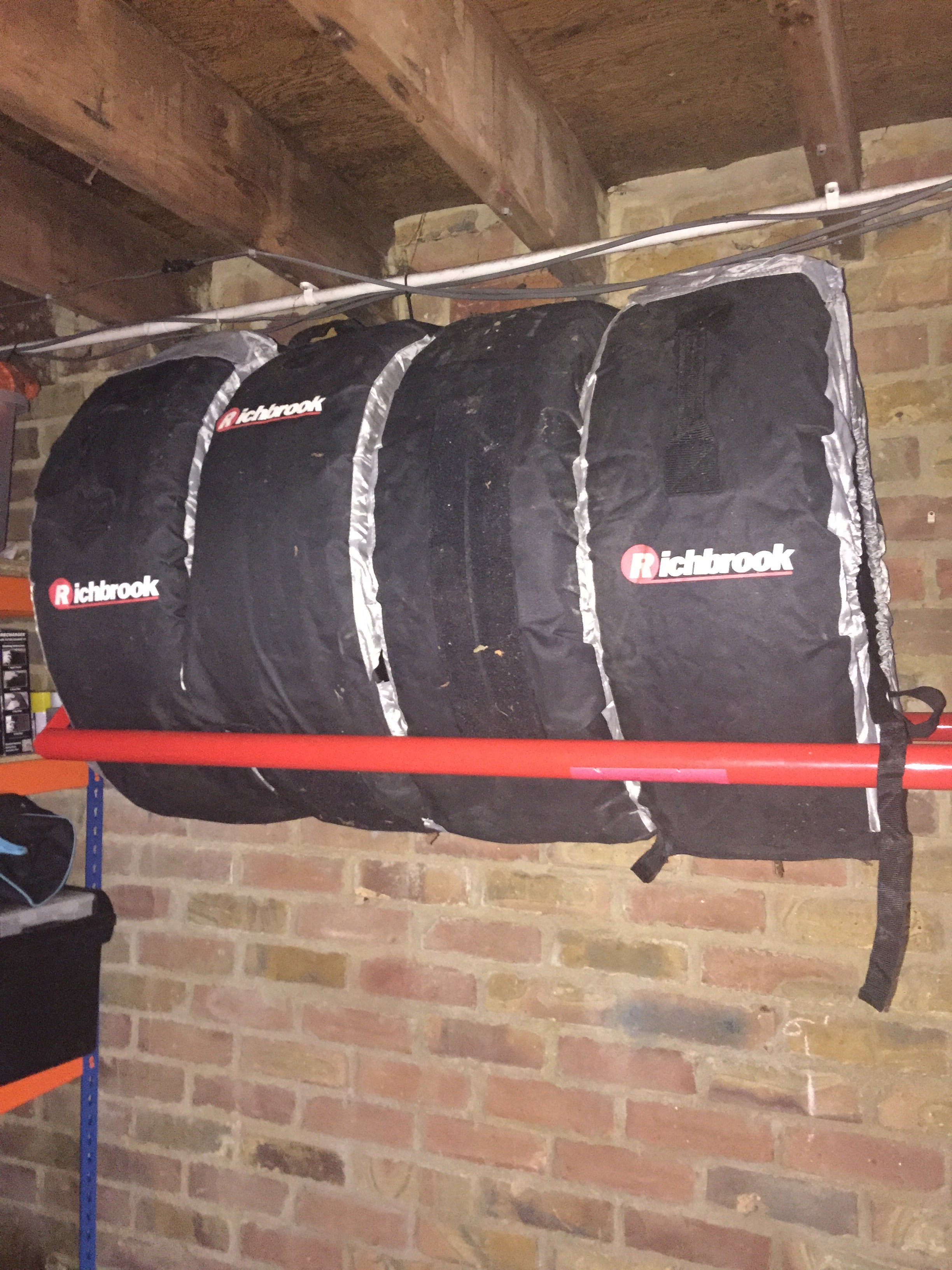

Xtreme 19 inch wheels retired to the garage until better weather arrives.
And then on with the 18 inch Gemini's shod with 225/40/18 Goodyear Ultragrip Performance. Also fitted Team Heko wind deflectors and a full set of mud flaps.
To me the car looks miles better on its winter wheels.

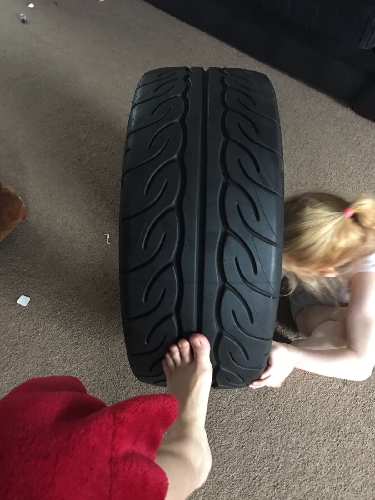

Sticky rubber has arrived

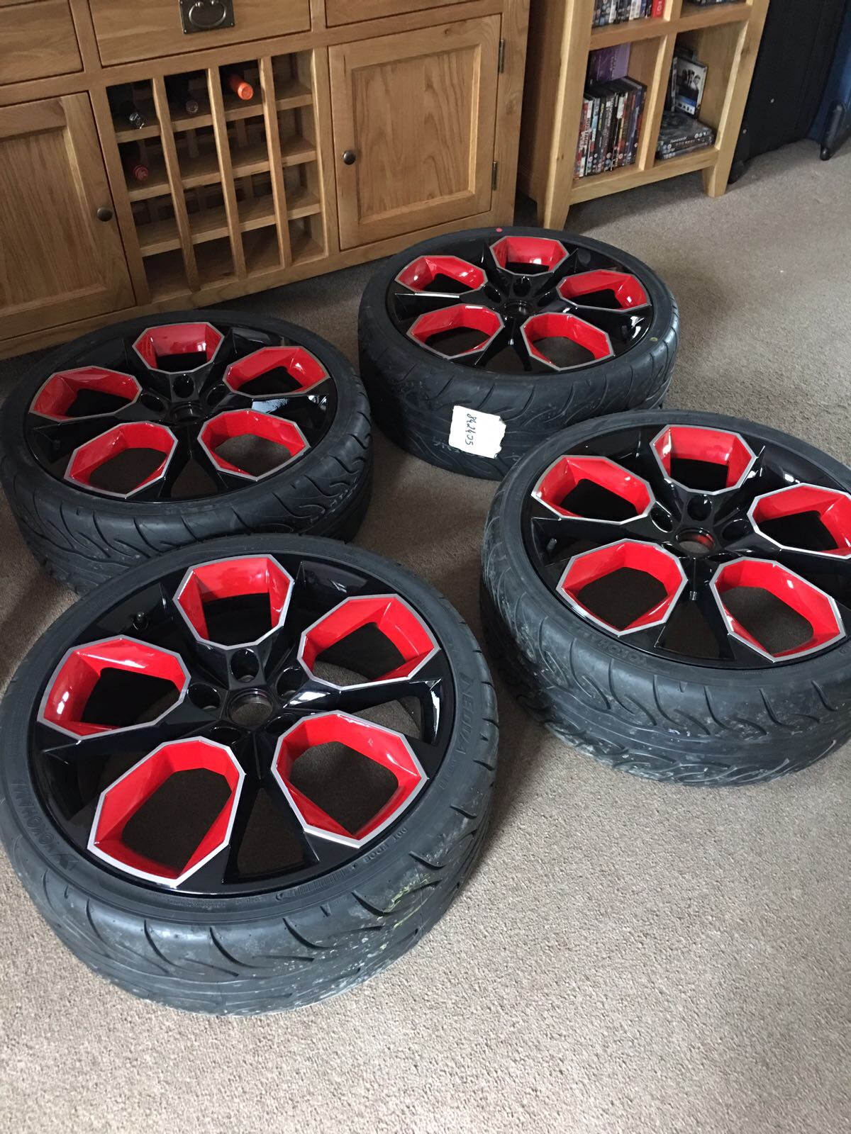

Something has happened
Mmmmmm.......I'm liking
How do you get away with Wheels/tyres on the carpet, Mrs G would cut my Ba*ls off..................
Well it is Mrs D's car and she collected wheels and put them there. She has no balls for me to cut off however so will just have to give her a jolly good telling off !
About time we had pics of them on the car! They been done for over a day now!!
Next week they will be on
I've been thinking, as the car is Mrs D's Pink might be better............
She's a red girl through and through with a hint of pink

As we are off on holiday we dropped the 230 off for some enhancements
