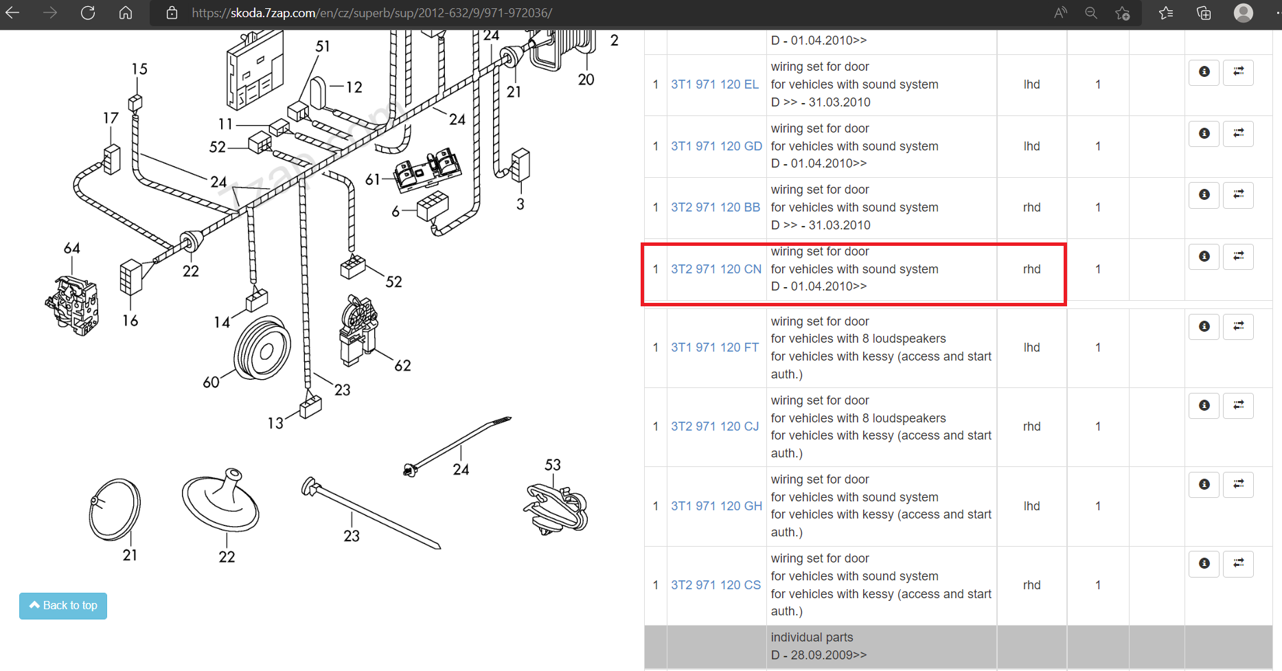

I now have tps insisting that suffix CN is correct for the L&K where i believe it should be DF, they say that DF is for a 2014 model.
  • Sponsor
What's the rest of the part number you're referring to? They should be well placed to know what's what, to be fair.
3T2 971 120 CN
  • Sponsor
VAG 3T2971120CN wiring set for door Škoda genuine OEM part (oemwolf.com)
Not showing as having been superseded by any other number in the above link.
Also skoda-parts.com page for that number shows a bunch of equivalent numbers that doesn't include a suffix DF variant:  Electrical Wiring Installation Bundle for the Door Škoda 3T2971120CN (skoda-parts.com)
Why do you think it should be DF?
Parts catalogue for 2012 Superb doesn't seem to offer DF either? There are a couple of other options for RHD cars though, CJ and CS, not sure what's different between those two.
 single parts whitch are not included with the par... - Superb(SUP) [EUROPA 2012 year] (7zap.com)
