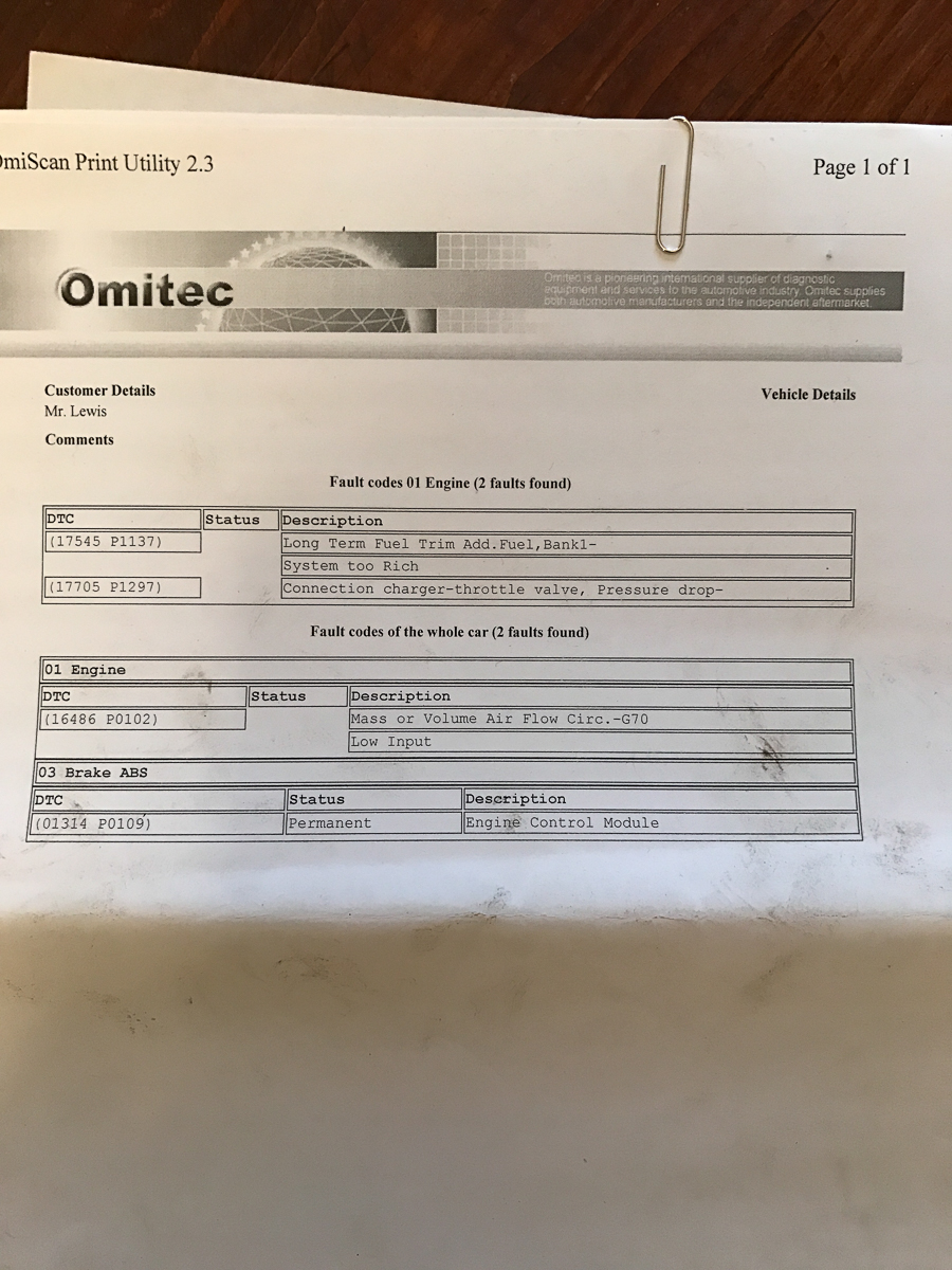

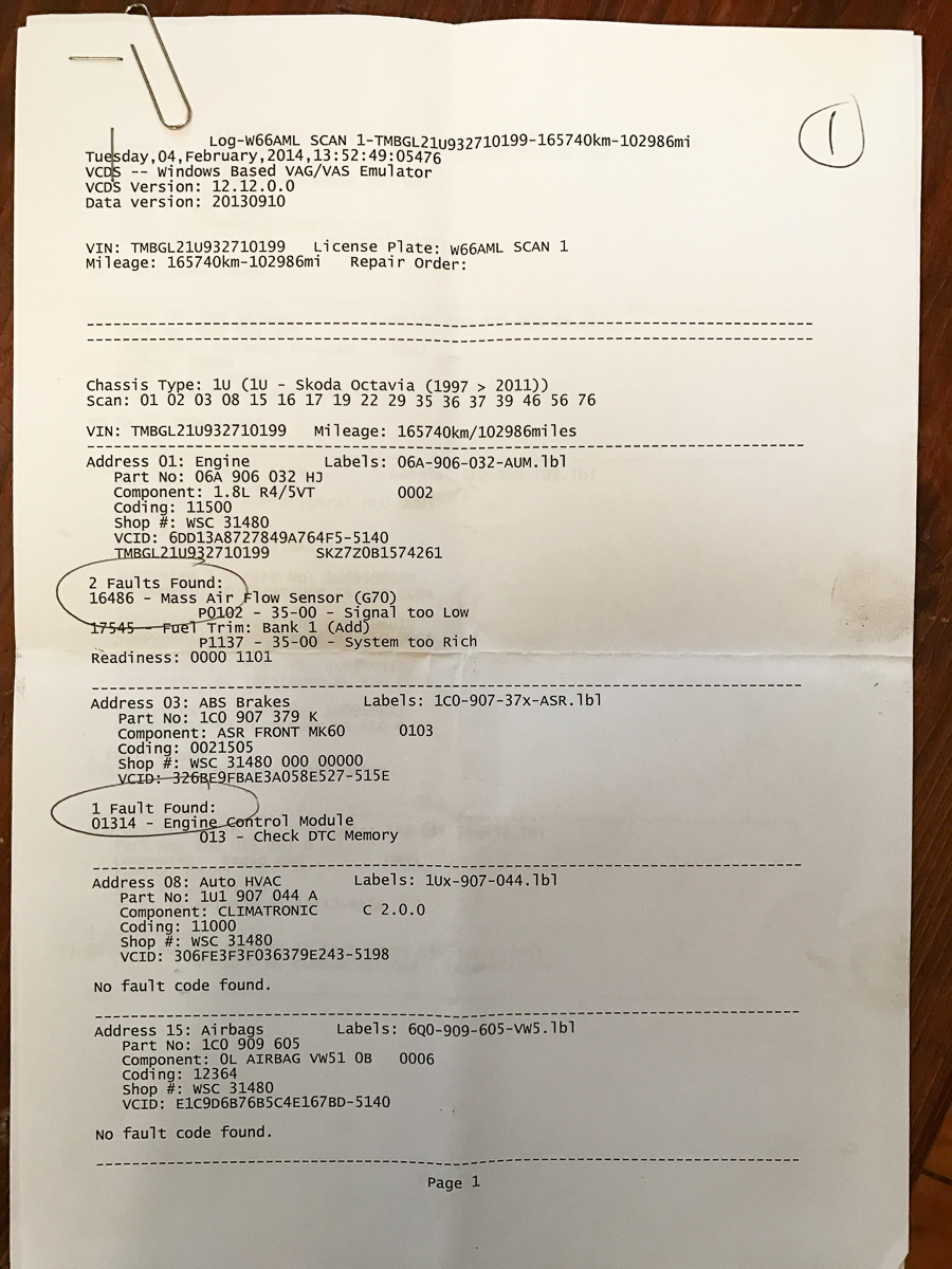

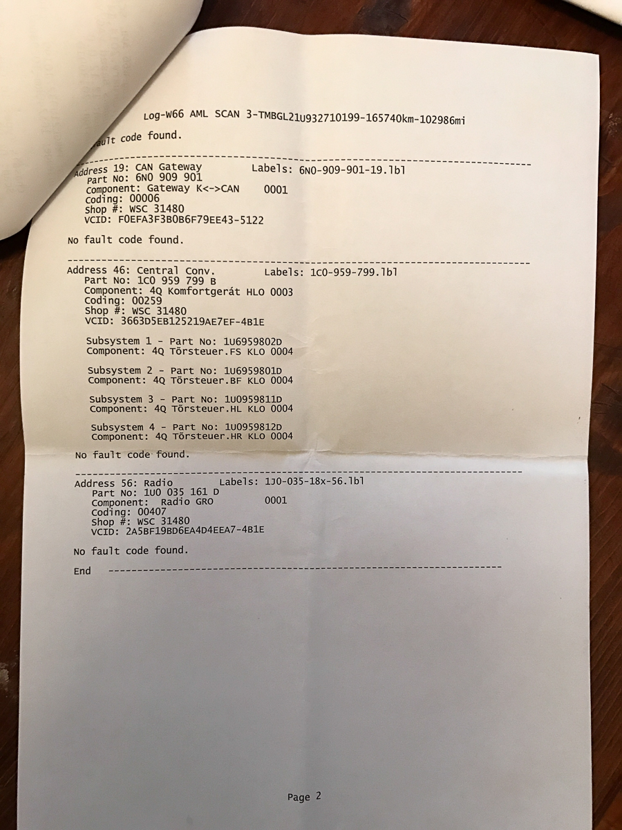

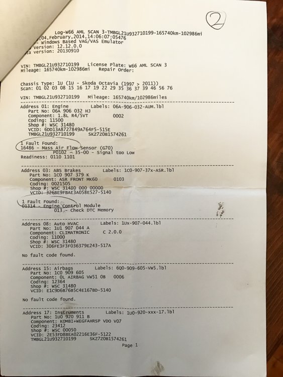

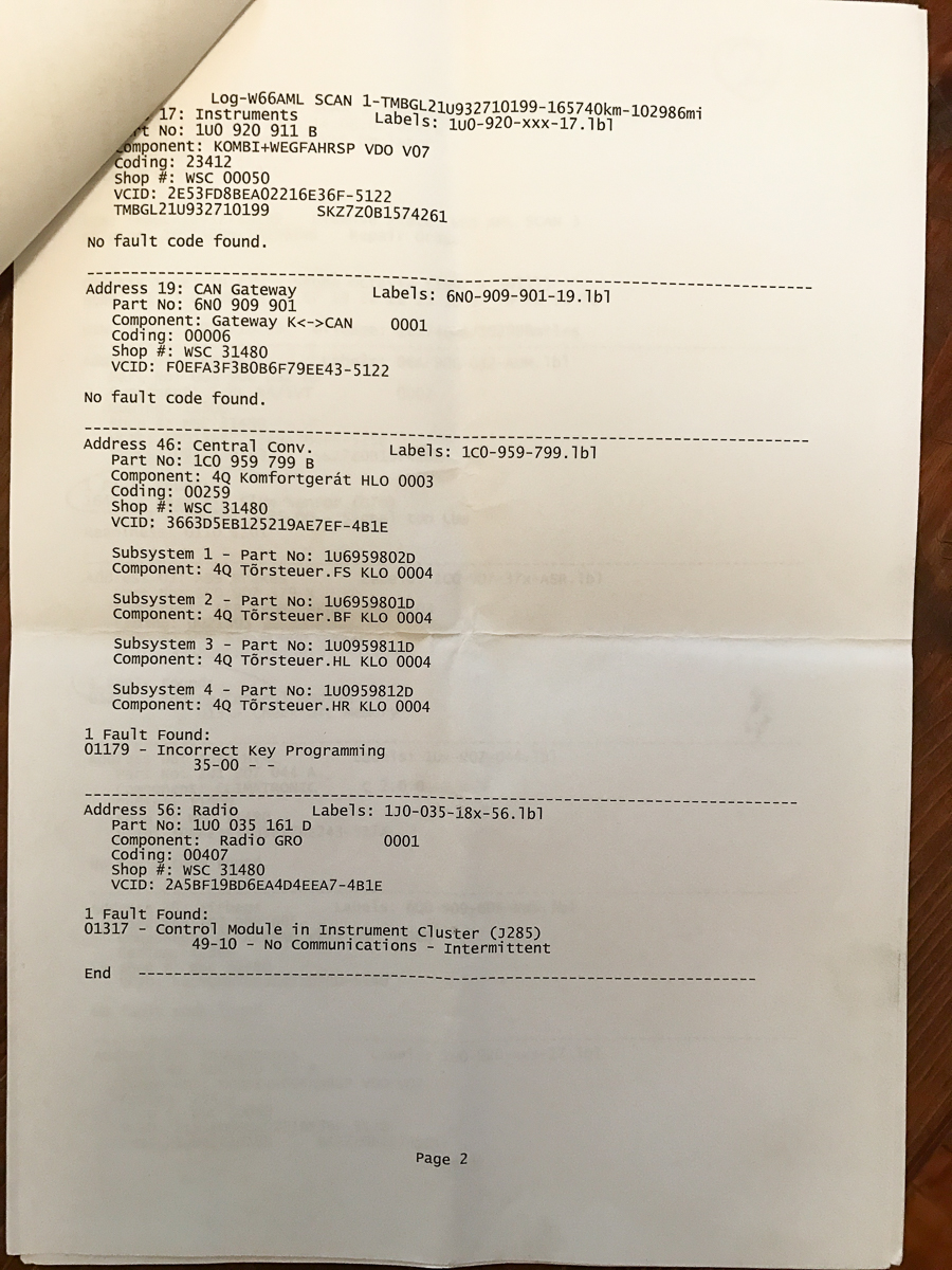

I have gone through all the paperwork from when this has been checked out in the past and I have found a bunch of engine codes that I will upload images of to see if collectively we can make some sense of what direction I can pursue next.
What would be the gold-standard MAF that I could try just to really guarantee that it is definitely not the issue? (seeming less and less likely).
These are all the codes mentioned in my car's service history. It mentions "instrument cluster", which sounds like it could cause perceived sensor mayhem?
The scans can only really tell what was wrong with the car at that time. assuming they rectified the fault then the codes would have been cleared.
You really need to know what codes if any are on your car now. One of those codes can appear if the ECU has been remapped, has you car been mapped?.
It is ex-police but I don't know if it has been mapped. I was trying to find out...
Which code suggests it could have been mapped?
