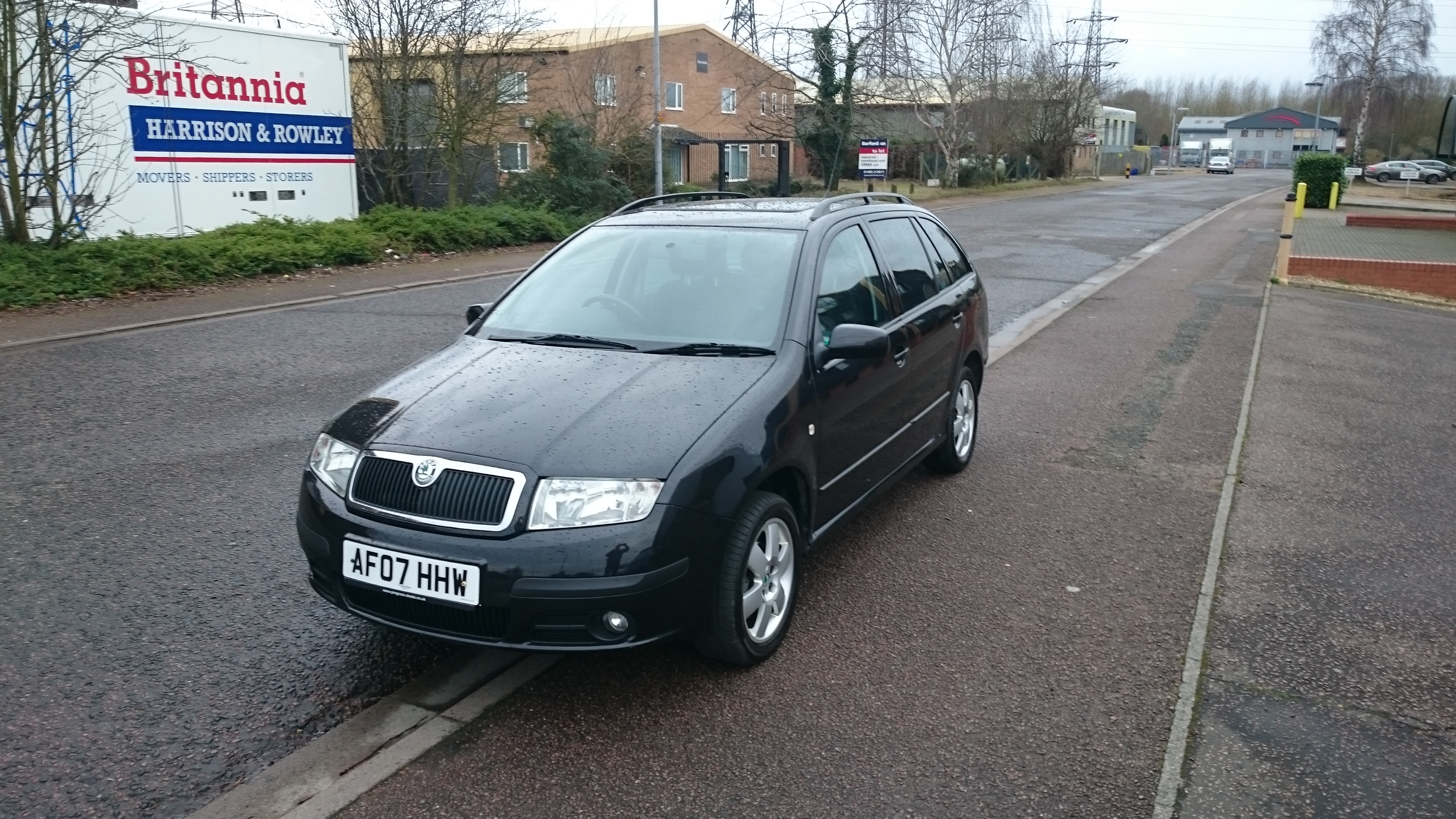

This topic is right up my street. I'm looking to get my Fabby estate looking a bit better and improve greatly in the handling department. I'd like to upgrade the wheels to BBS 'Montreal2's (16 inch) and then lower the car. I was shocked at just how noisy the car is on the low profile tyres, and how much vibration is passed through the car when driving on unsettled surfaces. I'm sure adding 16 inch wheels over the 15 inch wheels that I currently have will make this worse, correct? Would it be worth adding spacers and keeping the original wheels? Are the spacers expensive?
And as my car has only done 54k, could I get away with just buying the pro kit springs and use the old shocks? The car was fully loaded this afternoon for a trip down the tip and its bum was on the road! Worn rear shockers, maybe? Thanks.
Edit :I've added a picture of my 'black rollerstake' for reference!
