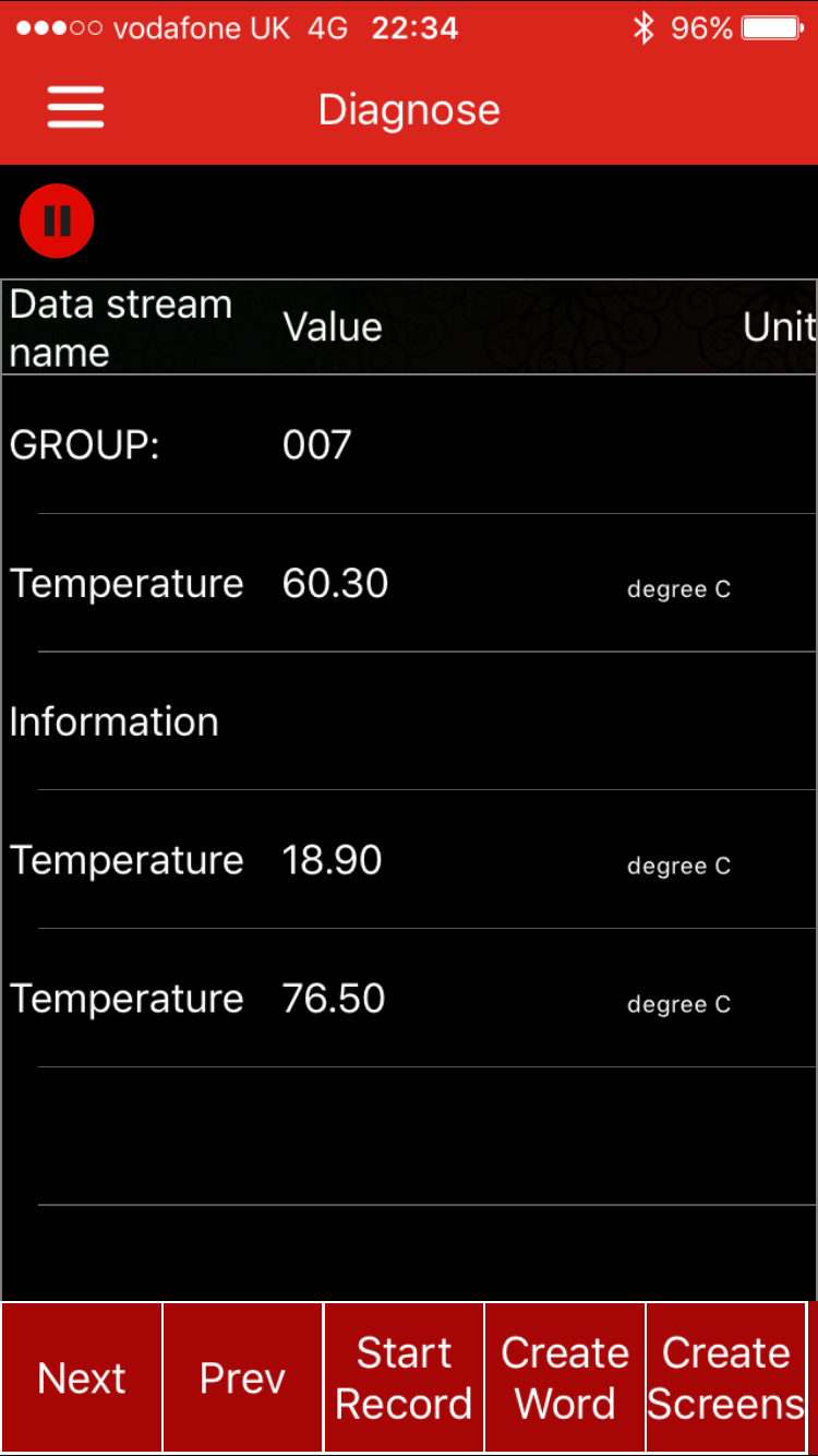

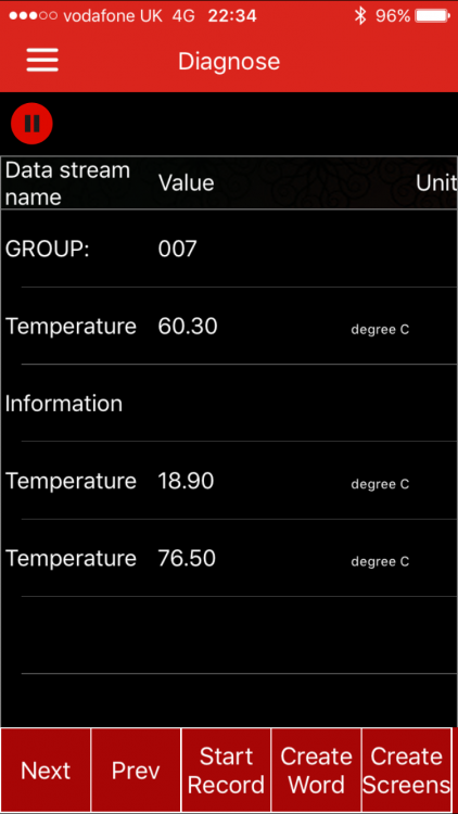

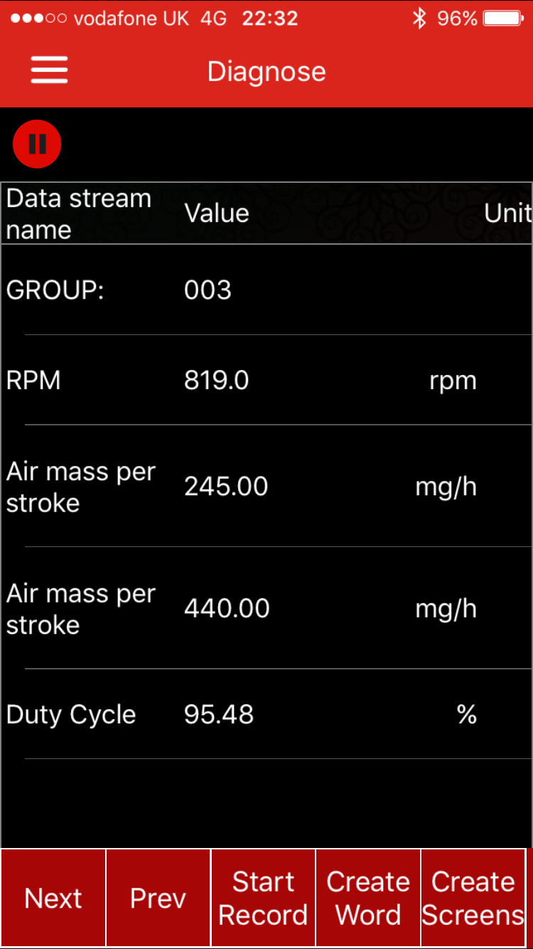

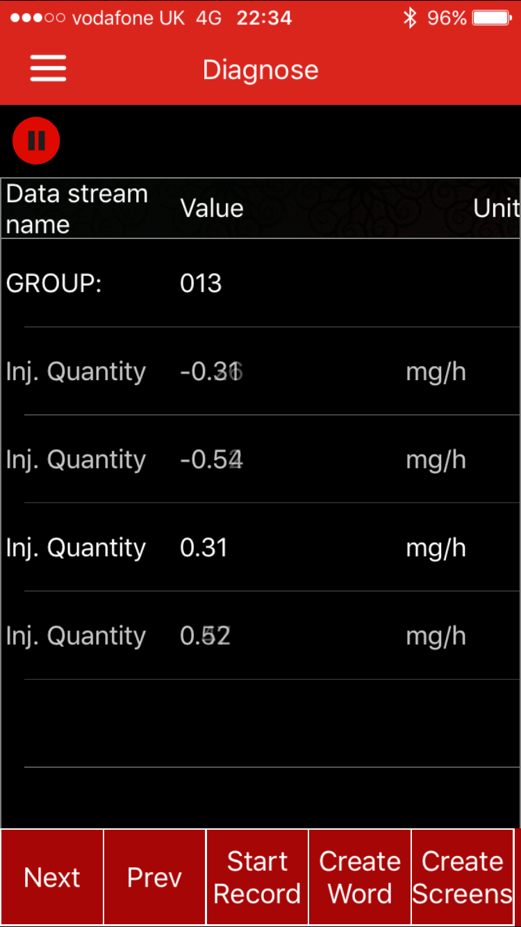

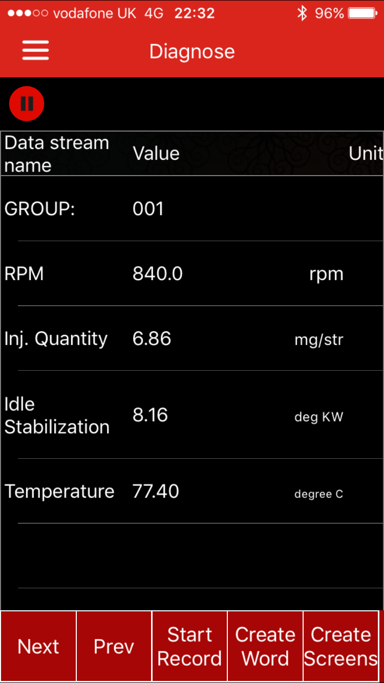

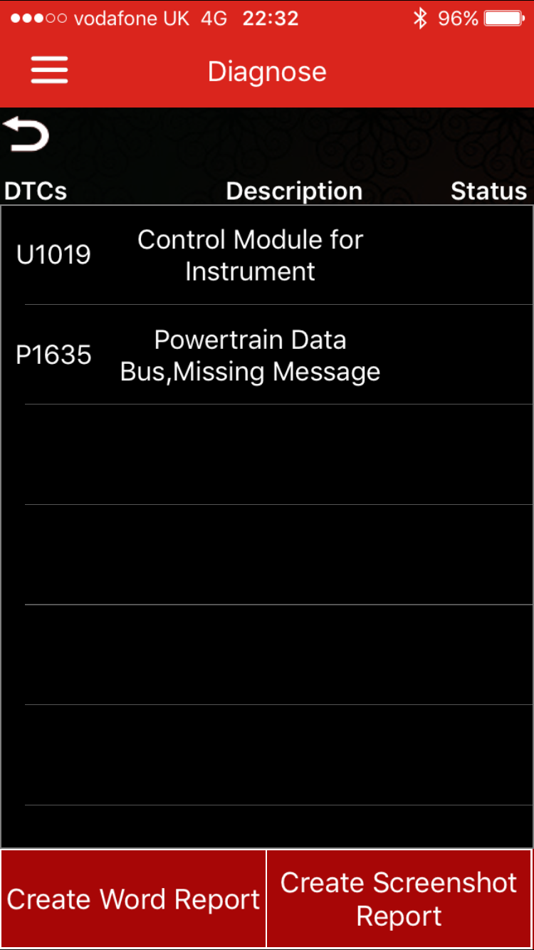

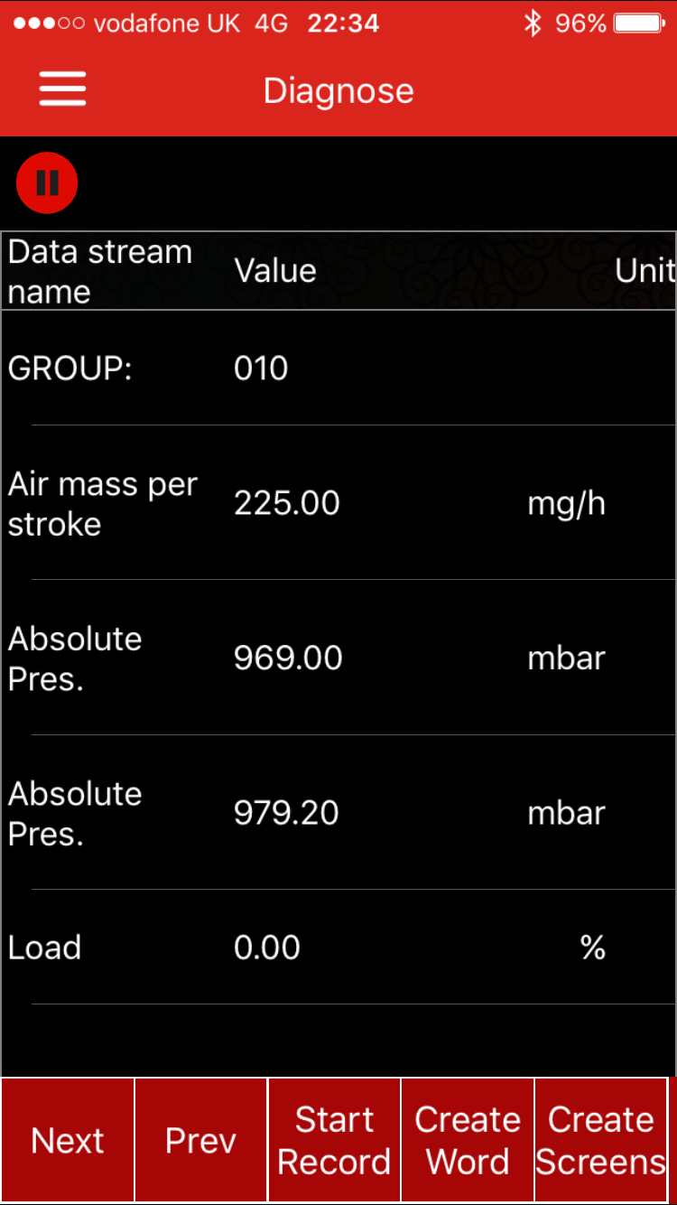

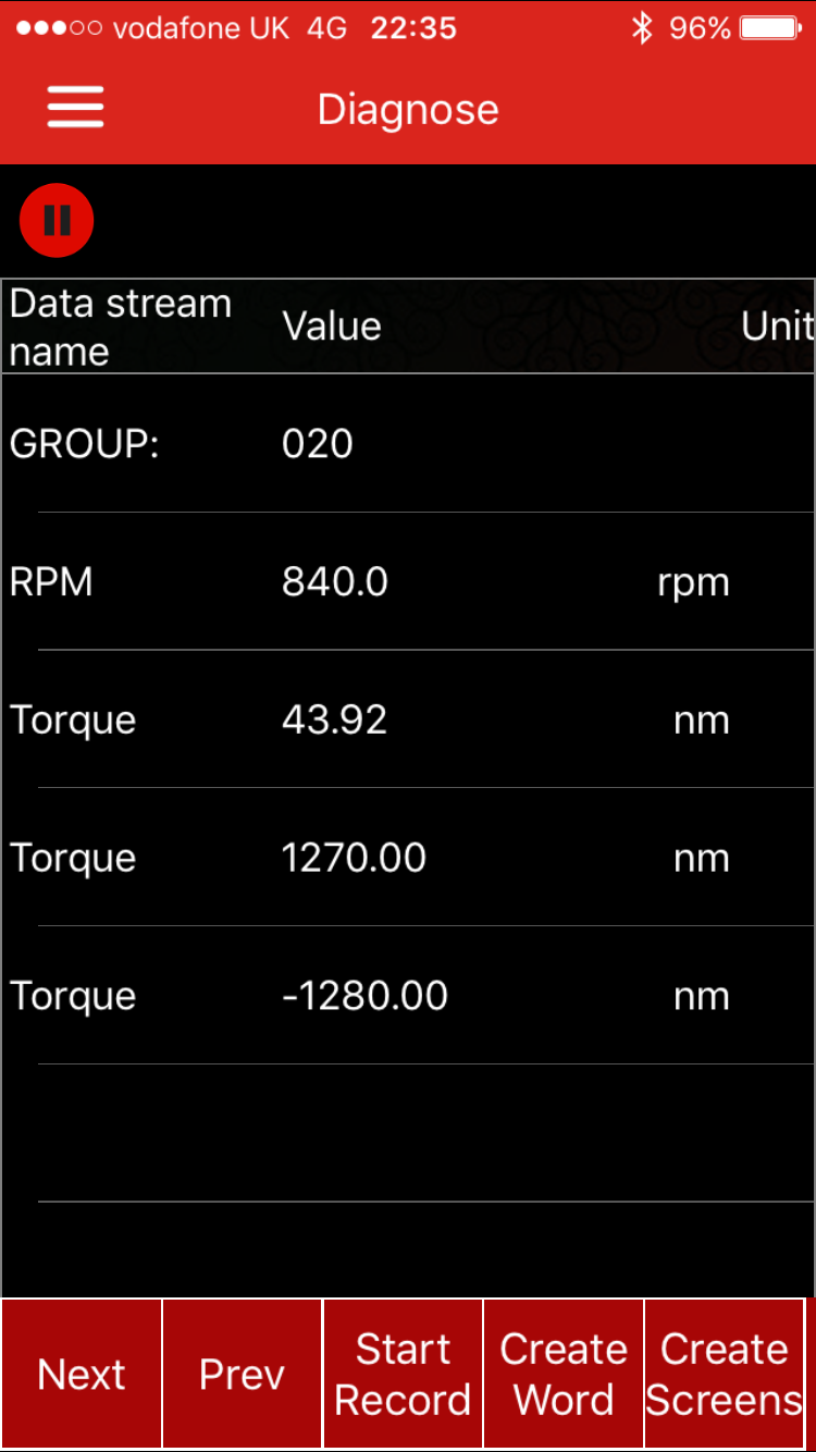

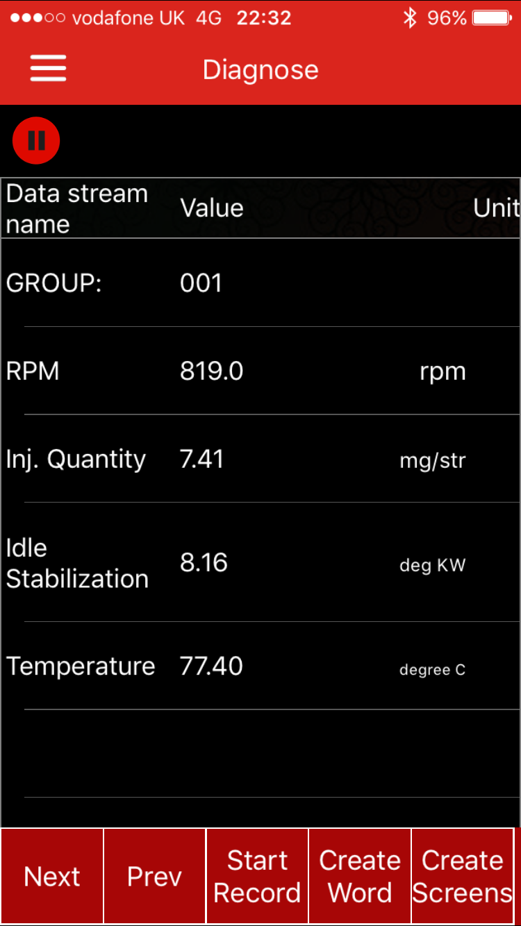

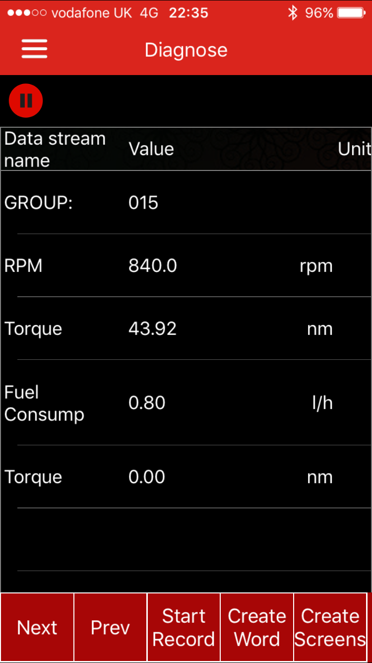

I have decided to run on motorway for one hour and town driving without turning the engine off and plugged it on diagnostics and took some readings out so im attaching screenshots
all the screenshots were taken while idle and everything off like climate and lights.
Don't you think the temp values are a bit low? 60 & 76C? I'd expect more like 90+ after M-Way and town driving. Not sure what those values are from? Maybe Fuel and Coolant?
Yes its fuel and coolant temp

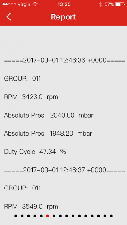

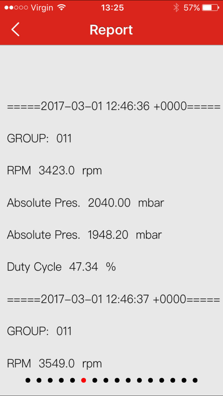

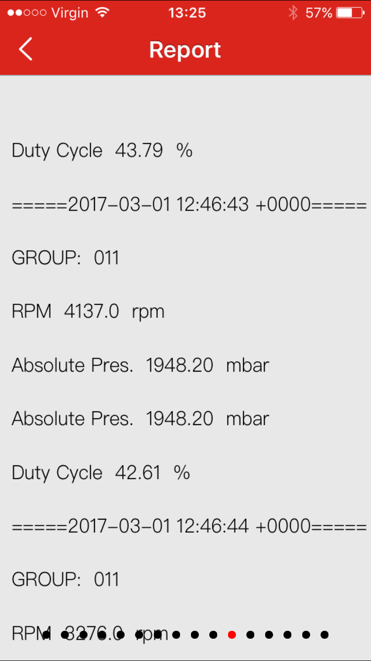

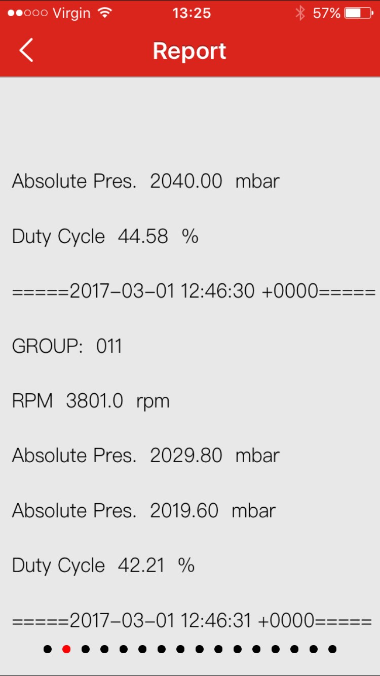

Can your reader do boost logging? Would be interesting to log the actual vs requested boost and see if they match.
4 hours ago, Phil-E said:
I was going ask how it was on full throttle.
Although it's only 105bhp you should still get a decent punch from it with peak torque around 2000rpm.
Mine never really produced any noticeable smoke. The only time I could see any smoke was at night in the headlights of following cars but only if using a bit more throttle. Even then it wasn't like thick smoke just noticeable in the air. On light throttle and taking it steady I couldn't see any.

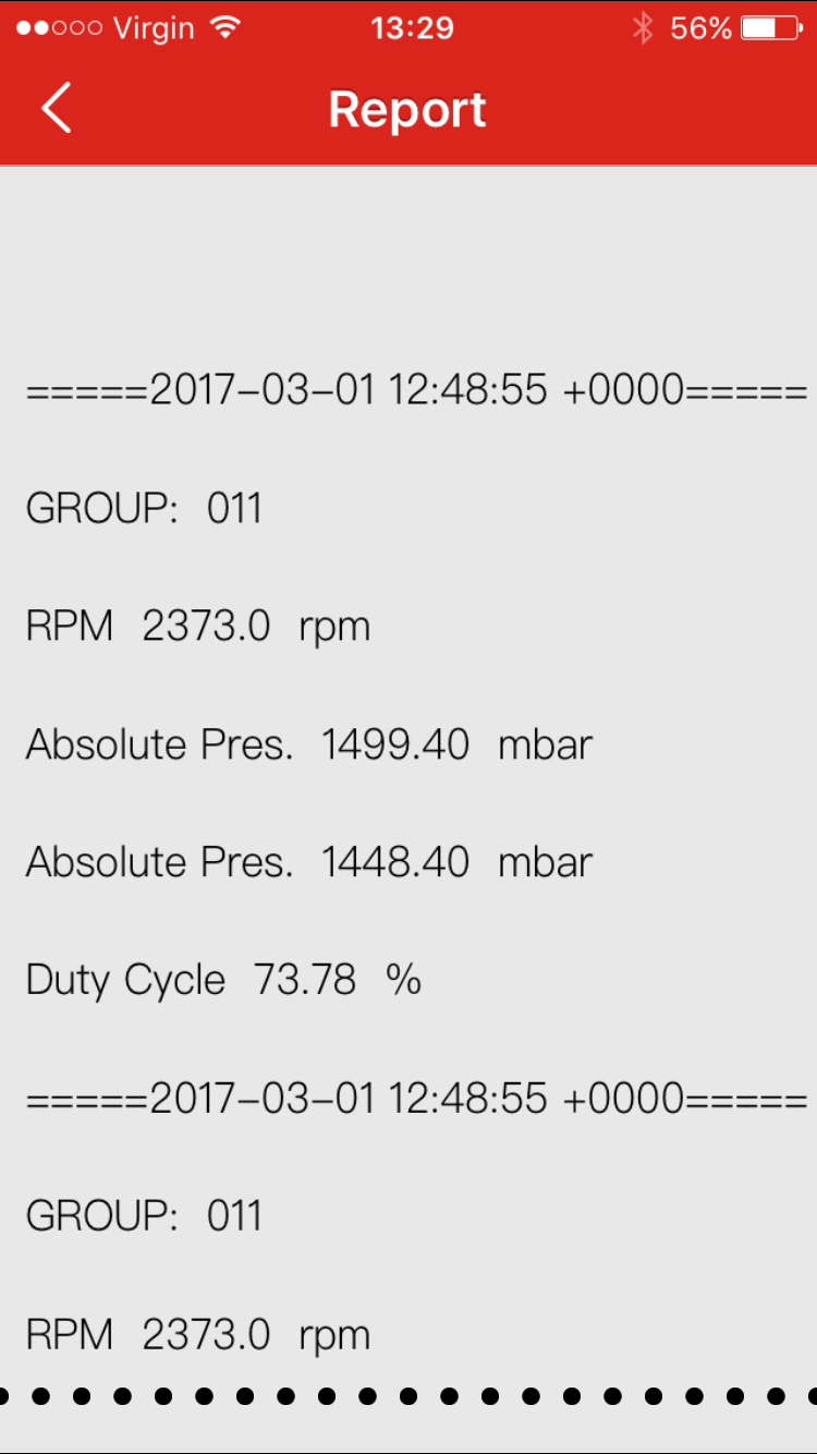

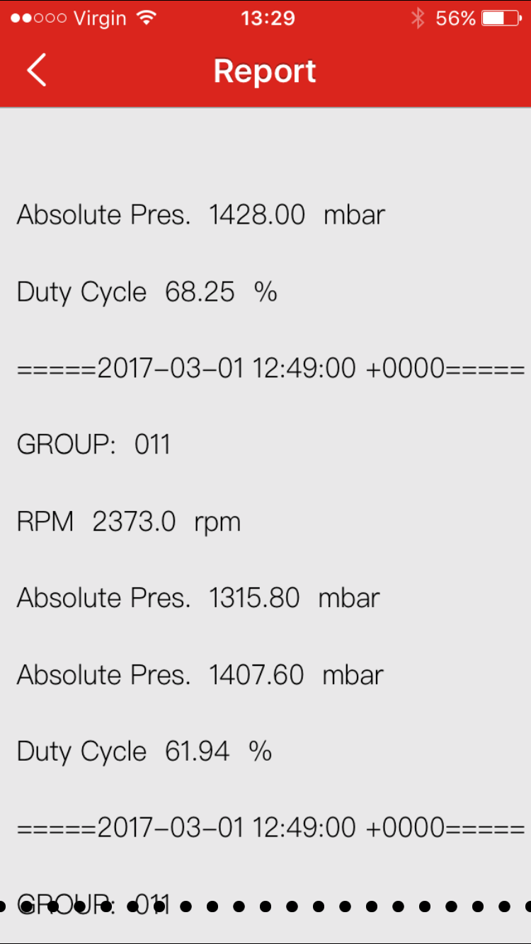

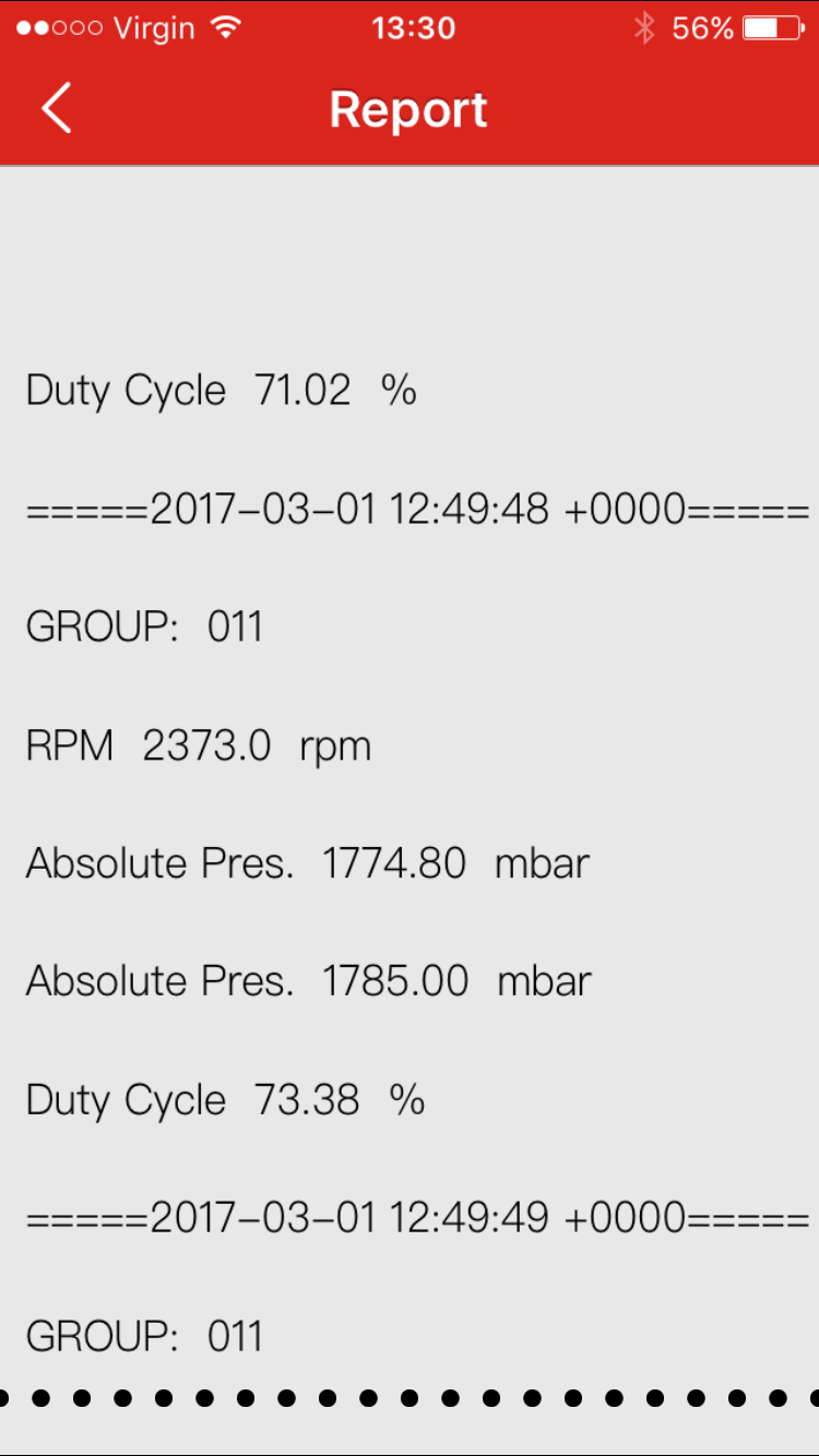

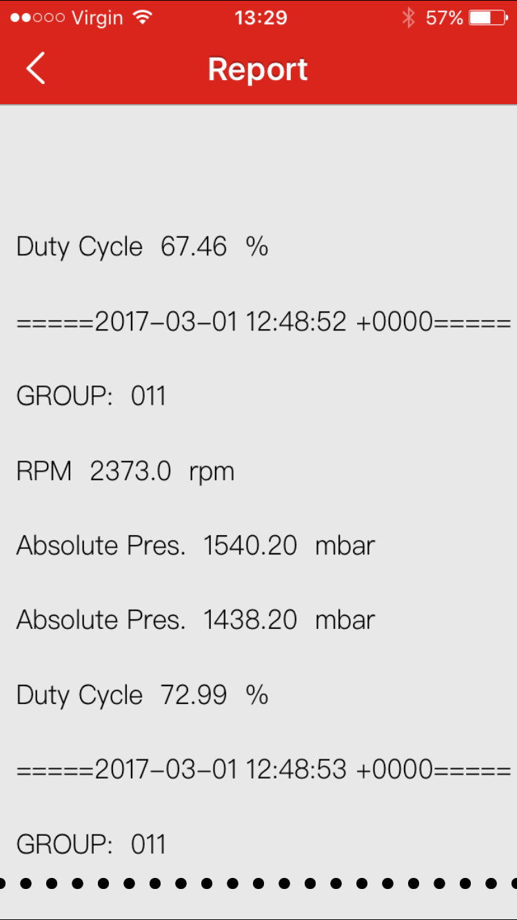

Just cleaned the turbo with mr muscle. Much better it pulls nice now.

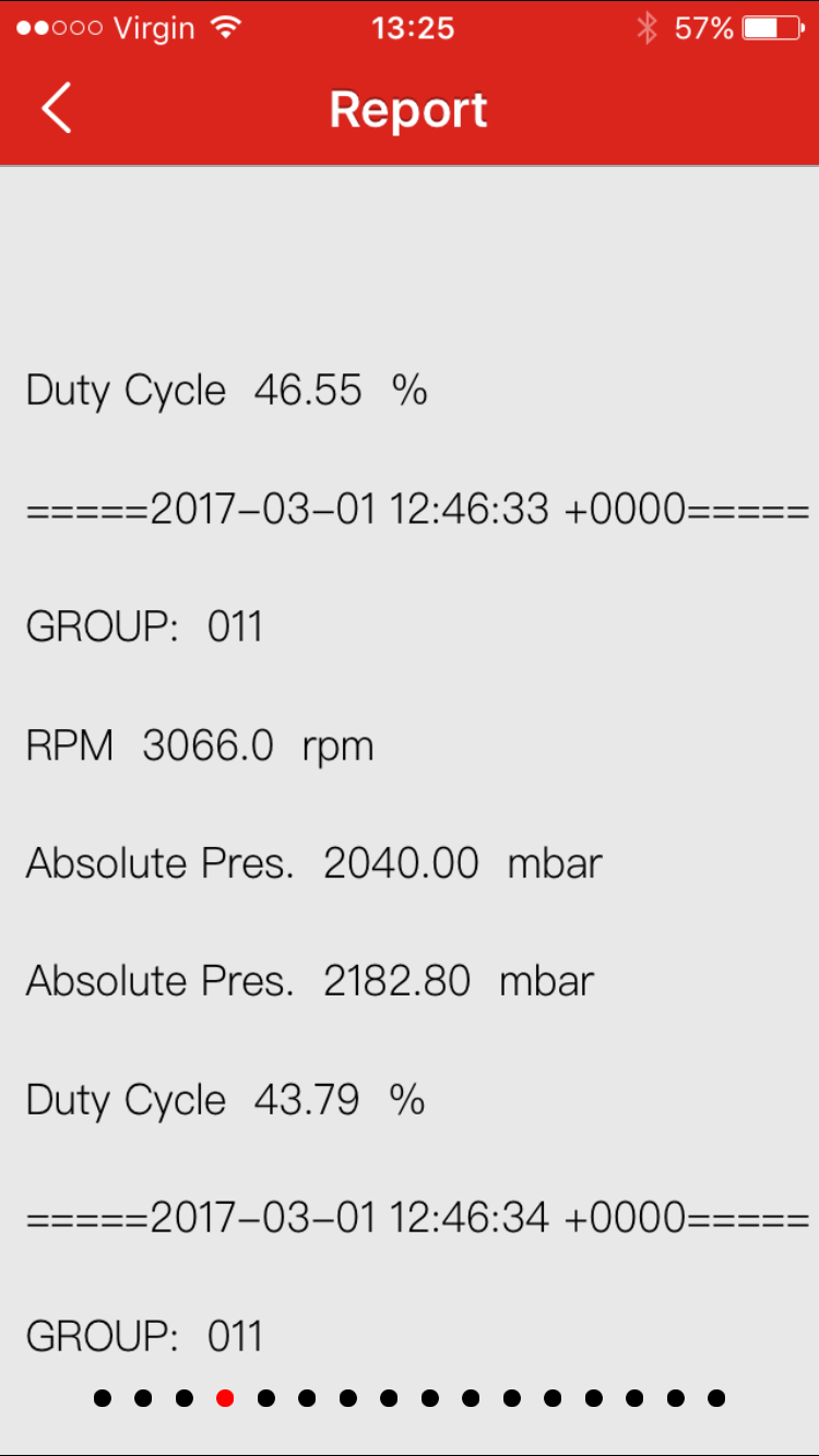

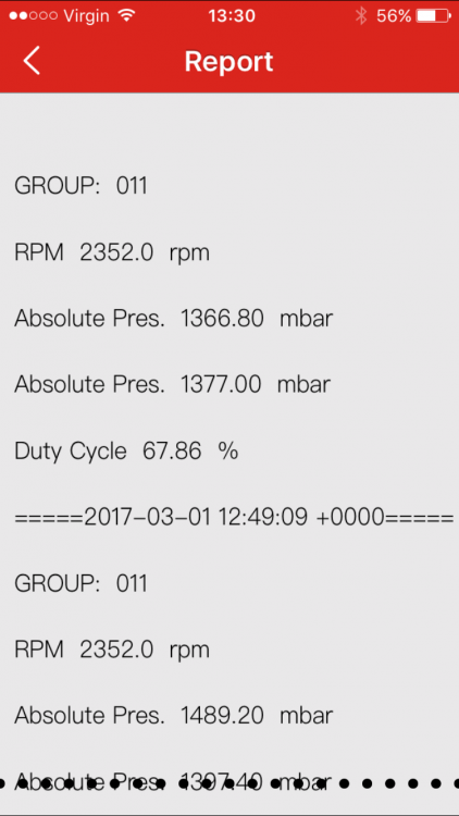

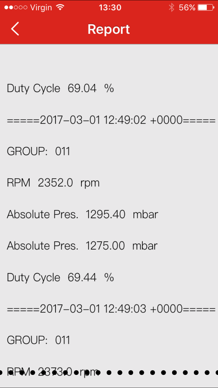

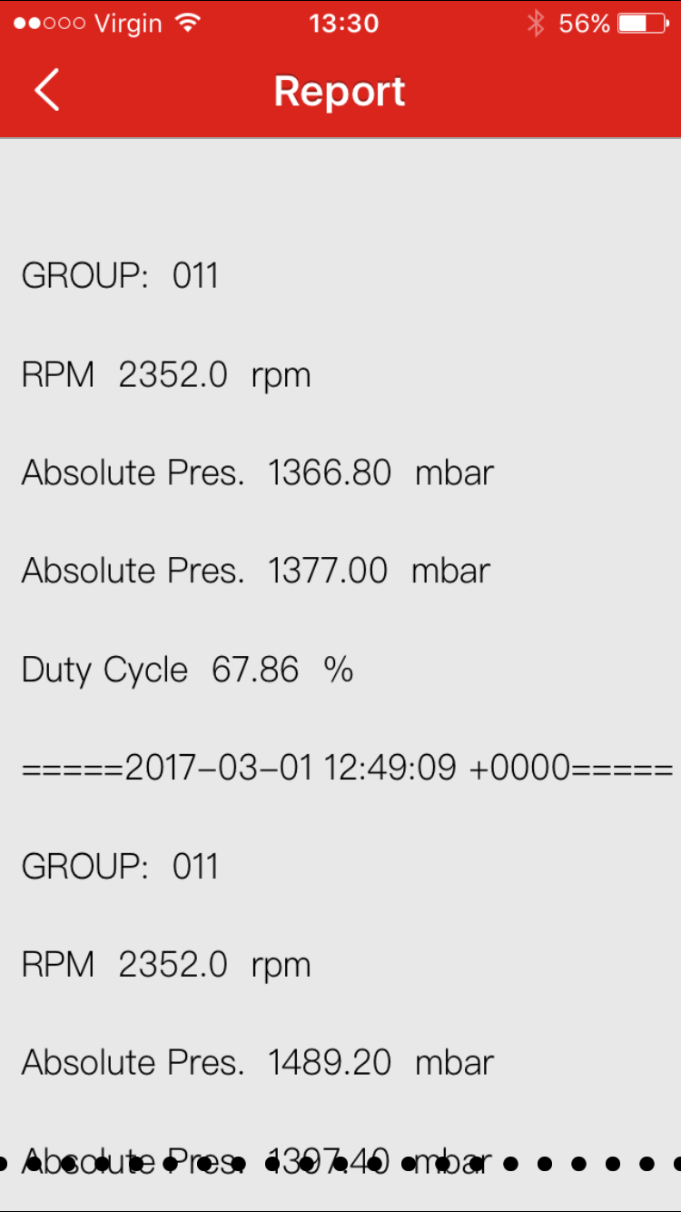

Here is the screenshots
first one is requested
second one is actual
Thats full throttle

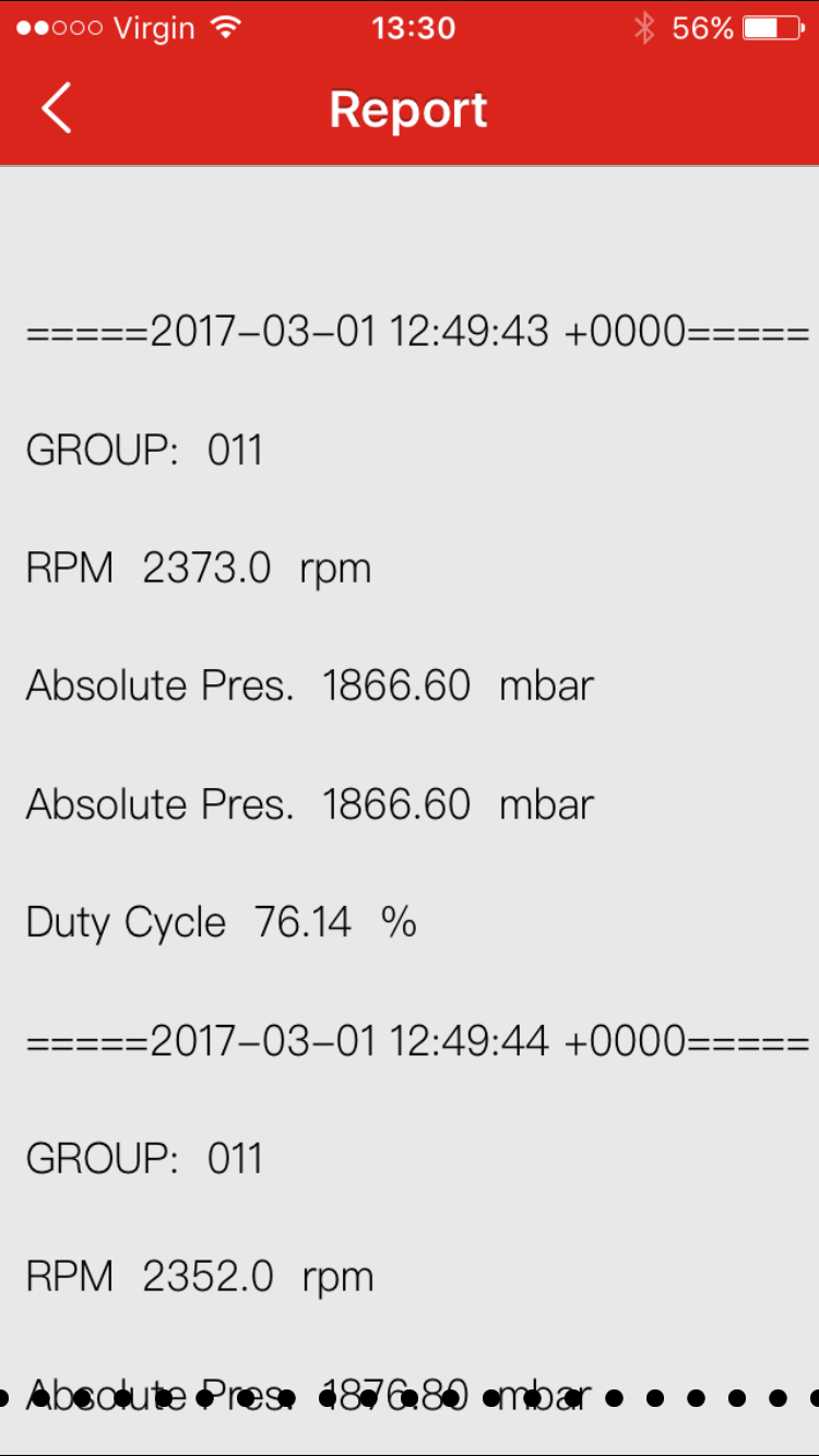

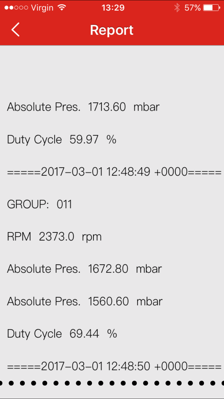

next post will be 70mph on cruise control on motorway
Thats the 70mph on cruise
im heading to work in a min so i will keep you updated with 32miles result
im getting ****ed of with this car now.

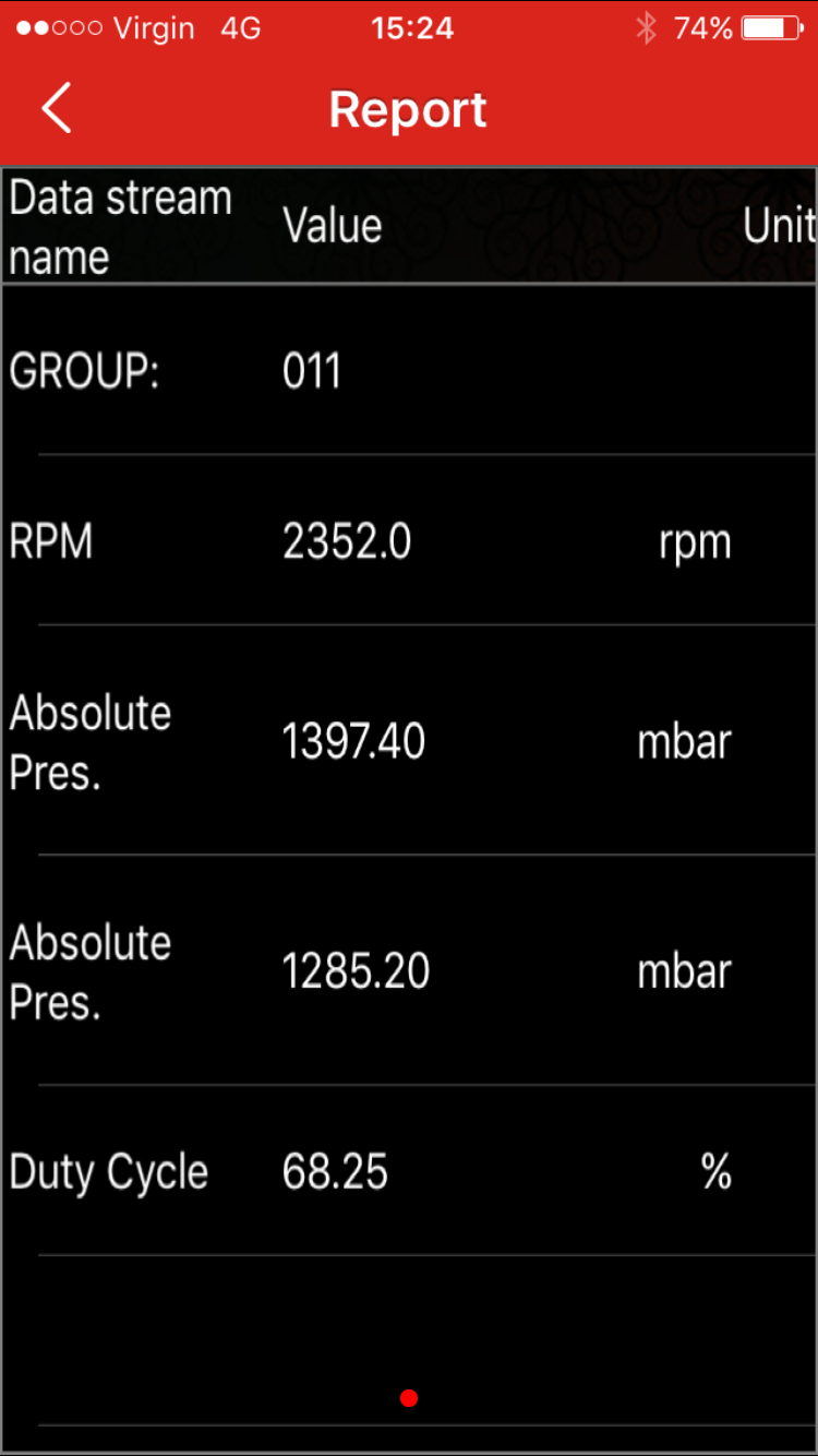

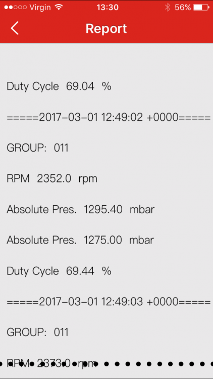

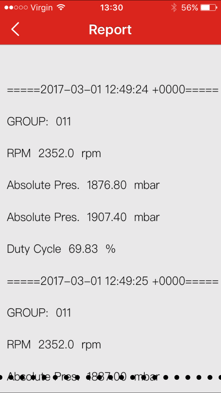

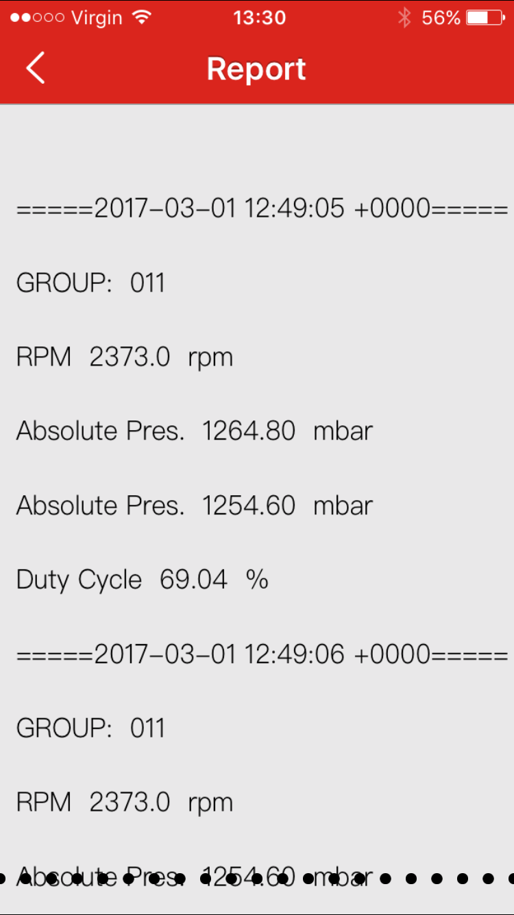

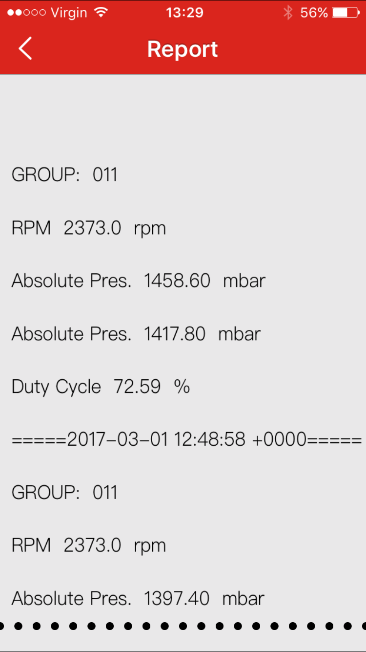

When i tested it 1sttime the car was like a dream. Pulled home. Uploaded the pictures. Went to pick my friend up went on motorway and the car is same again. Feels like im towing someone. From 70 to 90 takes forever. Went of the motorway thru normal traffic car seemed like im towing. Stopped at traffic lights. Booted it and its boosting like on the test run.
I have taken screenshow while doing 70 "towing a lorry"
first one is doing 70
the second one is from 70 flooring it to max.
Any clues ?
That really sounds like classic sticking turbo veins.
