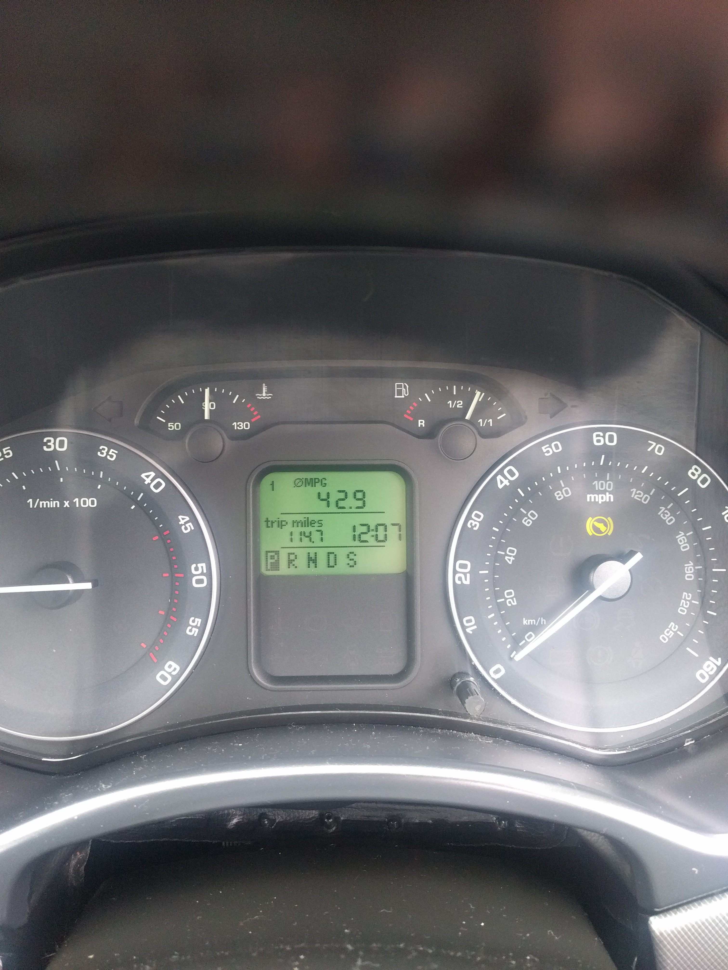

Bought new maf sensor.
Went on a motorway run today doing 75mph all the time on cruise.
Avg 42.9 mpg.
Done 114.7 miles
Quater tank gone
I had one little bar on fuel gauge down when i left.
This is only motorway miles. My house is 1 mile from the house.
At what revs do you change gear?????......Gives us an indication of your driving style.
1/4 tank did 115 miles so full tank similar driving should do circa 460 miles. Not good really, and I always think the first quarter of the tank seems bigger than the last quarter, Lol.
And are you sure yours is an elegance???? I ask as mine (55 plate) is just older than yours, but has the full height maxidot. Curious!

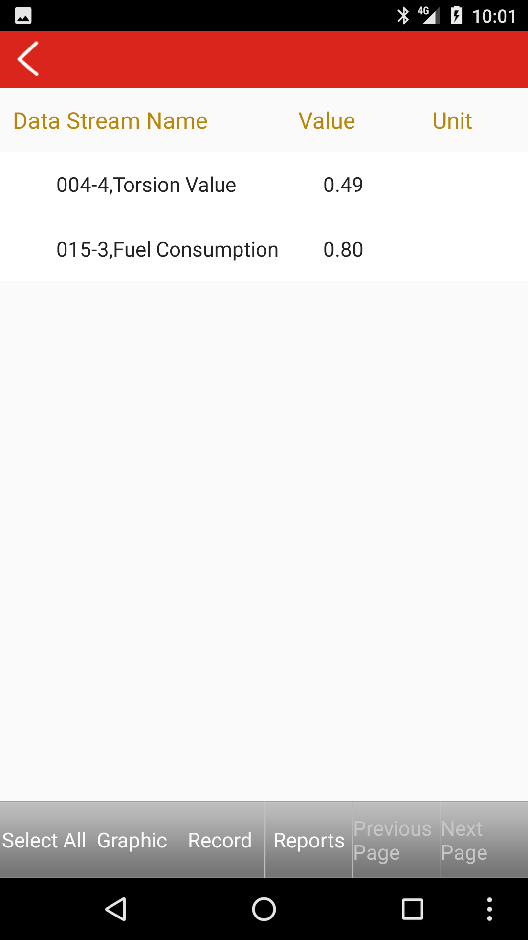

Ok its not intercooler. I have checked cambelt and it was replaced last year by skoda dealership and they set the torsion wrong. It was showing -1.47
Ive set it up to 0.49 and i can feel and see the difference. Only problem I have now is the idle fuel consumpsion which is at 1.0 mostly jumping 0.8-1.0
Before i started it was at 0.8
Should it be at 0.4 ?
Keep in mind mine is dsg so i dont know if it makes a difference

Well i moved the torsion to 0.49. It improved by around 4mpg but the starting is rubbish when hot like the engine would jump out.
Do you reckon whoever changed the cambelt could miss the timing by one tooth ?
