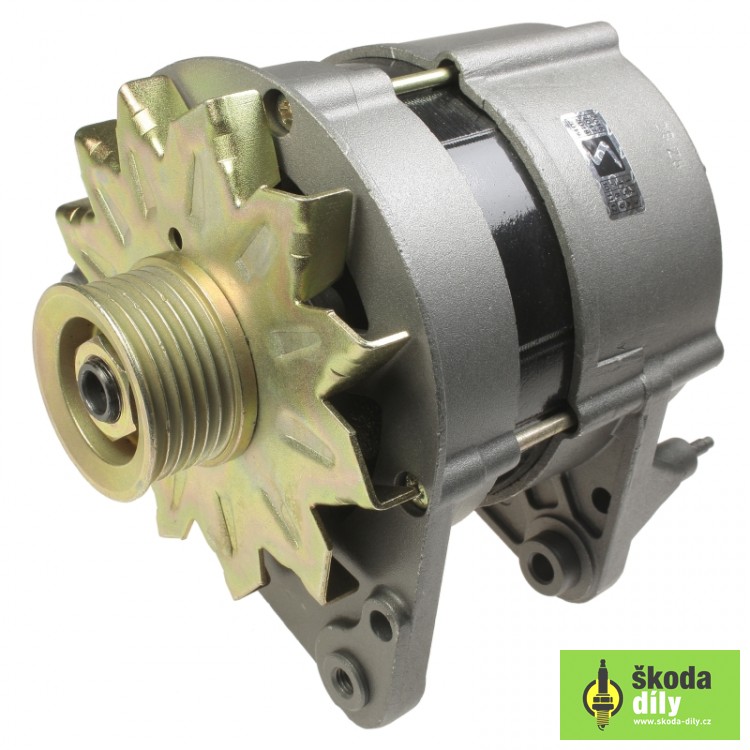

Hi, Sorry for bothering with this, but what kind of an alternator do you have there?
This engine have AC or power steering. Those have 90A alternator with different mounting, which should be compatible with other VAG alternators.
I am about to install AC in my 1.3 MPI Felicia but i thought they all came with this alternator
Képtalálat a következÅre: âfelicia alternatorâ
Although the one in the picture of Aree looks like those more modern Bosh ones. The ones which came with the 1.6 l engine.   Its just interesting cause those seems to be  easier to find second hand.   I almost have everything together for the ac setup except the this alternator with the right 6pk pulley.
Yes, mounting is compatible with other VAG alternators from Bosch (Atleast that's what they say HERE). On the photo is alternator from Felicia 1.6.
