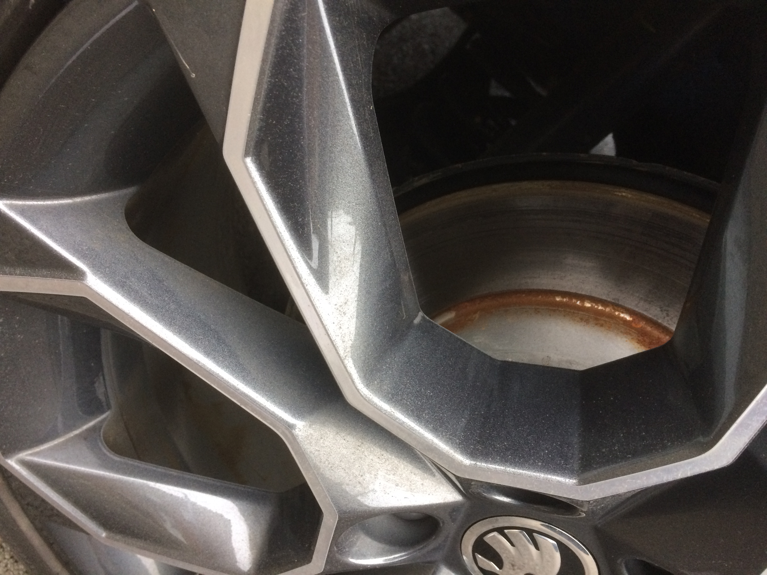

I have had my Octavia vrs for about six weeks now from brand new. After about four weeks I noticed rust on the drums of the disks, are the disk drums supposed to be coated in special paint at manufacture to prevent this?
Any advice would help. I am thinking of taking it back to the show room as four weeks seems too soon, I understand that they can turn rusty and due to the weather etc. I have noticed as well that the brakes make a binding noise when I apply the brakes.
Should I return the car and demand new pads and invest? Is it covered by warranty as it's not normal wear and tear.

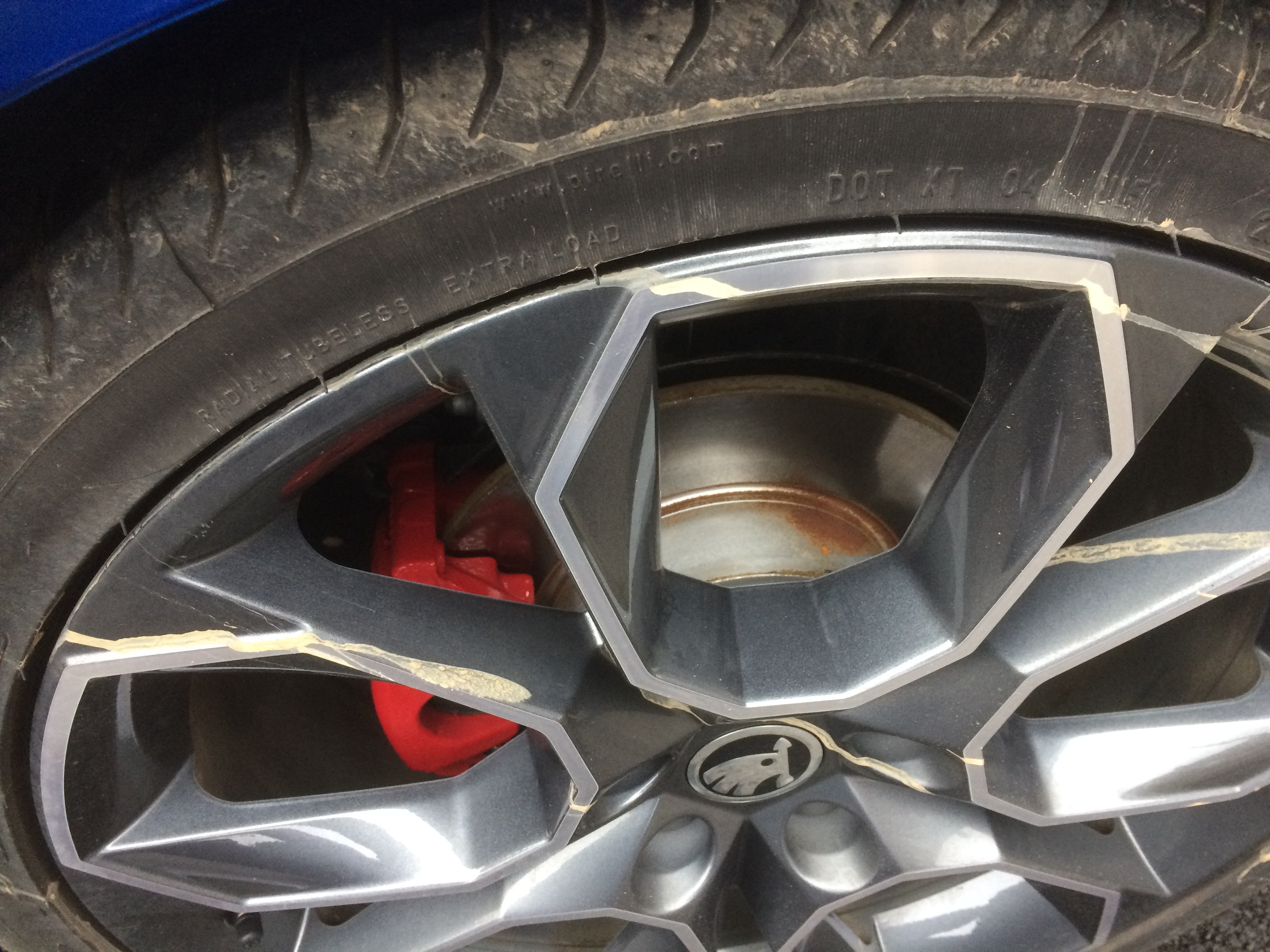

Look at the pictures taken at four weeks from new.
The dealership are unlikely to take you on. The rust is normal even after this short time, especially this time of year. And on top of that, you don't know how long your car might have been sitting around outside before you got it.
The "binding noise," depending on the mileage you've done, should go away as you bed in the brakes more. However if you've done a few thousand miles already, it might be worth checking if any of your wheels are binding, ie; jacking up a corner and spinning the wheel with your hand. If any of them are stiff to turn then you can go back to the dealer and ask them to look at it. Either that or test it by driving the car forward at low speed for a short distance then just let it roll to a stop. If there is a binding brake, it will probably stop nearly immediately, if not it should roll to a nice gradual stop.
Hope this helps you.
As above this is normal, mine have the same marks. I must say though they rust more than other diskes i have had in the past. There also noisy disk pad combination.

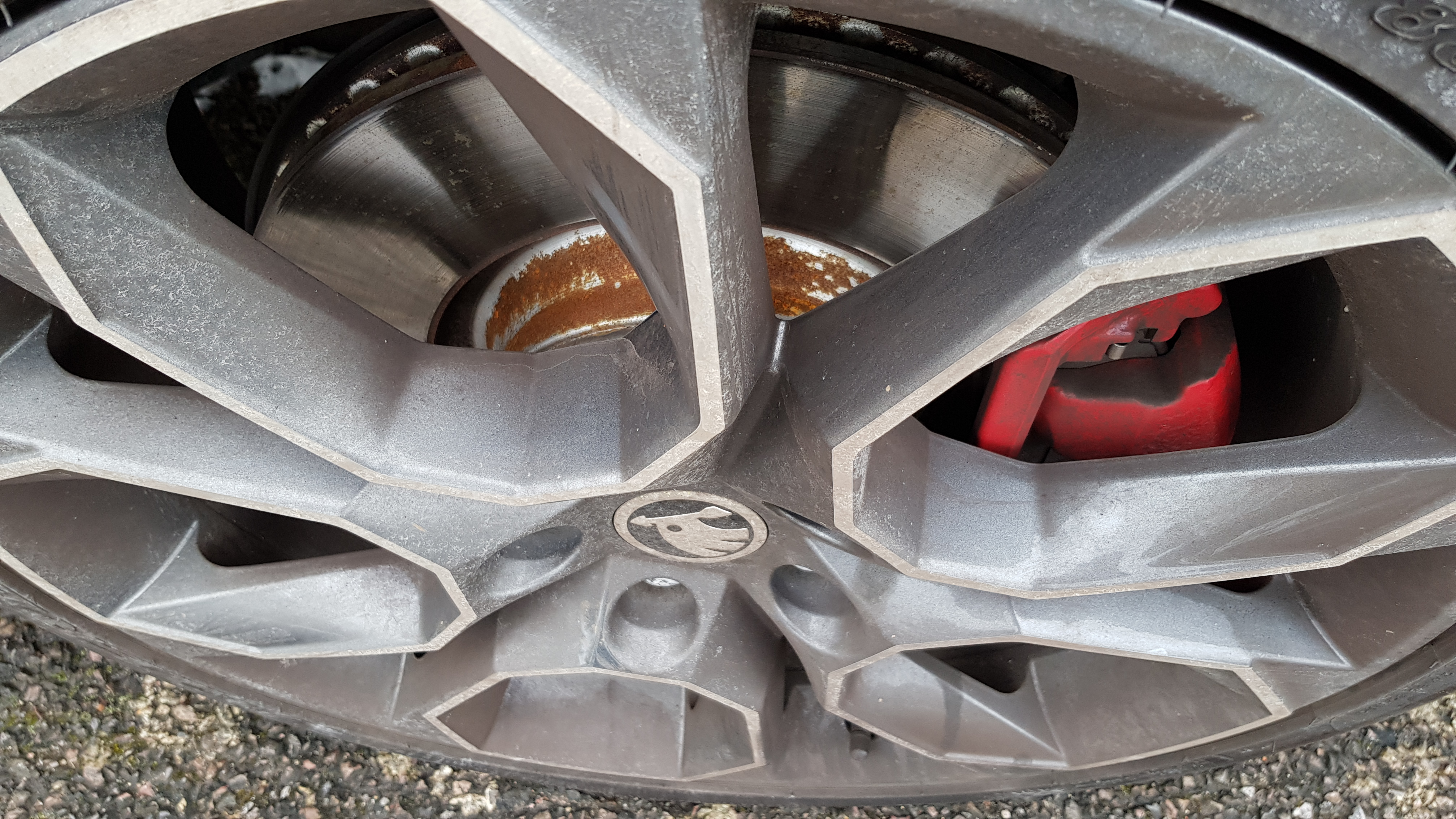

Same issue :sadsmile: All 4 hubs too. Seemed to happen within a couple of days of my Skoda dealership jet washing the car after some warranty work (as well as the wheel bolt caps being coated in a white dried soap scum)
