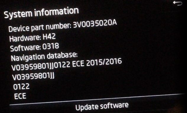

I've posted a picture of my HW & SW versions and ahead of this and if a few people don't mind I'd like to know what HW & SW version other people have + car build/reg date and if anyone else has seen this kind of problem please?
Meant to say that I saw through the search function that this kind of issue was common on Octavia but did not find anything on Superb 3.
<--- Built September 2015, delivered October 2015.
Exactly the same details as yours, 3V0035020A - H42 - 0318, except I have the ECE 2017 maps.

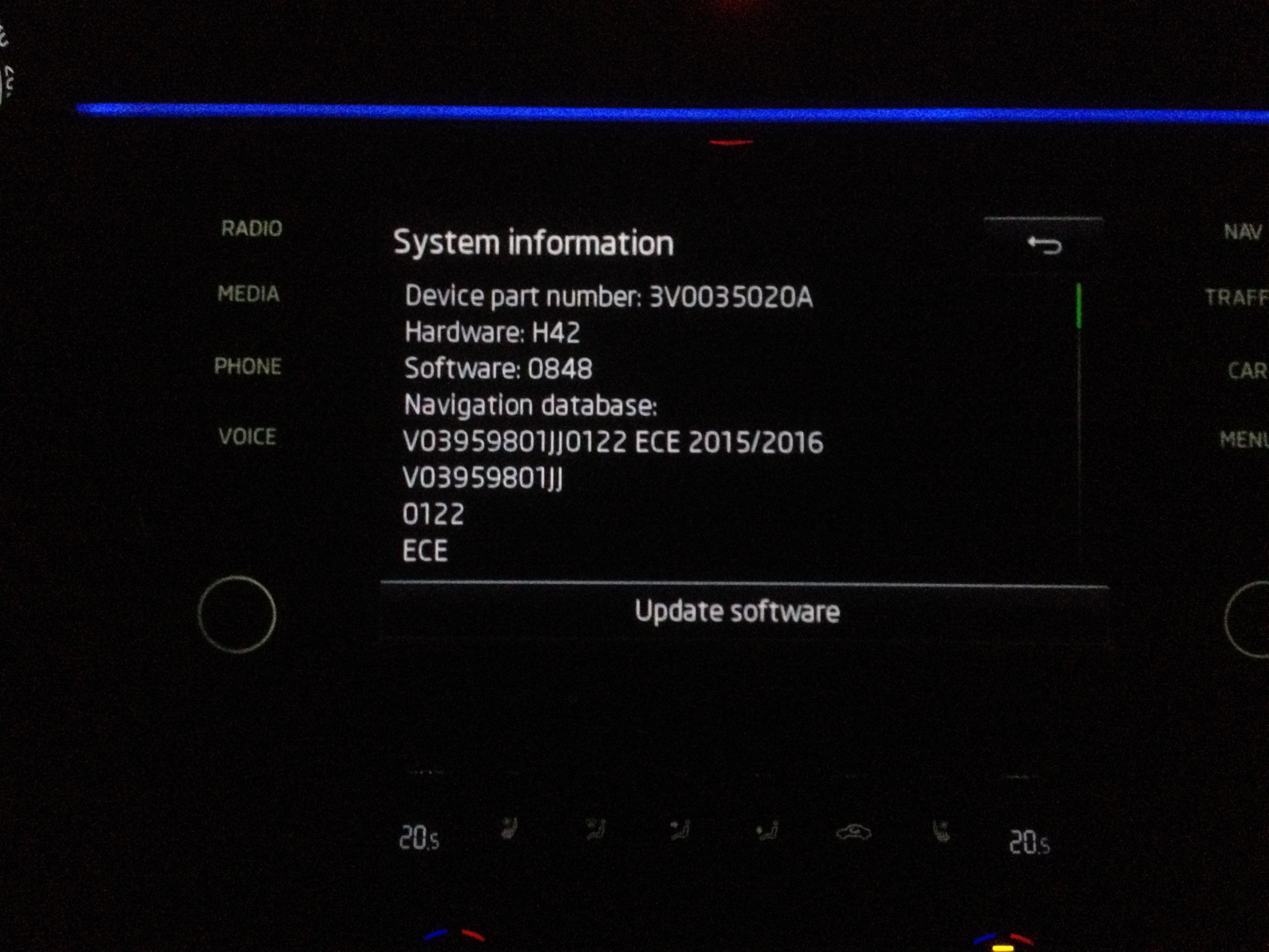

Got a call from the dealer and went in for an SW update, previously SW Version was 0318, now 0848, see photo below. Dealer said this should cure the issue and if not the the unit will be changed out, it is forecast to be -4 & -3 Deg C the next couple of mornings so will see if the SW update works.

So this morning it was -2 deg C when I managed to get myself up and out of bed, started car and screen responded well immediately, the start up may have been faster than previously, not sure - maybe I imagined it. Then went on and played with all touch screen soft buttons across all menu functions (Nav, menu, phone, media, car, etc...) and worked flawlessly. I then tried lots of different screen touching speeds and linger times on the next & last media track and car economy screens where I'd previously seen some odd problems and again all worked flawlessly. I'll keep trying for a while and post an update soon.
Does any one else have Software: 0848 version?

For me the new software version (and maybe higher temperatures) has cured my issues, not one problem since the update - I guess next winter will be the real test.

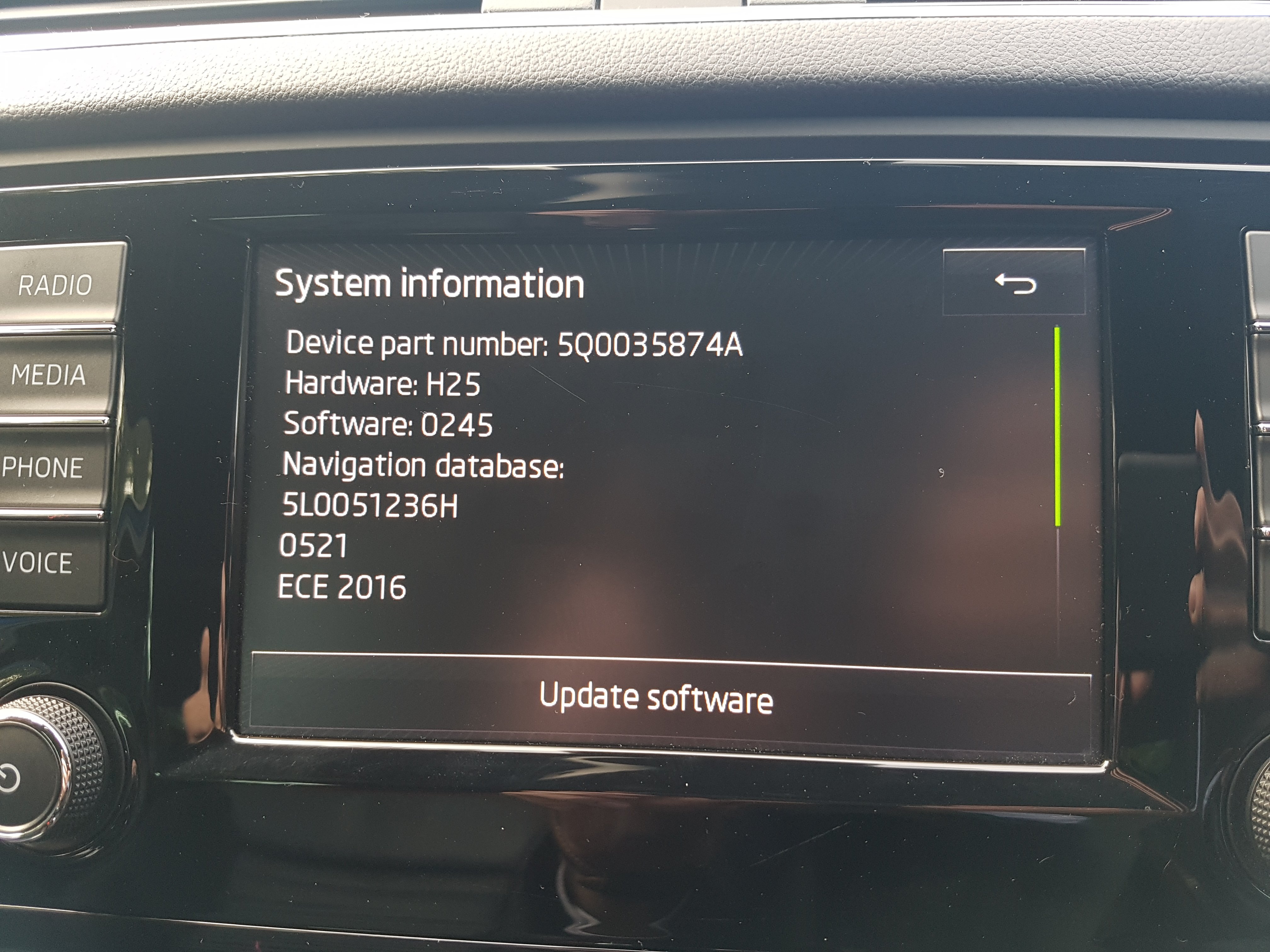

Located in UK so temperatures not yet at freezing. Car built Early 2016. No Android auto or carplay connection, just via bluetooth.
It's literally only the touch function, the display isn't "frozen" and I can still control with the steering wheel. It even recognises when I move my hand close to the screen. Sometimes switching the infotainment system off and on fixes it, sometimes it needs the ignition to be switched off and on.
Photo of system attached.
