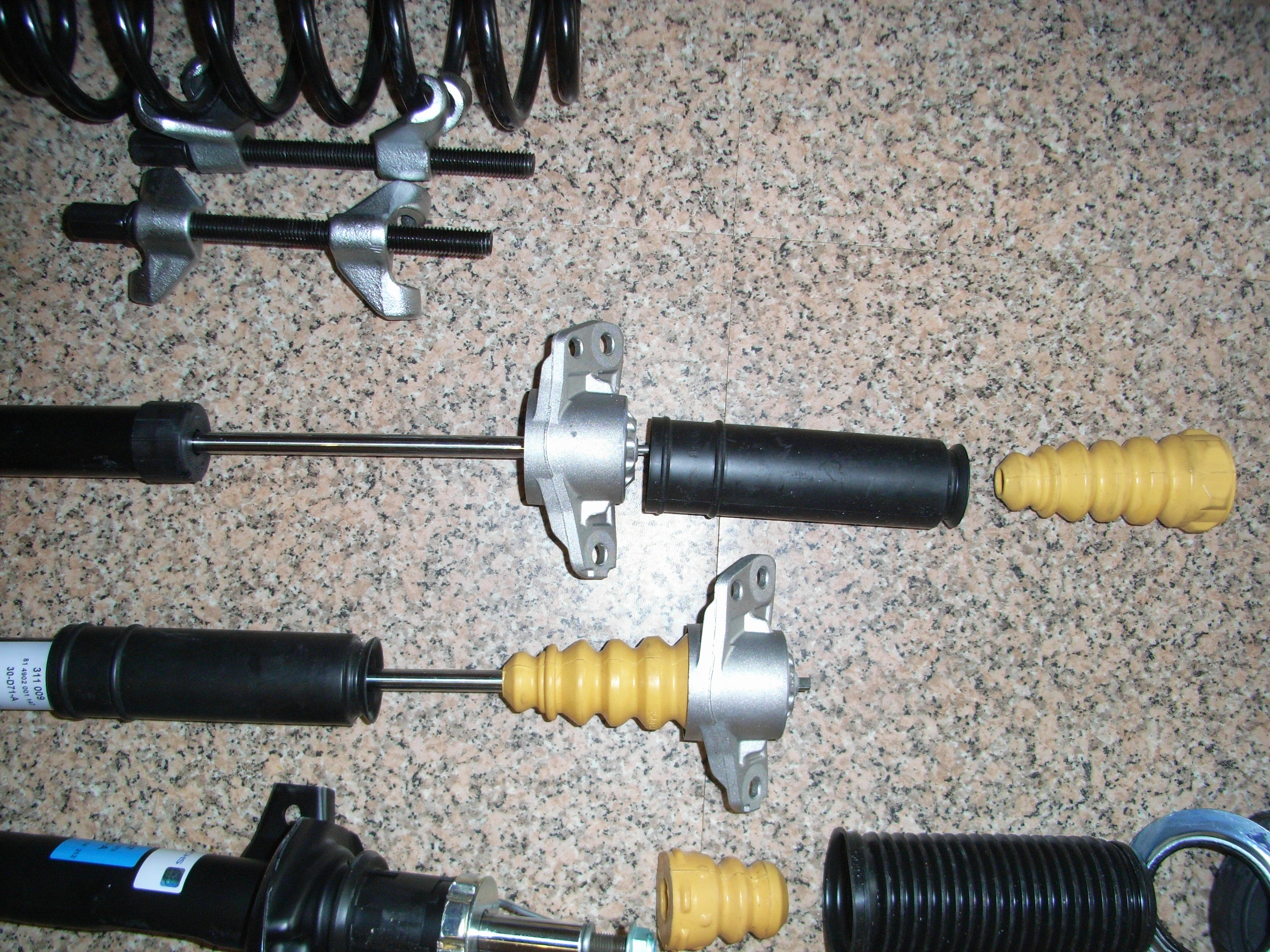

I took for the front new standart Sachs dampers in HD with the original Skoda springs and rear new stronger Lesjöfors springs HD with new standard Sachs dampers HD ( Heavy Duty means for Combi with tow hook). That´s very comfortable for our french roads and the car drives and handles not spongy.
The load is more and the Skodafederungneu 003.JPGcar didn´t dive so much.
