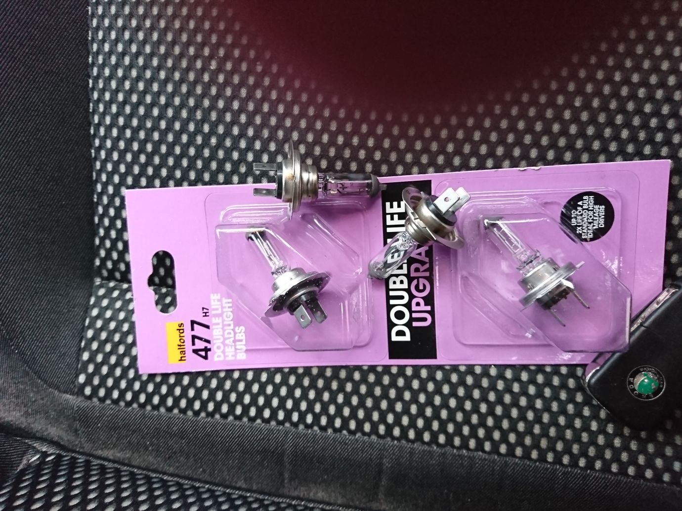

I will be doing the replacement today.
Both bulbs have gone. Hoping it's not electrical. Fuse is intact. When i put a voltage meter in where the fuse sits, I get a zero readout:blush:. But if i will have a tinker.

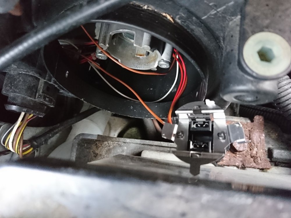

It was the H7 bulb. Got on great, it was much easier than  anticipated, removed rubber cap and it there are 2 hex screws that I thought I had to unscrew but Nope...screws were only there to slide the frame of the bulb assembly out & in :). Bacon roll to finish:biggrin:
Excellent!  Thanks for the photos.  It looks very tight for space to get your hands at the bulb - especially at the drivers side.  I'll give it a go at the weekend though...
done  mine a couple of times and the 130 are not that better like the xeon need to look in to this but replacing bulbs its a fiddle but easyish . just take rubber cap of twist the holder and it pops out unclip the wires take out of housing and refit 10 mins both sides
