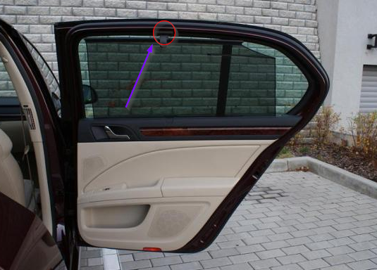

Unfortunately that's the point - from outside it's all fine, so the door seals are not leaking. The problem is still unsolved unfortunately for me, tried all the advices above and no change.
The noise seems to be coming around the upper hook / holder of the door roller blinder...but will not disappear whatever I do...eg. tried pushing that spot, cover it etc. - no change.
The only thing I can think of to try after this is squirting some soapy water around the outside of the window seal to see whether you can see the air escaping from the outside of the car to track this down further. I presume that as soon as the window is opened the noise is gone. Any sign of damage along the seal at the top of the window? Has the clip for the sun blind created a gap around the seal by any chance?

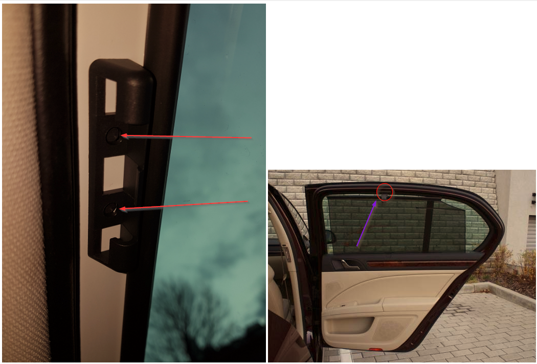

So the noise was really coming from around the upper hook / holder of the door roller blinder. There are two holes for holder and those two holes is the root cause (see arrows), the wind is coming trough them in to cabin. Not sure yet how I will fix it but for sure with some isolation.
Wind ? You said it only shows up with the car on complete stop ... or was it windy on that day ?
Sorry, I mean internal airflow not the wind from outside. It somehow come from the cabin to the doors and then back again via those holes to the cabin.
So on the open road you have no issues... ? strange indeed. I think this could be an isolated incident.
Yep, no issues on open road.
