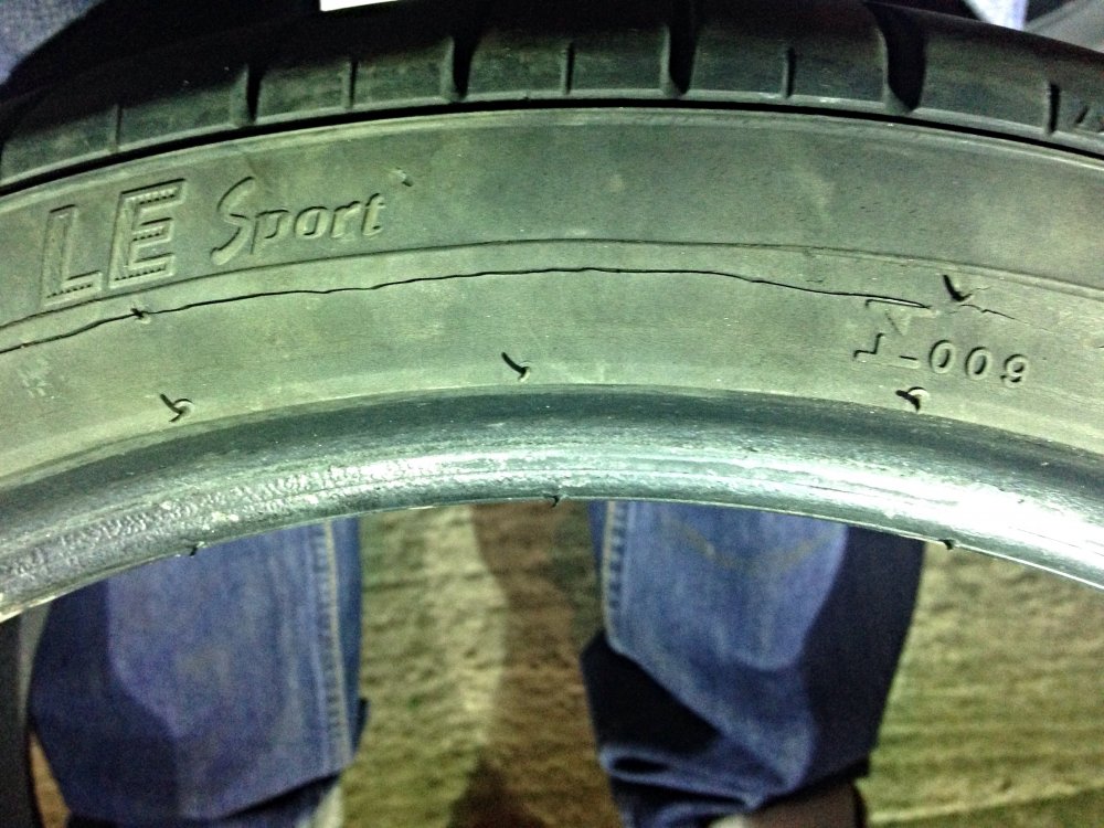

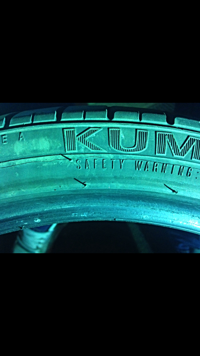

Guys,
Fitted 4 of these to a colleague's Golf GTE on 1st December. Changed back to summers today as he wasn't happy with grip, and had a few moments; went to tyre centre to collect the car and they had discovered all four have badly cracked sidewalls :blink::blink:
He's done 13,000 miles since they were fitted (yes, that's over 1k miles a week) but they still have 6mm left as measured by the tyre place, so at least they wear well!
The pressures have been a consistent 35psi so not under-inflated, TPMS has not given any warnings etc.
Just a head's up - it's hard to see cracks when fully inflated, so it wasn't obvious when checking visually.
Tyre place are filing a claim with the suppliers, so expecting a full refund.
Worrying...

I have bought Khumo's before, not the winter version but had the same experience of wall cracks after just a few thousand miles.
Wont use them again, which is a shame as I rated them for a cheap-ish tyre.
Wow.
I had Kumho summer tyres on my wife's VW Up! from new, never had any issues over 4 years, and like you, I thought they were pretty good for the money.
That crack went 3/4's around the tyre :o and was after no more 6k miles. I took all four off :(
I had a set of these on my Octavia estate; they were like this on the sidewall and in between the tread. They opened up quite deep when pulled apart. I ended up replacing them at ~3.5mm and 9mths. Had done ~9000miles
