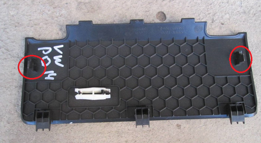

This page suggests a part number of 6RU857506B for the cover, and google images shows one like this below. It looks to have a push-fit fitting at each side (ringed in red), near the bottom corners. Maybe focus on trying to pull those out one at a time?

Just pull it... :D
I found this too on my 13 reg rapid it does come off with a tough pull
22 hours ago, 67igor1 said:
Just pull it... :D
Is very tight the first time off. You won't break anything.
