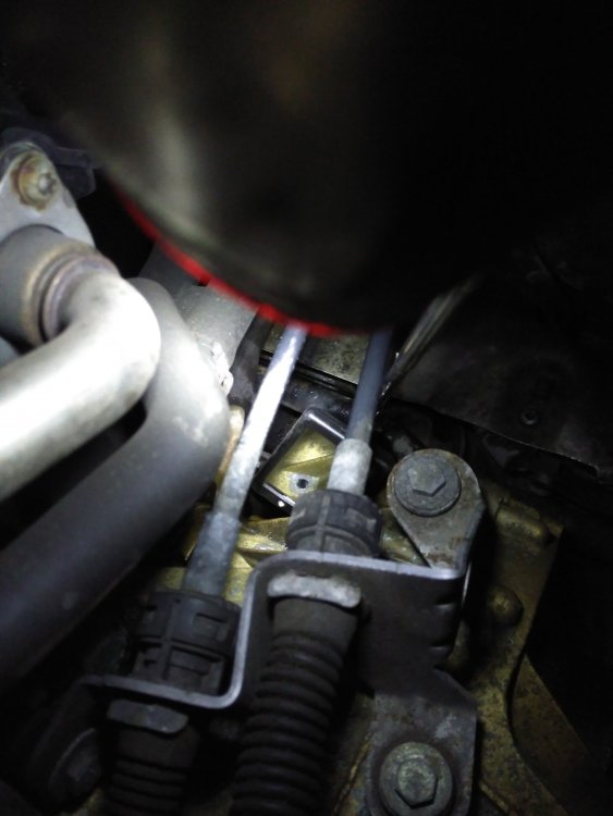

My local garage has looked over the car today and told me there is a hole in the gear box. The smell was due to oil coming out and hitting the exhaust.
The garage has said to either find a secondhand gearbox or go to a transmission specialist and have a reconditioned boxed fitting. This could cost anything up to £1200 all in.I cant believe this has happened and seems it is just bad luck.

Also does it look like this is the problem?
I have put some photos below.
One photo shows the hole, which looks to be at the top of the casing. You can see this in the mirror.

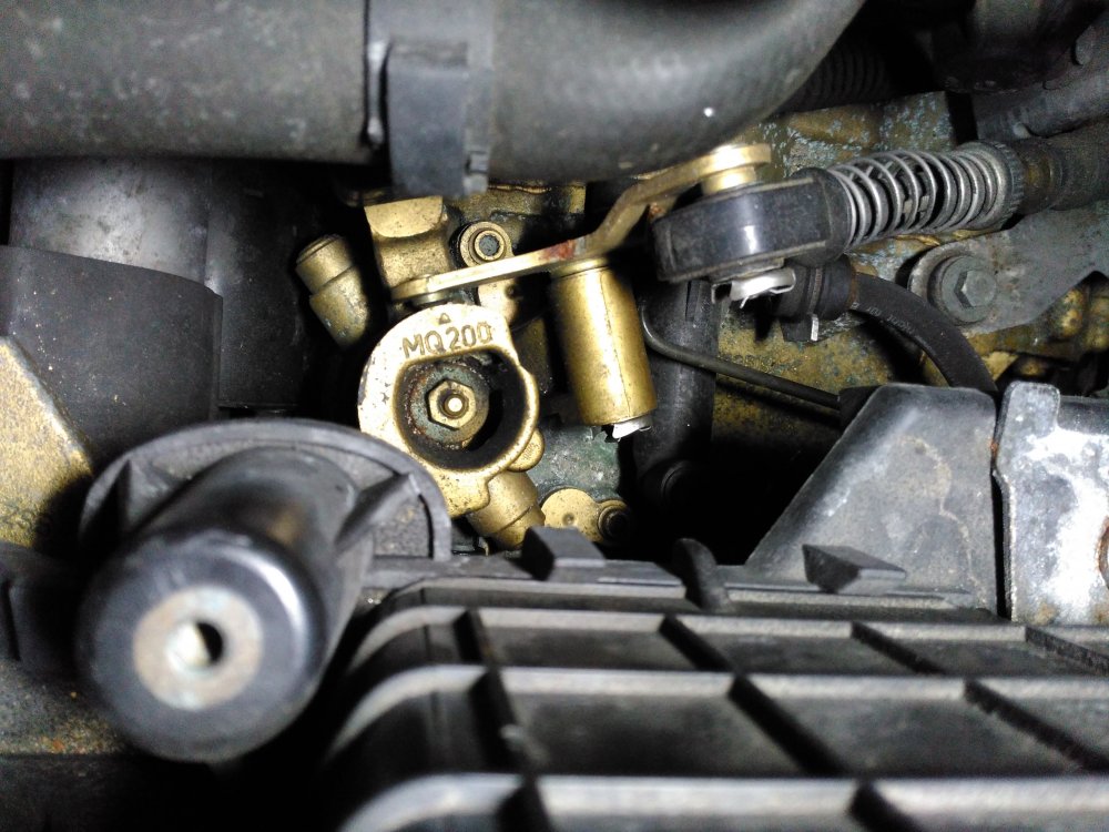

The other photo shows that the gearbox is a MQ200.
By the way are original gearboxes gold in colour, my garage said that looked strange and could the car already had a recon box put on in the past?

If it were me, I might try a bodge repair before spending money on a replacement gearbox.
My answer would be to get some chemical metal putty,plug hole with it ,screw in a suitable sized self tapping screw.
It's the sort of hole that supports a screw, maybe it did,when original,even maybe some sort of tag, should it be a replacement.
For the sake of few pounds, Me a bit of bothering,I would try a bodge first, you might even try some molten lead.
The gear box housing is made of alloy that is cast in a resin-bonded sand mould.  When this is done badly, the result can be cavities called 'blow holes' which is just what this looks like.
You could try taking it to a specialist welding shop that can handle alloy welding and see what they would quote to weld it up. Might be cheaper than a new box.
I thought about that, but the mechanic found a short metal pin, almost looks like parts other gears, sitting the in the engine bay. He thinks something must have given way inside.
Also did Skoda VAG ever make the gearbox casing gold?
Just seems a bit odd as all the second hand ones on eBay are metal colour.
Edited by raf300
Never seen a gold gearbox so must have had a recon box fitted at some point.
If the gearbox is working fine and there are no funny noises I would be tempted to repair the hole/block it up and do a couple of gearoil changes a few hundred miles apart to get rid of any metal contaminants.
I wonder if it's been patched up at some time, then painted to cover up the patches.
Id say thats had a reconditioned box fitted,if something had broken inside & exited the gearbox casing id have expected a lot more damage & you may have driveability issues & noises,if the car still drives ok with no noises from the box then id do as others have said & try to repair that small hole & drain & refill the box with new oil & drive the car & see what happens.
thread the hole and use thread lock on the screw used to fill the hole.
Looks like there was a screw there fore some reason.

Car has covered 86,000 miles, 2006. I have found a transmission specialist that can pick up the part, inspect it then decide if it is repairable or needs a full rebuild.

Gearbox needed a full rebuild. I can't remember exactly what the transmission said, but something along the lines of a cog or disc was floating around, plus a pin had pierced throughth casing. A repair was not feasible. The specialist were great, they picked up and rebuilt then sent gearbox back to my local mechanic.
