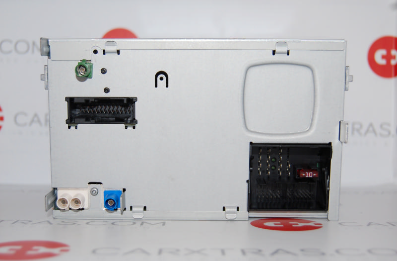

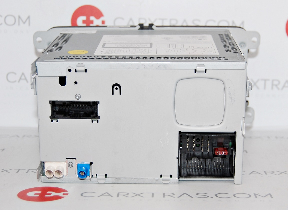

No, not exactly that simple.
Your radio might not have had the DAB option checked when it was originally built. The only way to check is to remove the radio and check its connectors at the back.
Picture of radio without DAB
Picture of radio with DAB
If your radio has the green connector at the top the yes just buy a windscreen DAB aerial from autoleads / halfords and your go to go!
Edited by JGrindel
Added 1 too many images.
Green connector is North American model. The UK model will have a black connector instead.
Ta! :) I just grabbed images off of google!
